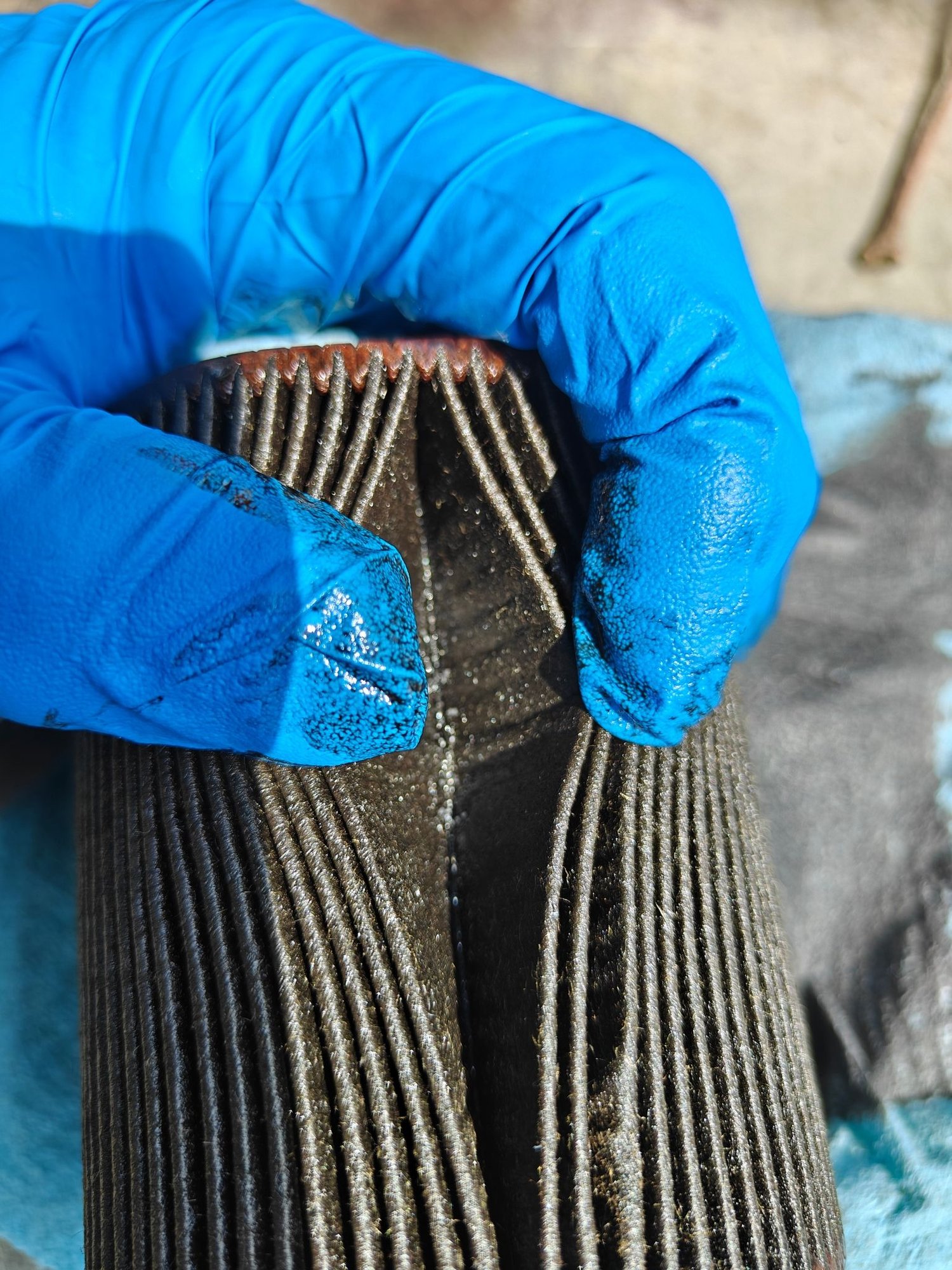

125K oil change found some metal and carbon flakes........
Time to go to 5w-40, if it makes it another year, I'll be happy.

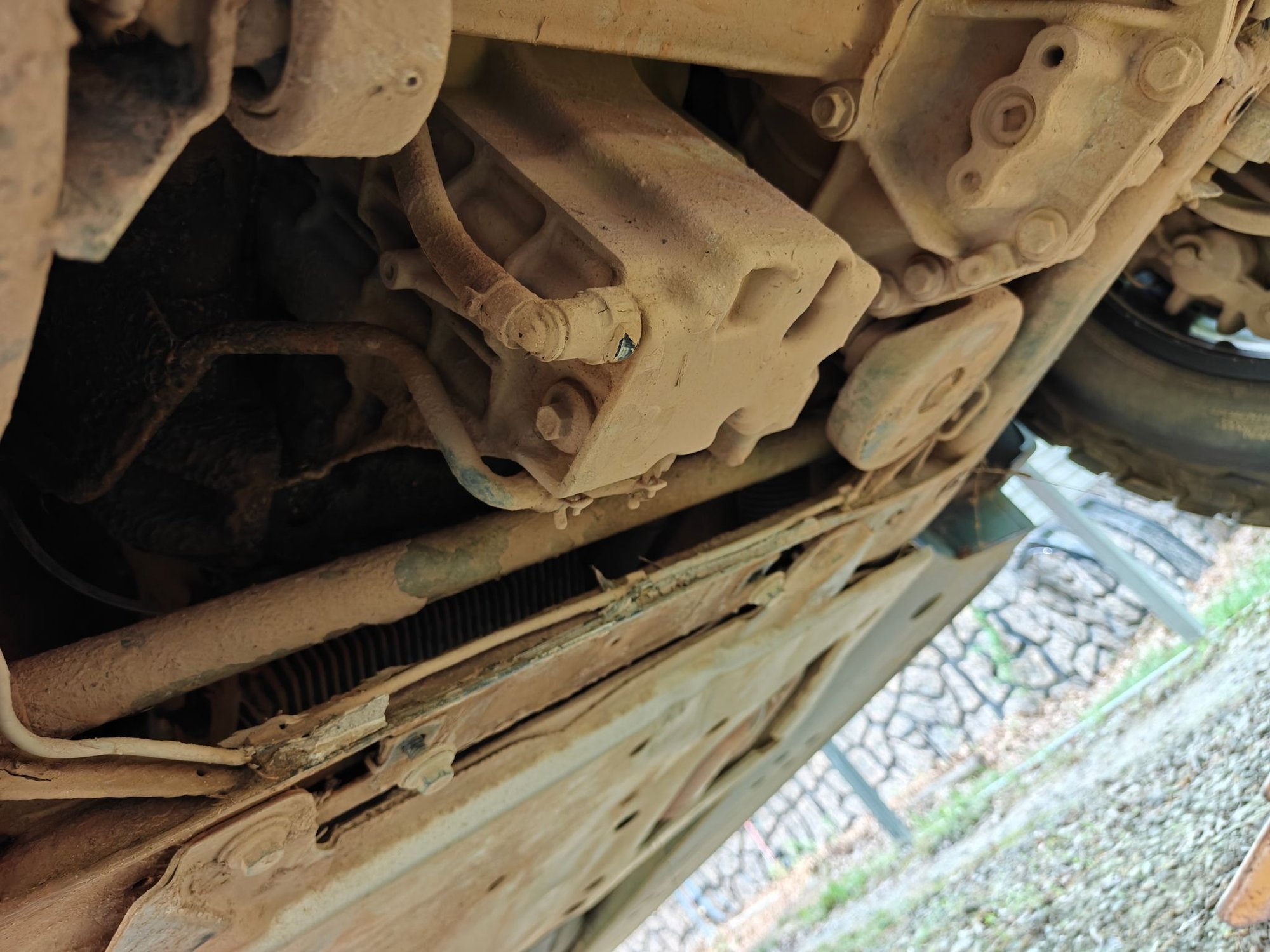

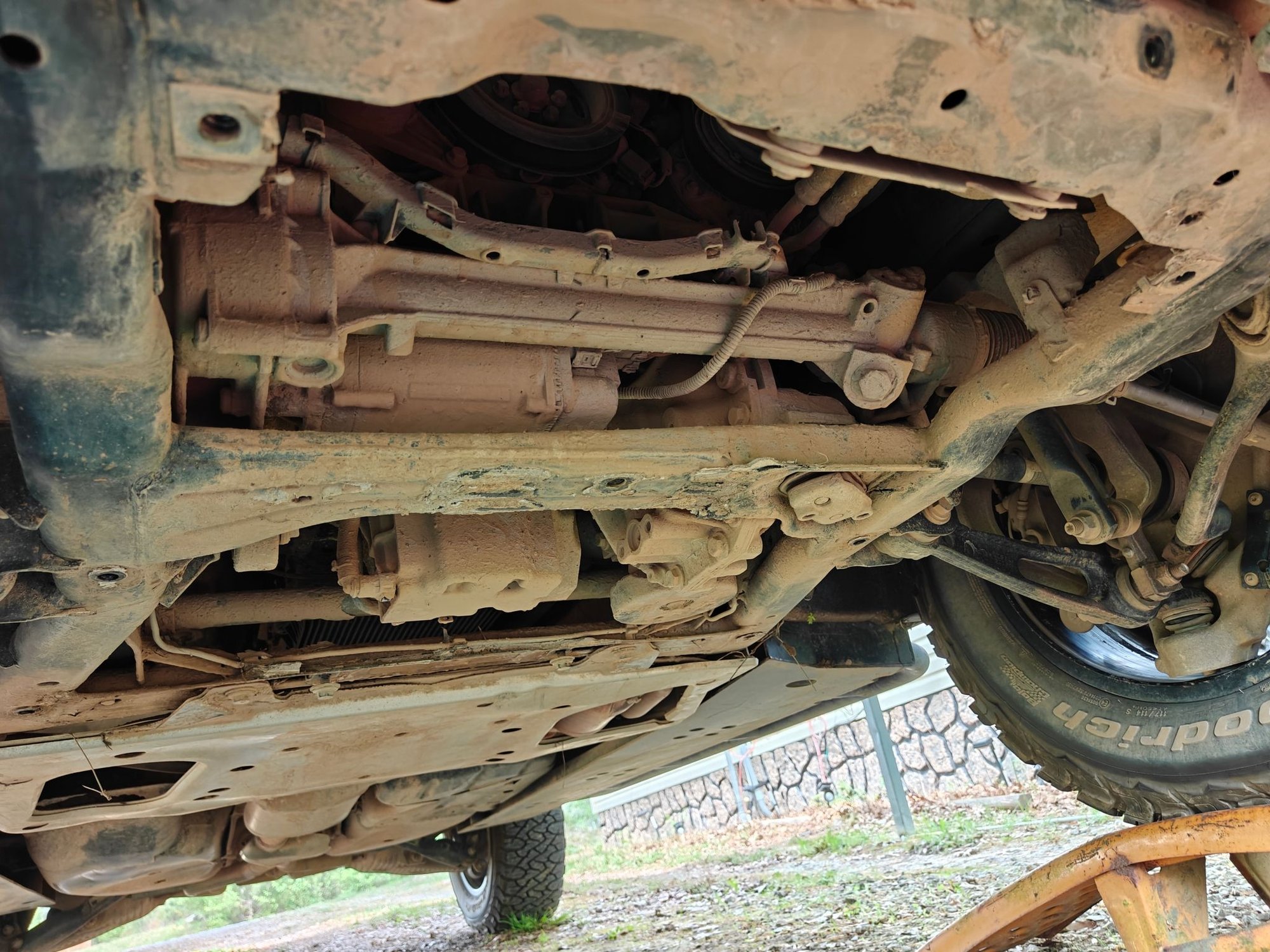

no leaks
no leaks
no leaks
no leaks

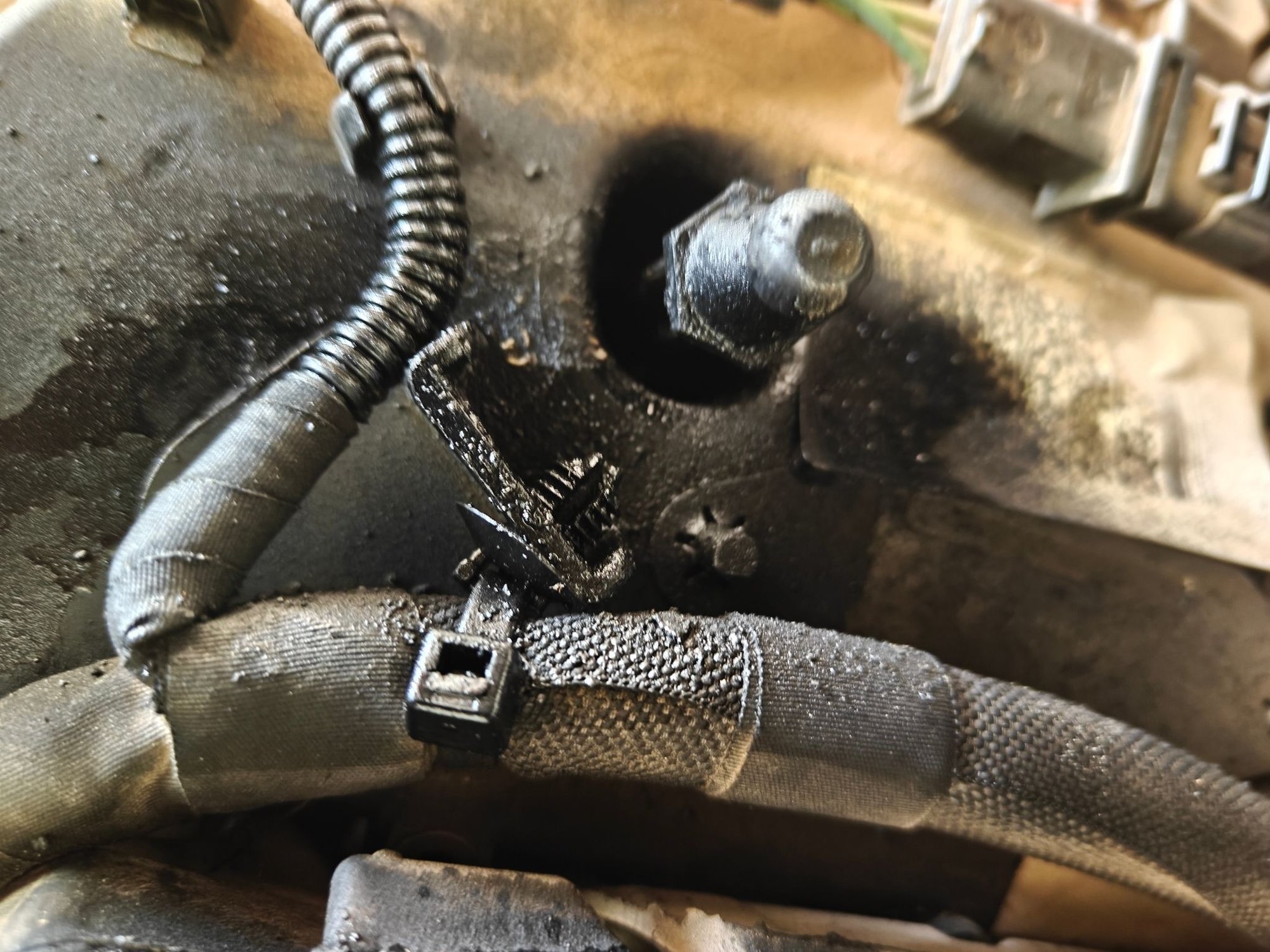

residue coming out of lh valve cover?

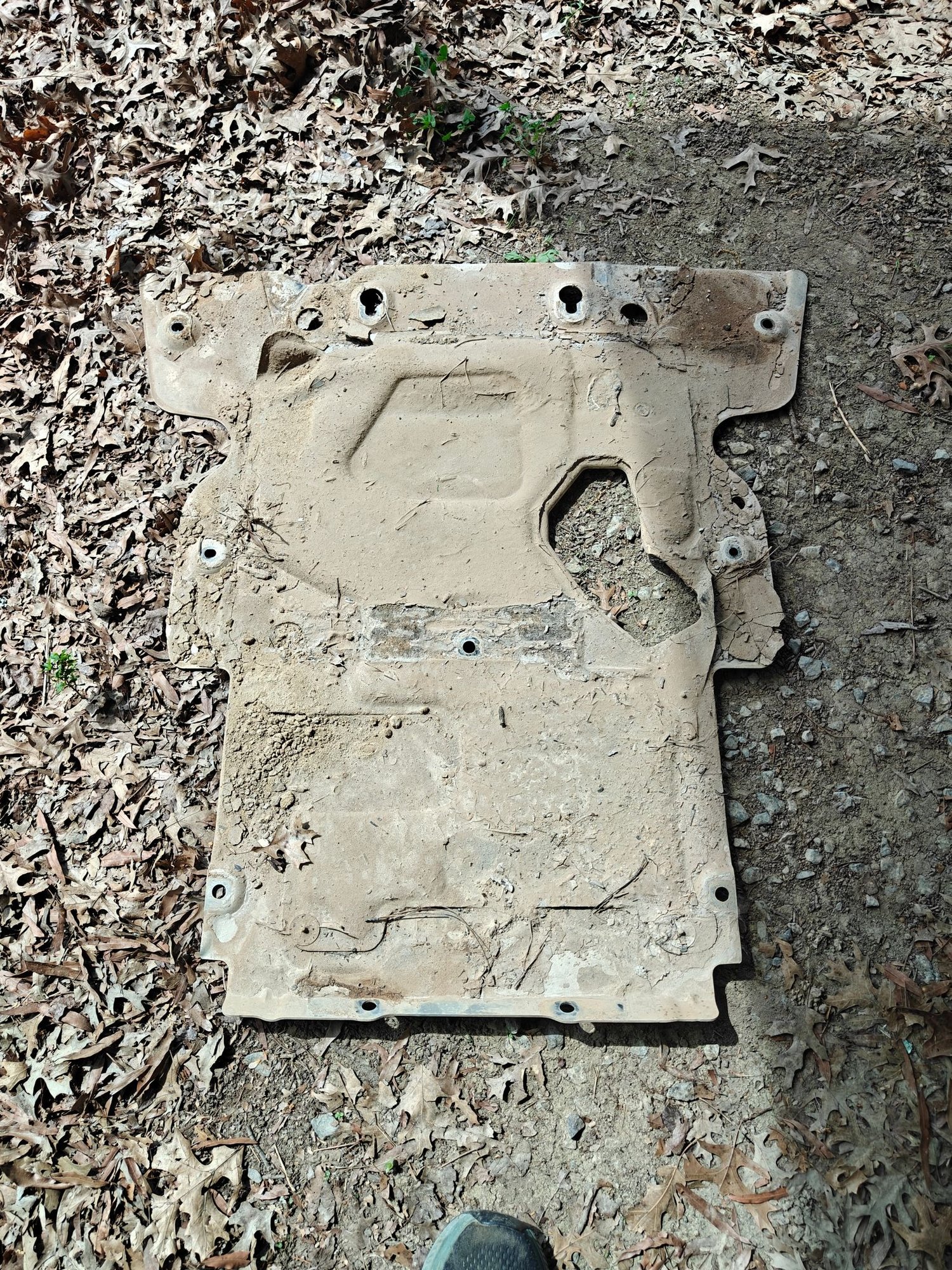

mud/sand from GARR
mud/sand from GARR
cleaned
cleaned

Update: I changed the oil again with 1K miles. None of the debris was magnetic, I believe its carbon deposits stemming from the stuck closed egr valve P048A-73
I'm going to clean the intake more frequently, try to minimize the particle build up for now...
