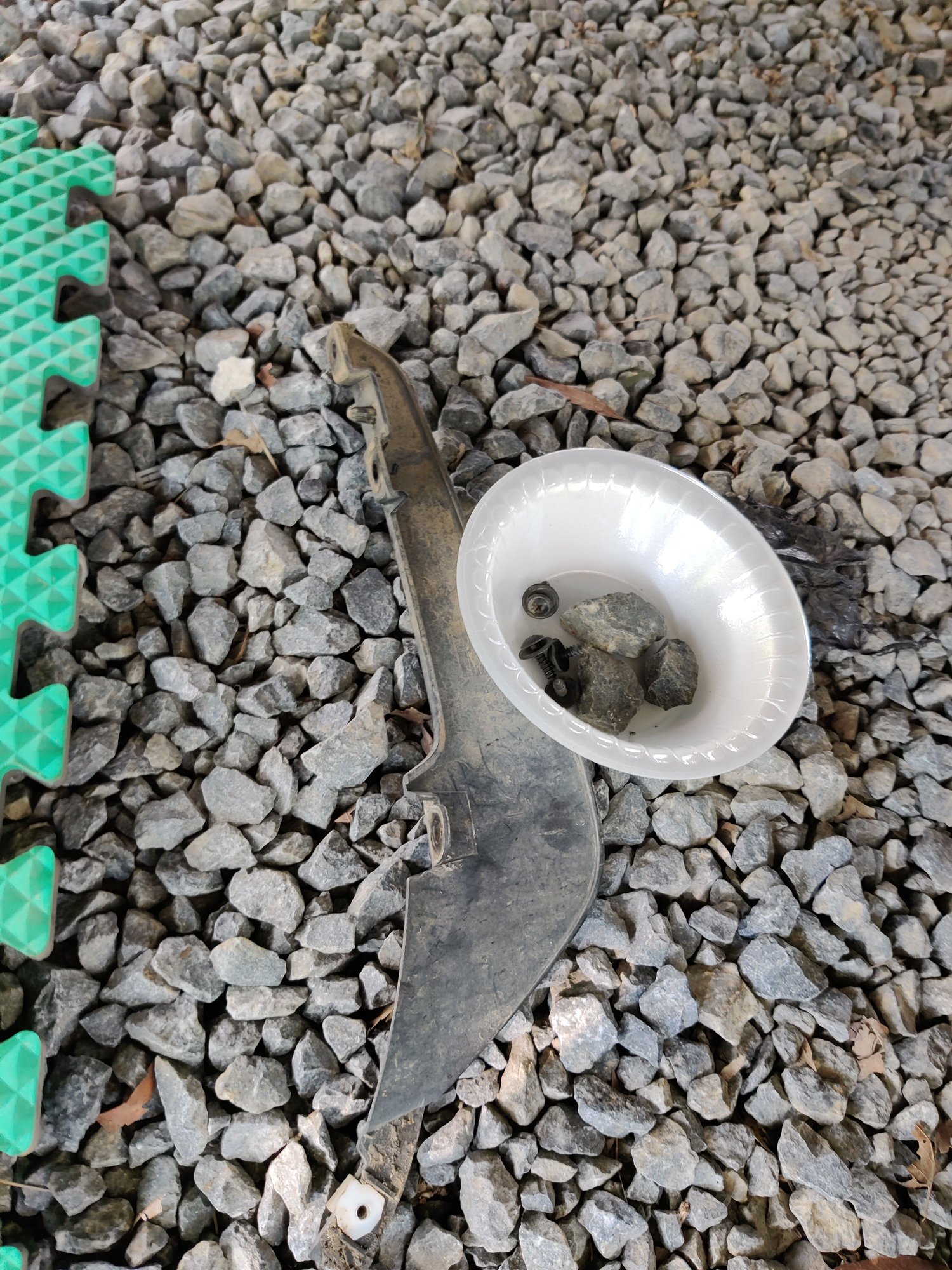

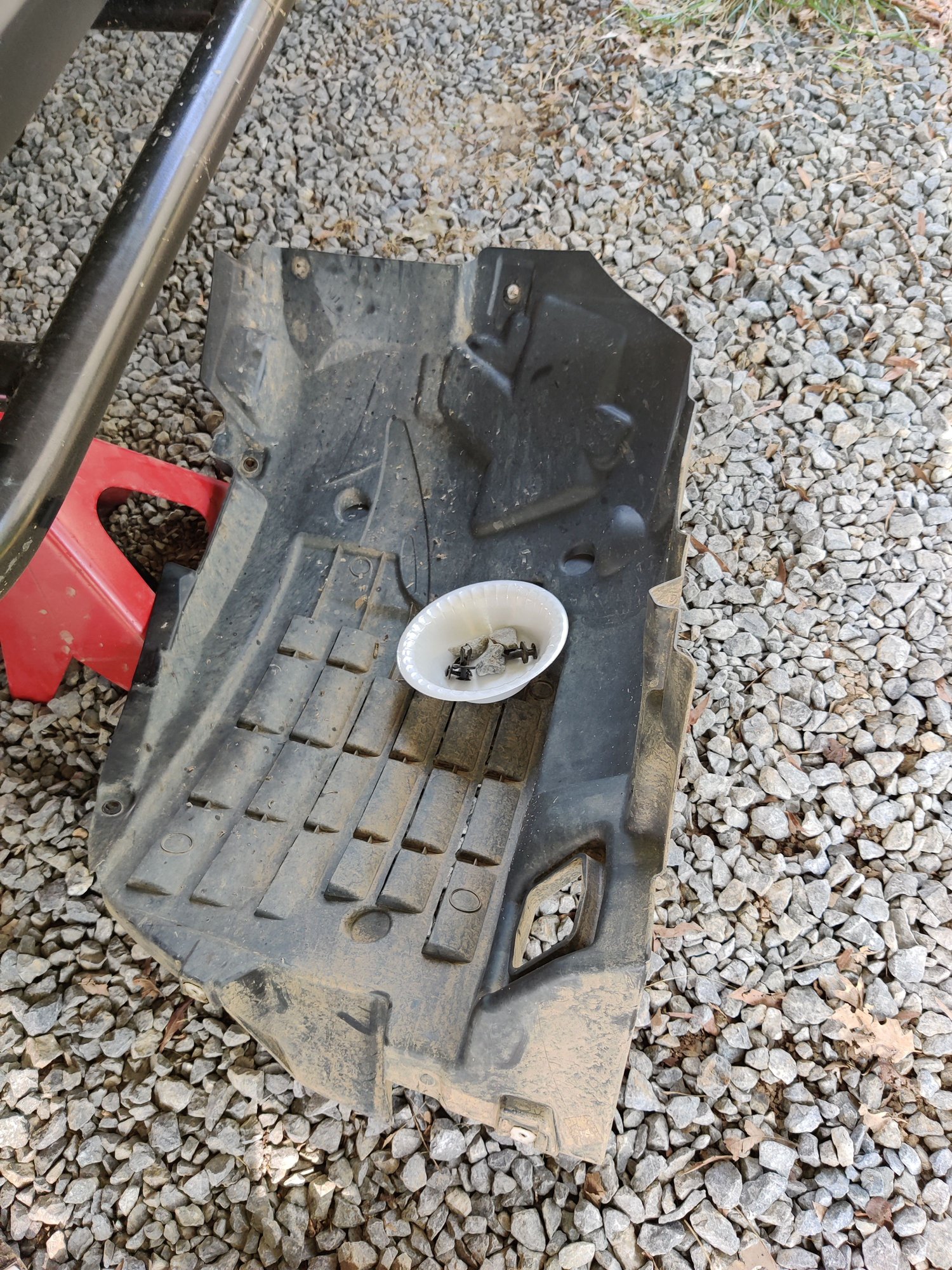

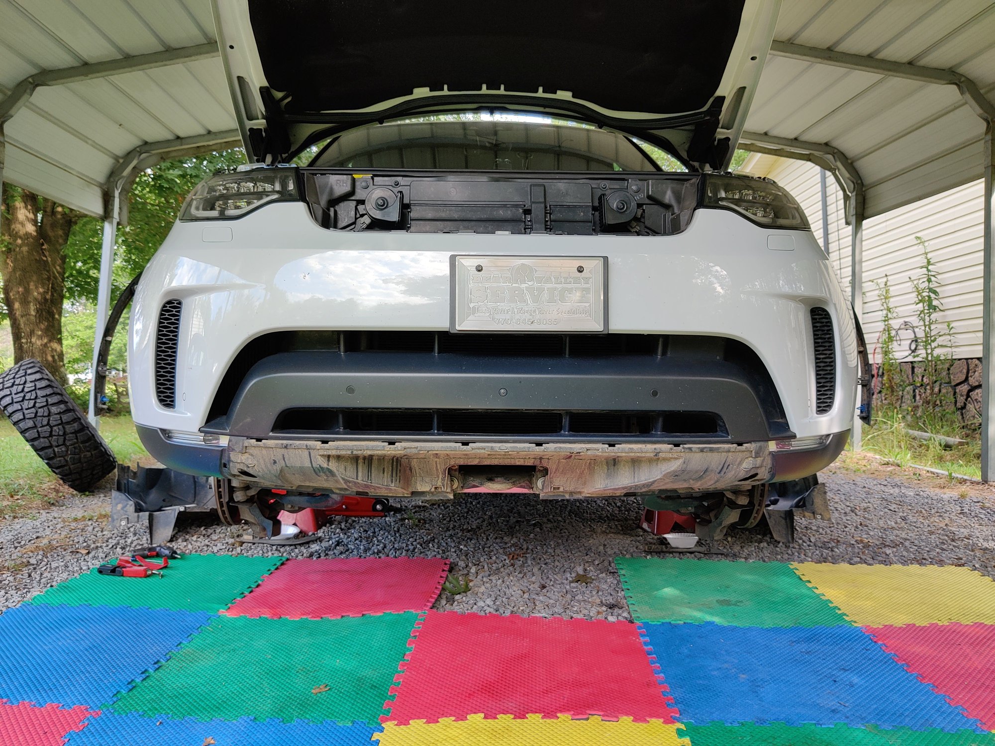

Well I have been disappointed. After ripping most of the front of my D5 apart, I go and get to the point where I dry fit the Lucky8 winch plate, and it doesn't line up. So of course Friday July 3rd for the most part was a holiday observed for most US business. So I had to wait til Monday to contact Lucky8. I called and was told I would get a call back. So 4 hours later, I called back. I was told they made some plates wrong. That they would send me a replacement in three weeks. Something fishy is going on in my opinion. But now my truck completely tore apart, Now it has to sit there tore apart for 3 weeks. Needless to say I'm not happy. With that being said, I'm going to post up the pics and things I've done so far.
Here is my set-up. I'm on 6 ton jack Stands with rear wheels chocked. Both front tires removed.
Driver Side inner fender removed repeat for passenger side too.
Driver side small mud flap removed.repeat for passenger side too.
Driver side. Pry wheel well molding loose, pull away from wheel opening slightly. Remove parking sensor font molding. repeat for passenger side too. this side has 2 power plugs. unplug them. ( the passenger side only the washer hoses need to be unplugged.)
Now remove the Grill. Also remove the tow eye cover.

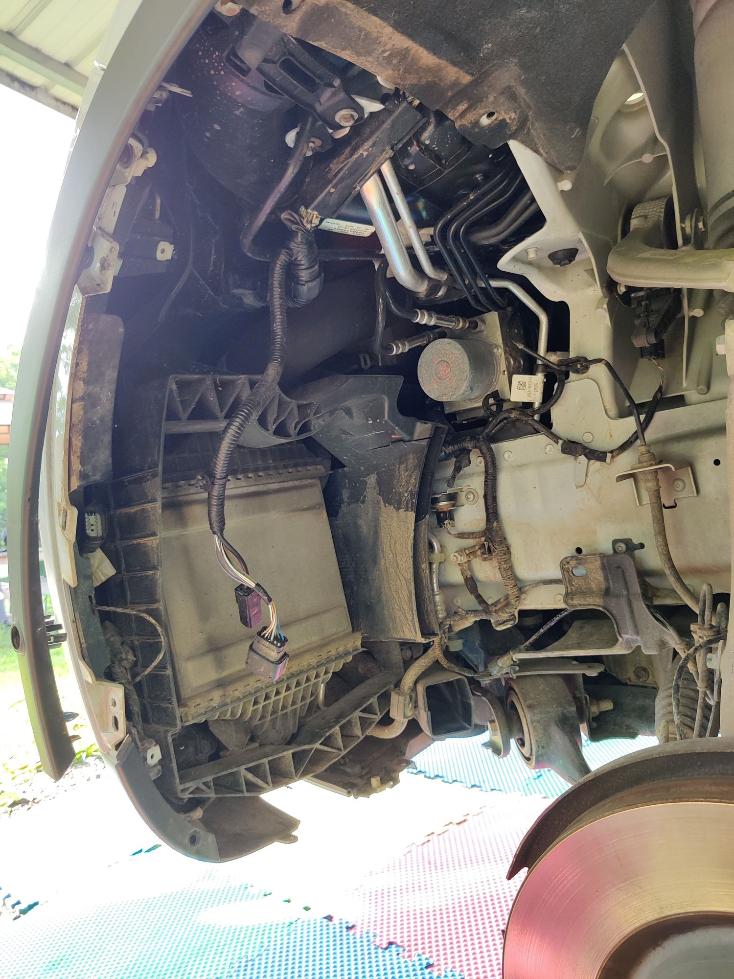

Remove all the screws for the nose. 4 up top, 6 down low, and 3 in each fender well. I thought there were going to be more connections to unplug, so I used a cooler to be able to support the nose. But it was really not needed. Its not heavy. But be aware this is a HSE LUX TD6 version, the gasser may be different.
Here is right after the nose removed. At this point, remove the brake ducts, the lower scoop, the upper scoop, the Radar unit and on the left the other plastic scoop.

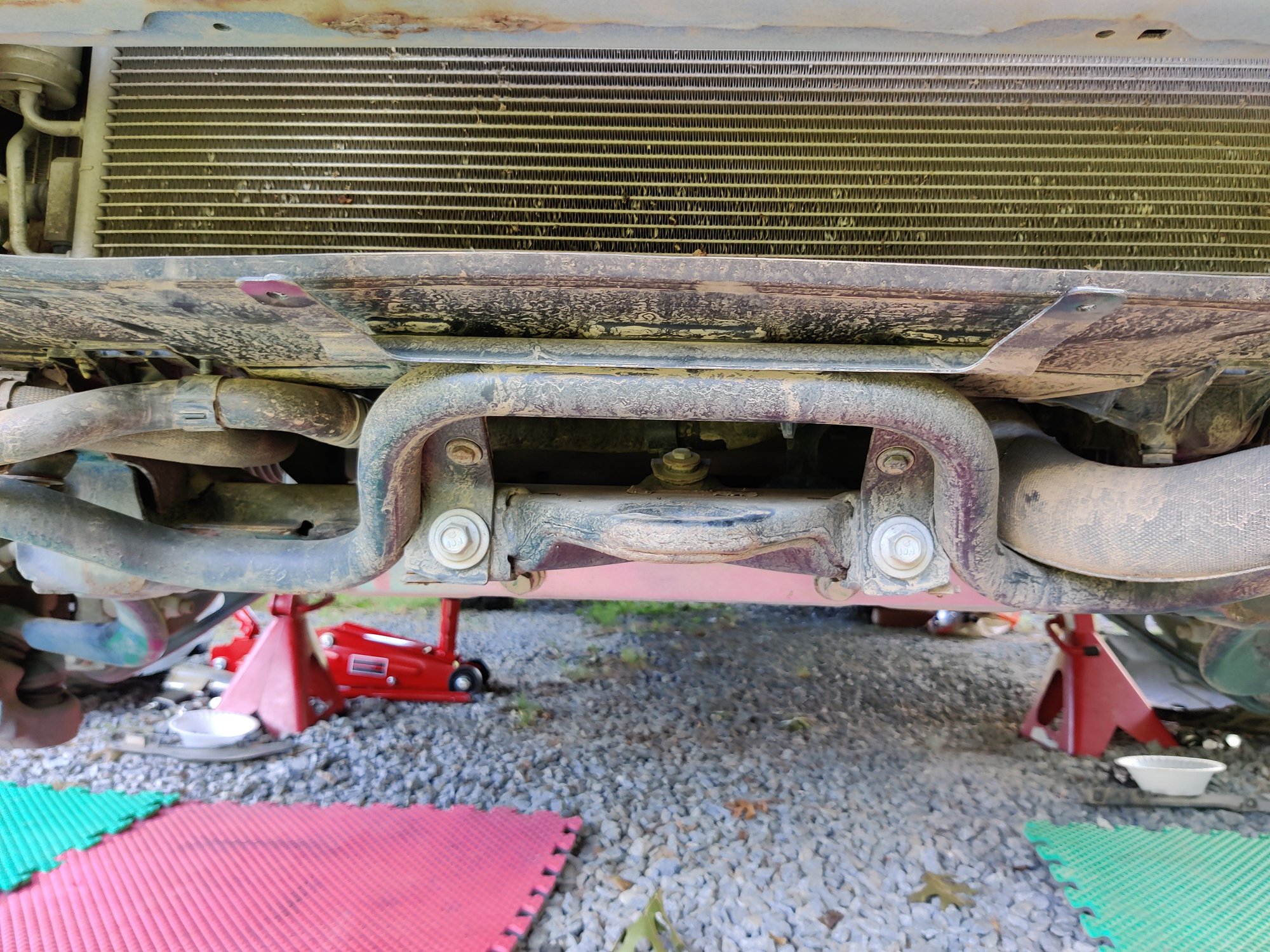

Now remove the cross bar support. 4 bolts.
Here is the point where it all went to crap. So I put one bolt in the driver side, and went to put the other bolt in and this is what I got. I measure just over 1 inch off the centerline. Also it is squashing a coolant line. Also the lower winch mounting hole don't line up either.
So now I have to wait 3 week with my truck tore apart. I will continue my how to at that point. Very disappointed.
