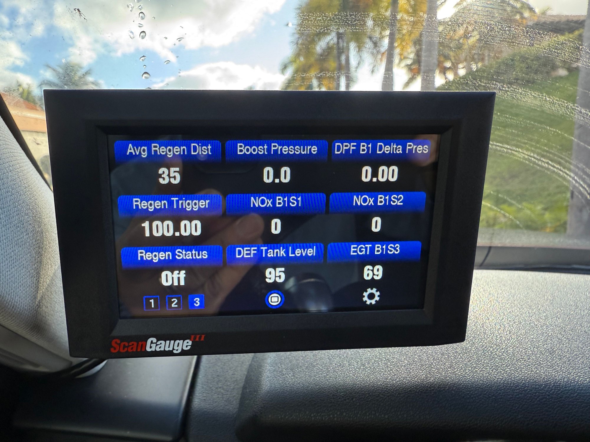

As soon as I receive the scanner I will check. Needs to check under a specific condition (idle, load, etc)?
It changes depending conditions/load. I'm not saying it's going to tell you much, but may have insight to what the EGR demands vs actual. My diesel is consistently 2% off commanded vs actual

Long run, highway and cross country no CEL. Just… regen active as usual but the counter still at 100%. Will check with tomorrow run!
Also feel smoother when turbo kicks.
What counter are you describing?
Regen Trigger (%) counter. After the regen completion that number goes close to 0-1%.

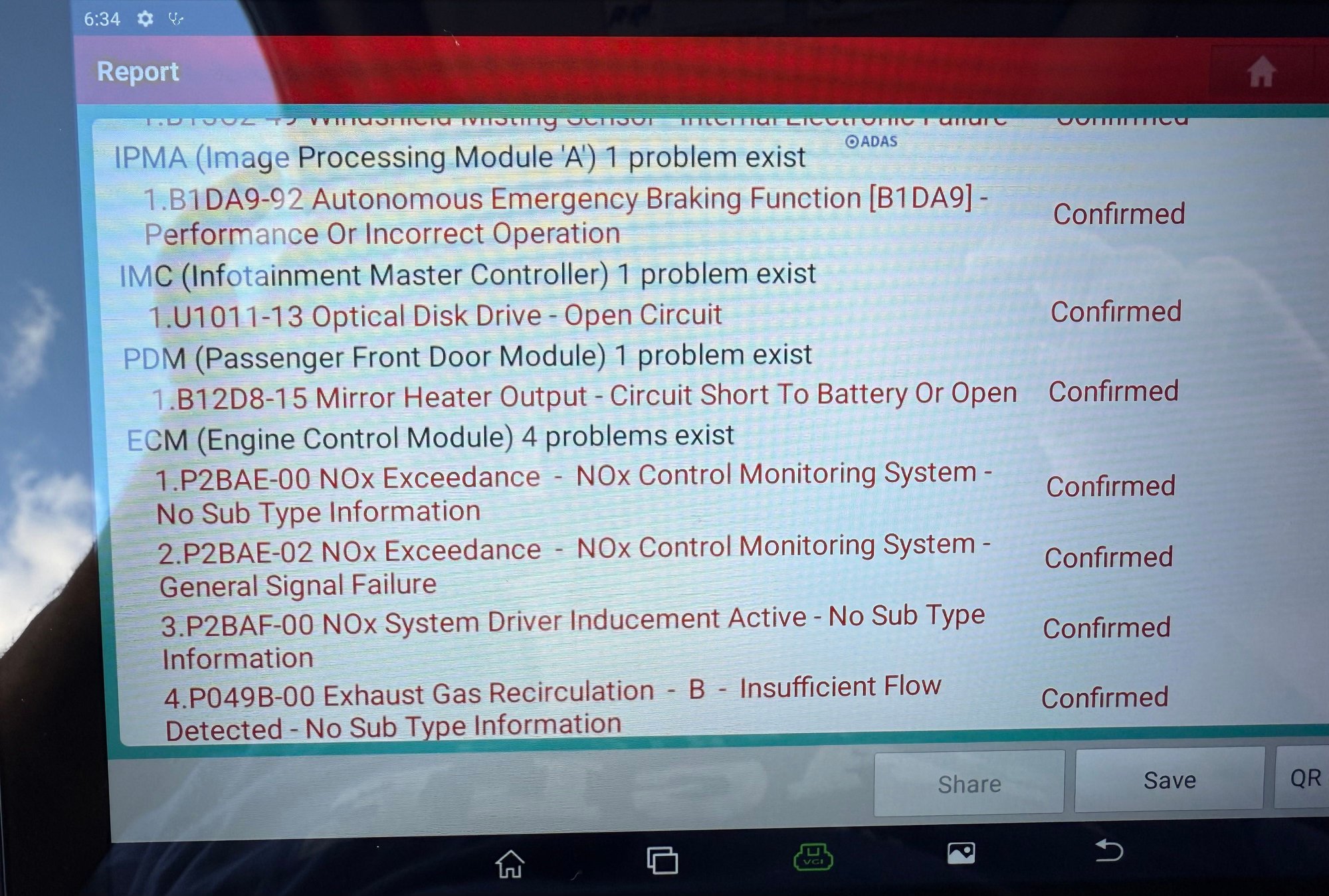

Yes. By a certified Land Rover Indy. Even 2 software upgrades to the DPF system. So far, the EGR cleaning is the only item left.

EGR B is item # 2?

Originally Posted by Xattica
EGR B is item # 2?
Anyone? I see some refurbished one at
good price from UK.
Regen is back OK after several long runs.
