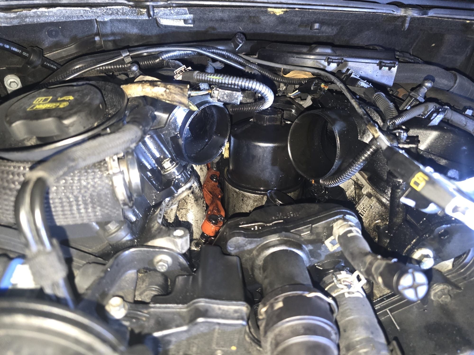

Was cleaned during the DPF issue/replacement. Can be due to damage throttle during a passive regen? I think that was the trigger.
Tomorrow will be the TB replacement and manifold and line cleaning.

Cleaned
Cleaned

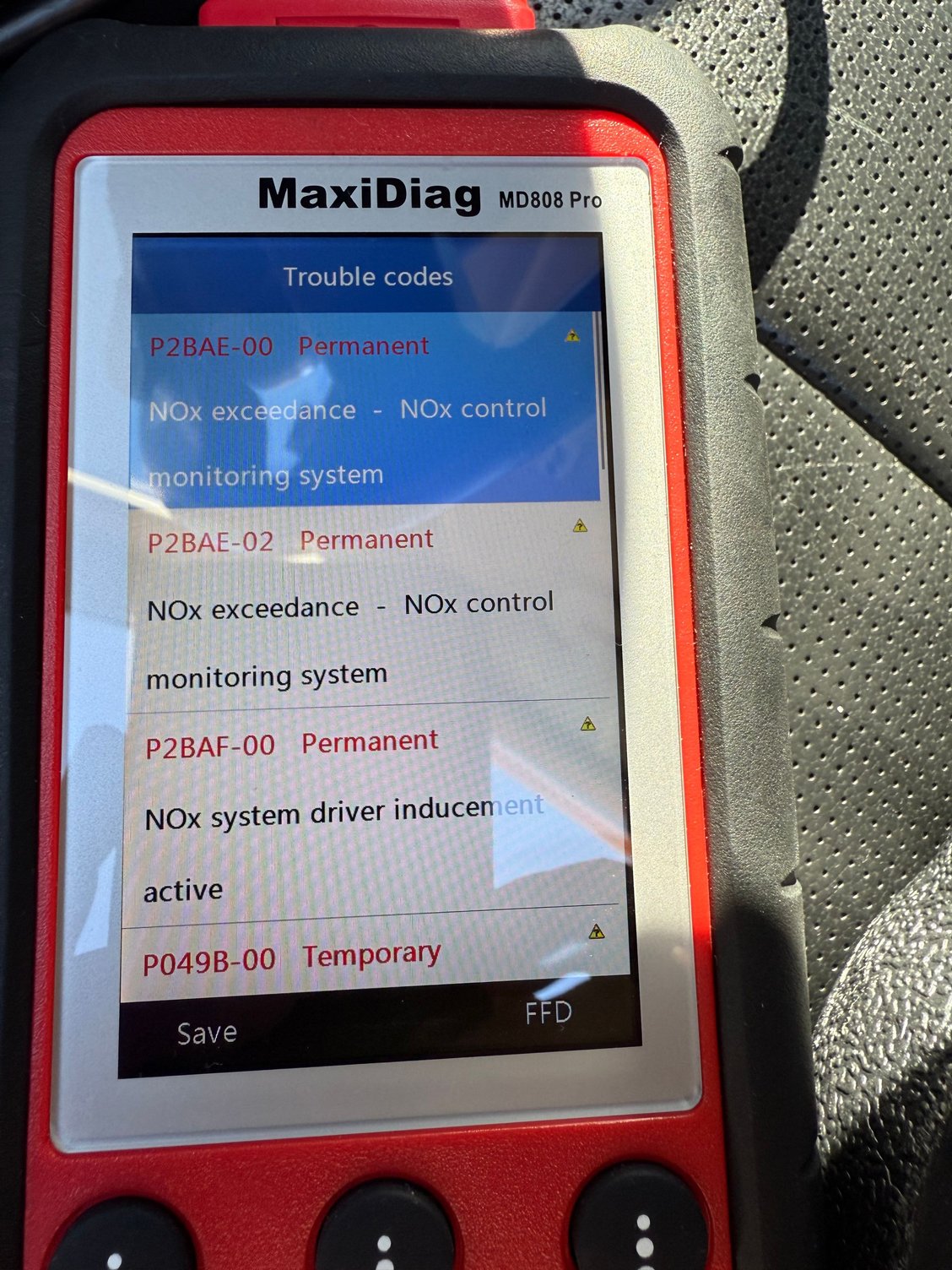

No CEL, current msg, from quality to dosing malfunction.
Codes related
Codes related
im waiting for the new Launch scanner. This one don’t clear the codes. I will go out for a regen to see if erase the message.
Update:
Even though the code weren’t cleared, after 50 miles, including a full regen and various passive ones; the code gone while driving. So far no CEL no issues,
i understand the throttle were not “married” with a good scanner, can be done again? Can I redo the Throttle Body Actuator replacement/reset?

So everything is finally looking good? What an ordeal.
I don't see why you couldn't do the throttle body re-learn after the fact once you have a tool that supports the function.
