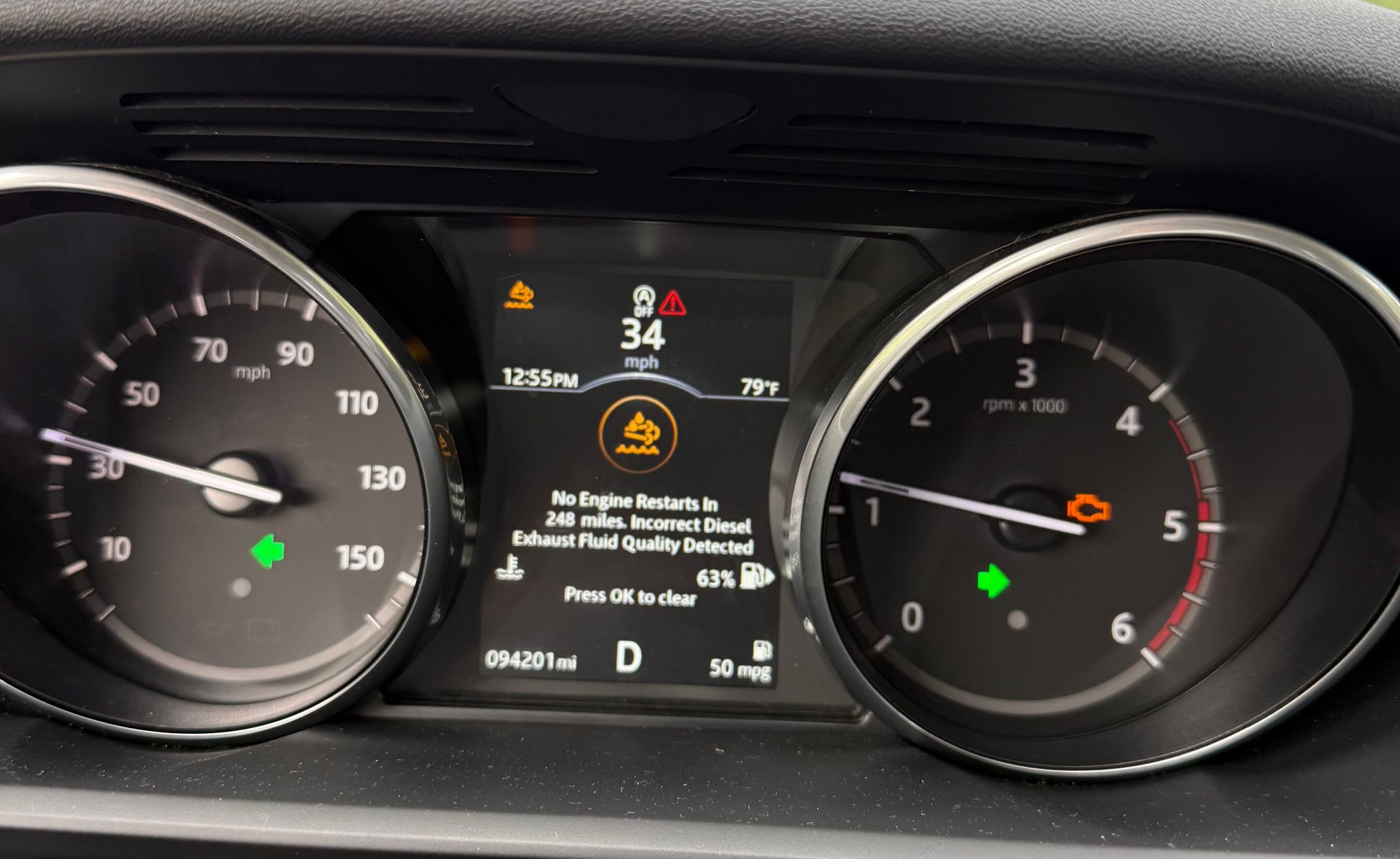

While driving to the Indy (2-3 miles)

Could be a def doser/injector clogged. Easy to access and clean. Common challenge with diesels in general .
