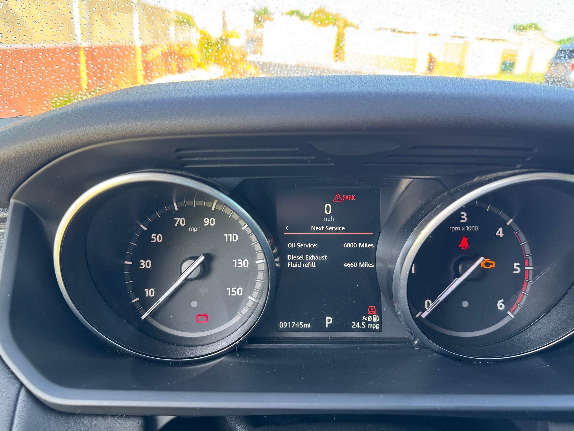

I noticed DEF not going down. What is the ratio of use?

I'm on my first fill of DEF after having our DPF replaced. After 2500 miles it says fill 1.6 gallons with 2900 miles to go. DEF is primarily consumed during regeneration since a significant amount of NOx is generated due to the high temperatures required to burn soot out of the DPF.

For me after 200-300 miles still at 4660. Like no def was used. On m way to the dealership (non JLR)

I've consistently been getting just over 4,000 miles between DEF fill-ups. You may need to go more than a few hundred miles for it to register.
