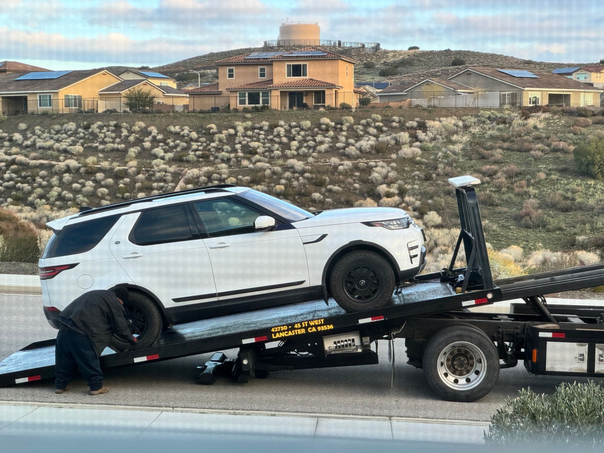

Wow so the dealer quoted me 7800 for an engine teardown to investigate and here’s where the extended warranty companies get you. They don’t cover “diagnostics” and since we can’t say exactly what’s wrong they won’t cover the teardown.
Having it towed to an independent shop - has any one considered remanufactured replacements?
Looks like I’ll have to put out another 1500 for them to do the teardown and then see if the warranty can find an excuse not to cover .
