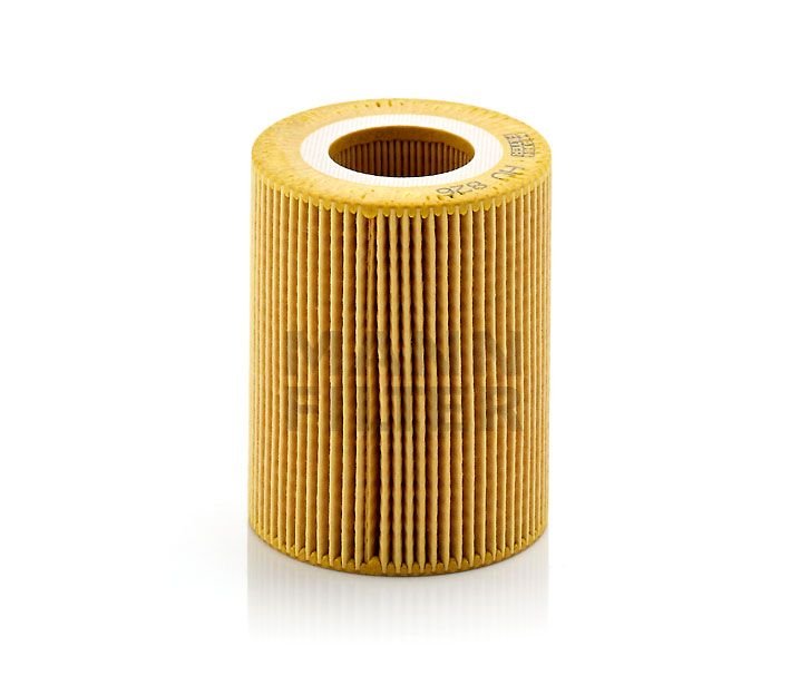

The MANN HU826X is Synthetic media. I run it.

Mmmm, I don't think so. Synthetic media is typically blue or white, whereas the Mann is yellow which is indicative of cellulose. Also, that price isn't consistent with the cost of synthetic filters.

MANN HU826X Includes Gasket / Seal(s) Info
Synthetic Oil Application. Premium filter recommended
Sorry about that, it states "Synthetic Oil Application"........never had an issue with MANN
2003 VW TDI 520K only ran MANN filters Mobil Delvac 1 full syn (retired(( totalled)) )
2015 VW TDI 126K only ran MANN filters pentosin III full syn
2017 D5 TD6 62K only ran MANN filters MOTORCRAFTXO5W30QFA(Heavy Duty / Diesel) Full Synthetic Diesel; SAE 5W-30 (Ford engine, Ford Oil)

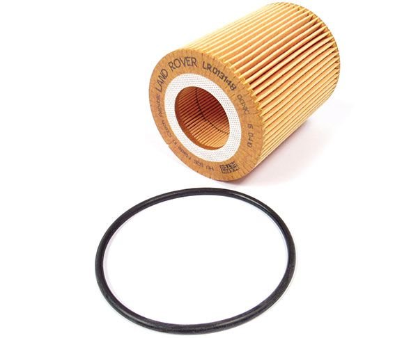

The MANN filters are the same as JLR part filters; both made in Czech Republic at the same factory. The JLR one just has an additional JLR logo and p/n on it, but it's still the same MANN filter with a MANN logo on it, though. A Ford MOTORCRAFT FL2081 is supposedly identical and made in Czech Republic without a MANN logo, but it's probably the same filter likely made in the same place.

AirRyan you are correct
