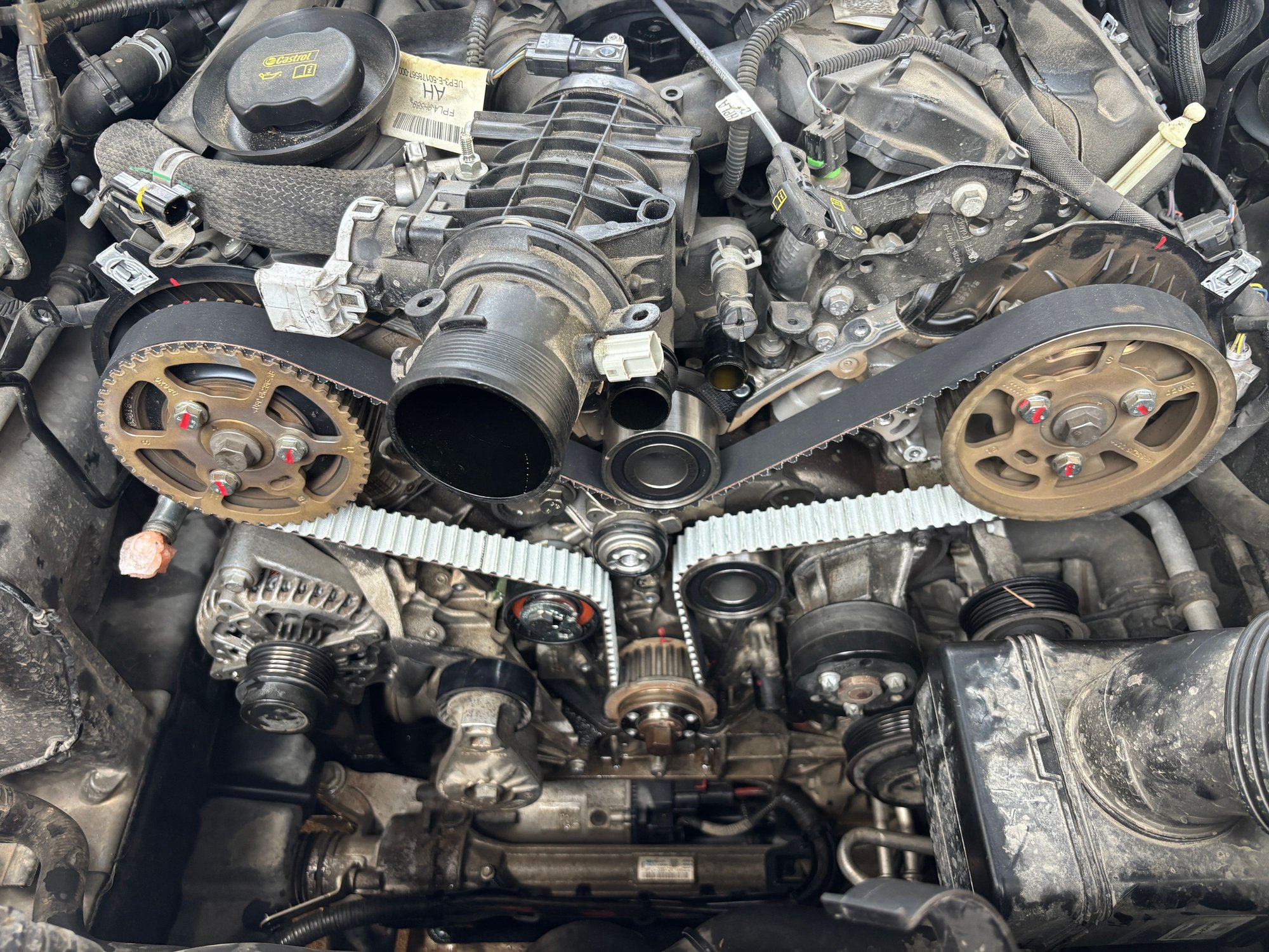

Sorry about the late reply. The job has been completed. My son did the work, he's a certified mechanic. I bought the kit for about $200, it included the belt, 2 pulleys, the tensioners and a new bolt. The job took him 2.5 hours, he said it was one of the easier timing belt jobs he had done due to the amount of space to work - he did not lock the crank, he used a timing mark on the crank pulley and relied upon a good fit for the pins. Water pump felt fine, no obvious leaks anywhere. (2018, 95K miles).
Td6 new timing belt.
