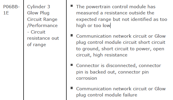

This code is interesting. P06BB-1E - Resistance is out of range, but it's not too bad. Let's set the light on anyway.

Yep. I'm looking into it. #3 and #6 are the hardest ones to get to and require removal of the oil separator from what I can tell so far.

I got the same error message. luckily on glow plug 6
so cleaning the connectors might fix the issue? I will try that first.
@Chucktasti pls keep us posted how you fixed the issue.
