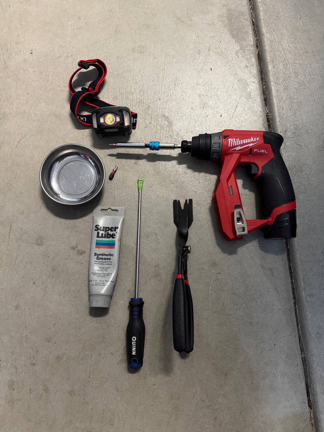

Rundown of tools needed:
T20, T30 bit, bit driver, extensions.
Trim pry tools (I used a taped flathead & Harbor Freight trim tool)
Grease & spray lube
Headlamp
Suction Cup
Fishing line (might not need).

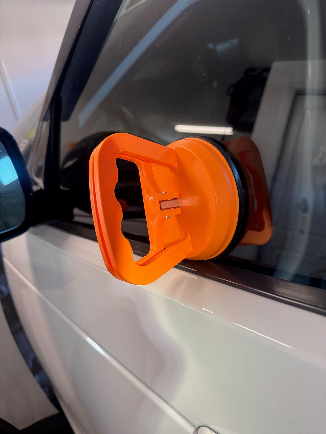

First, suction cup the window to prevent the glass from falling down.

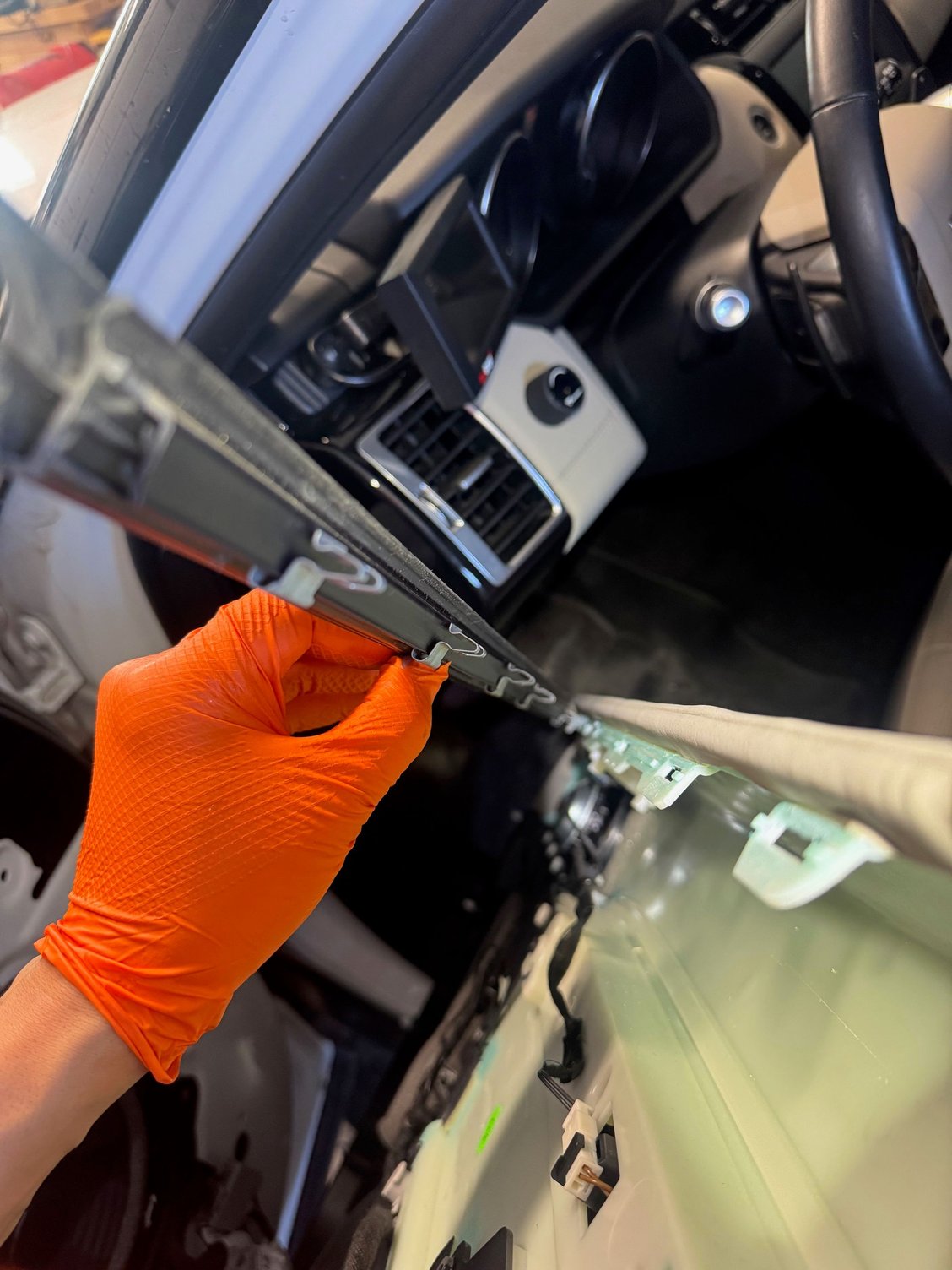

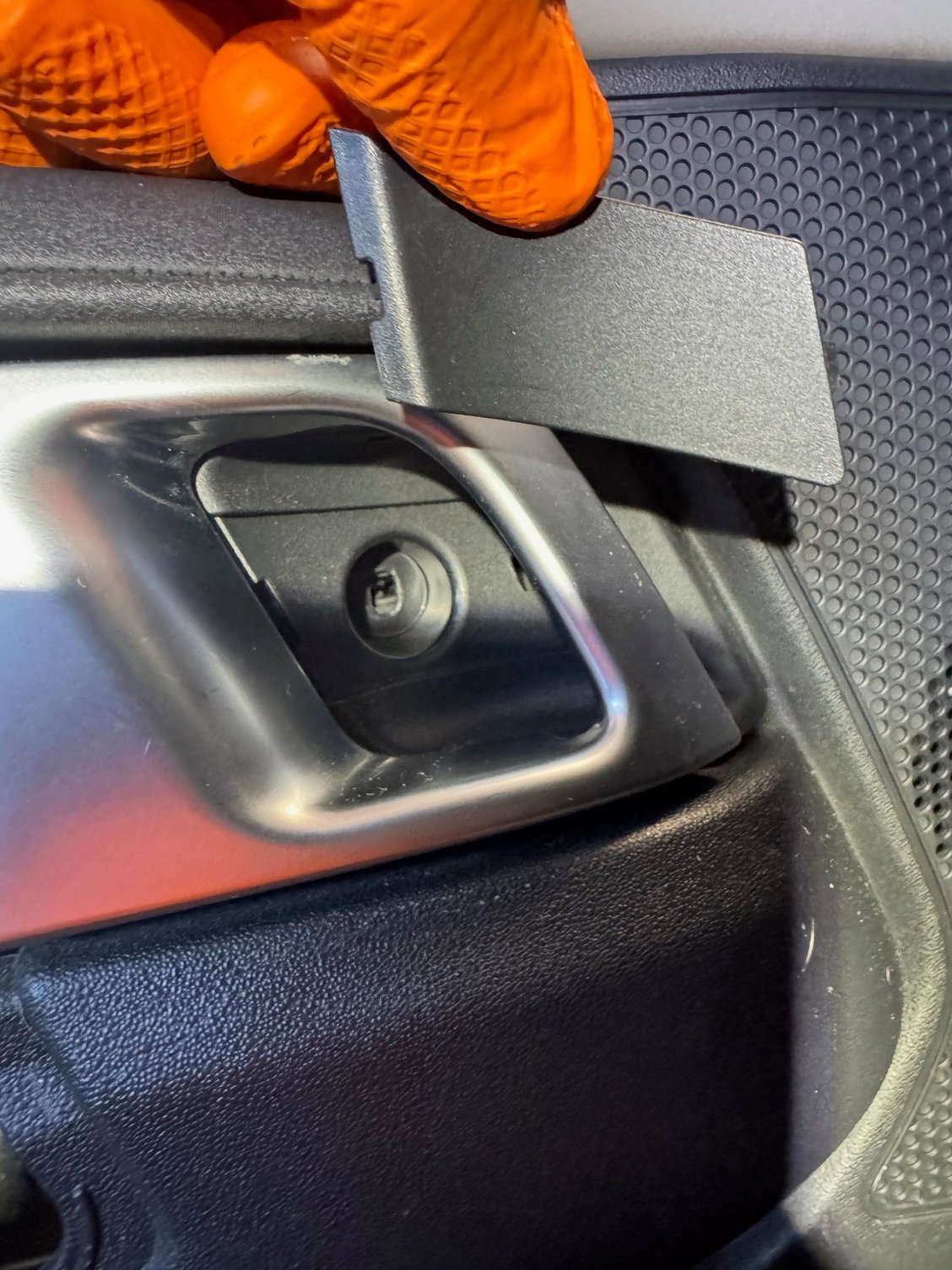

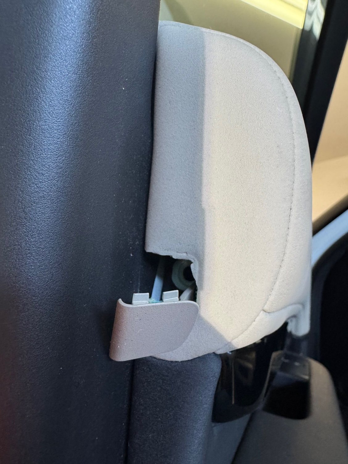

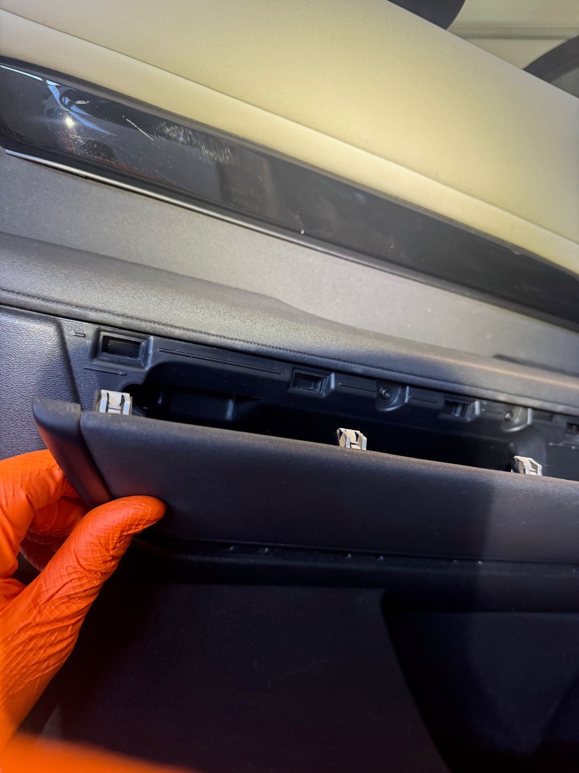

Removing trim per service manual.
Easiest way to remove is to start in the upper left corner with your pry tool and pull off with your hands.

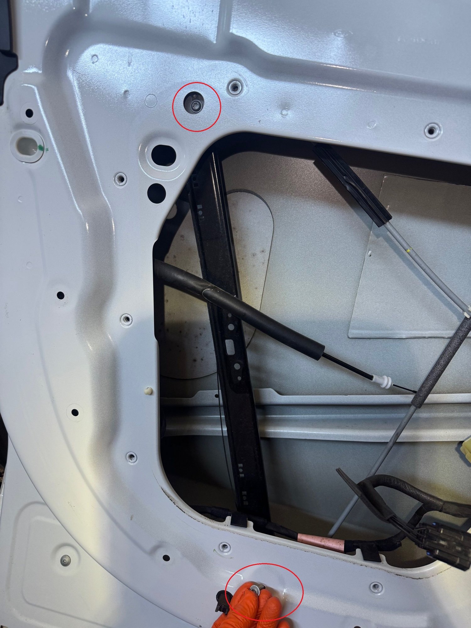

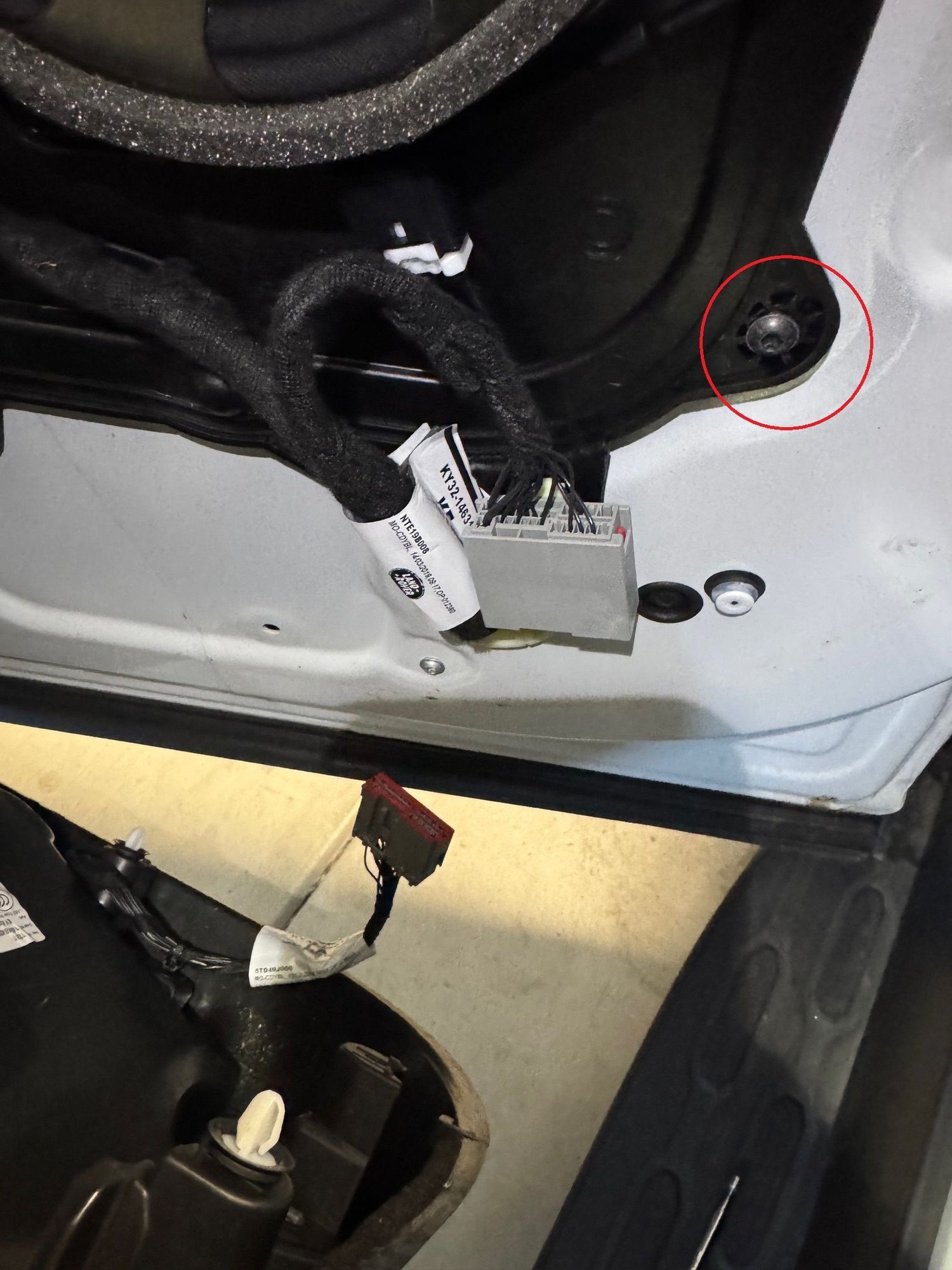

Screw Locations

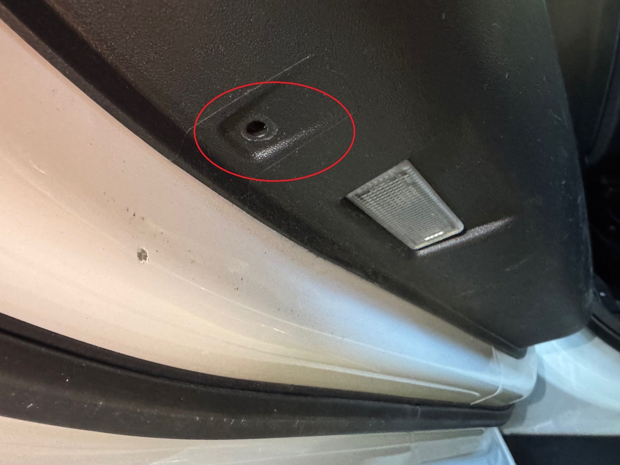

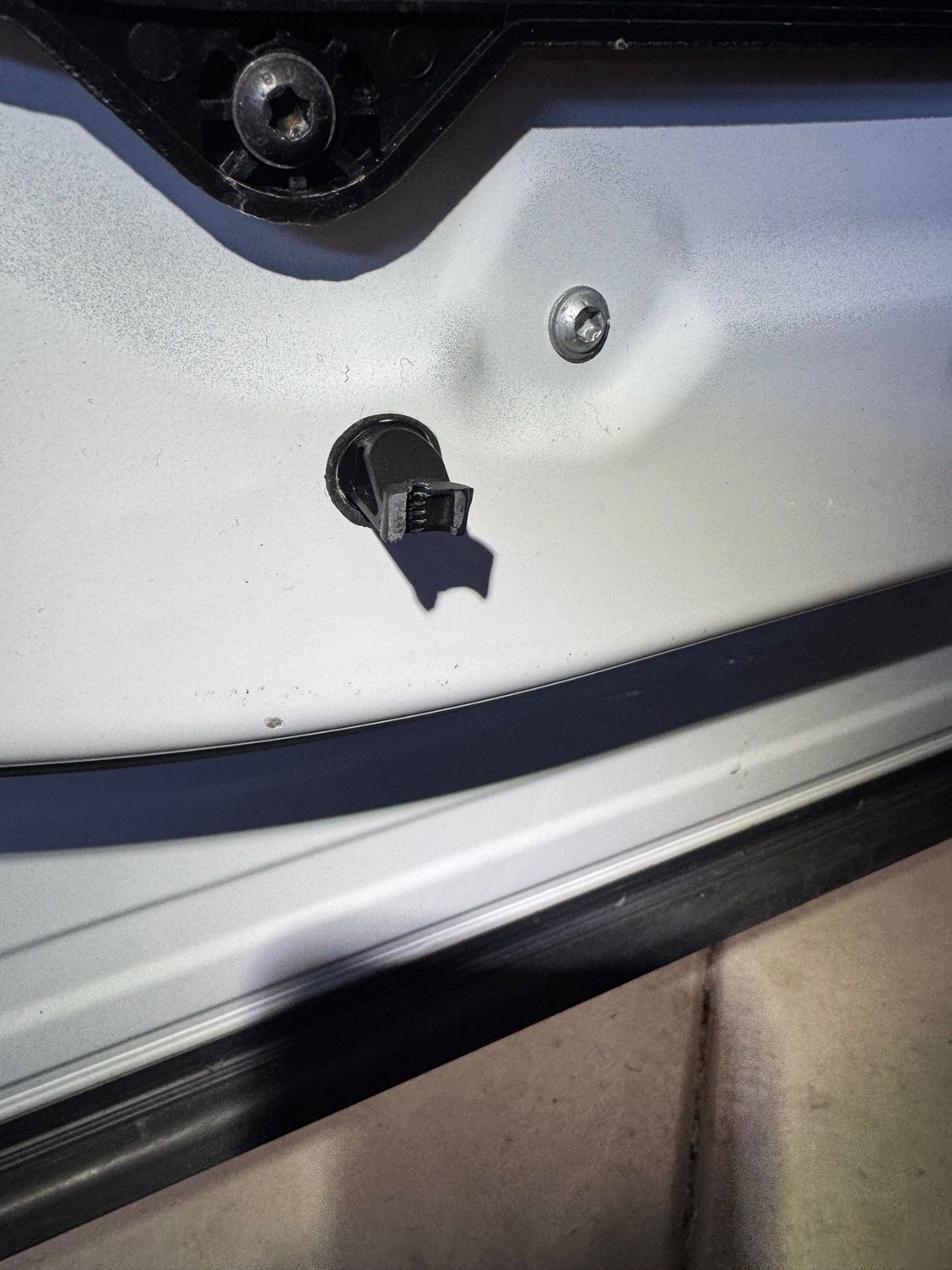

Screw at the bottom of the door
Remove clip and screws.

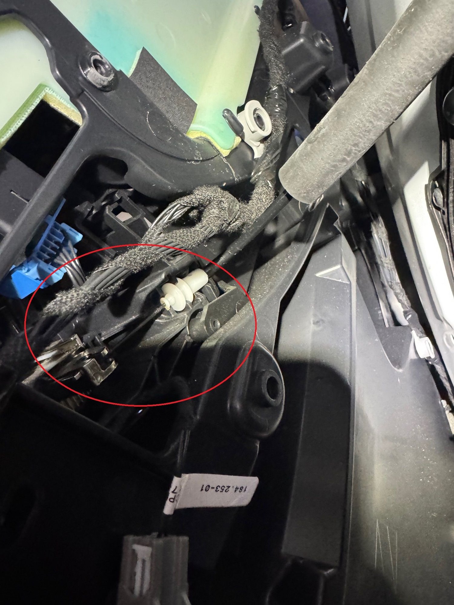

Remove door cable, pull the white part out with your fingers and loop the cable head out.

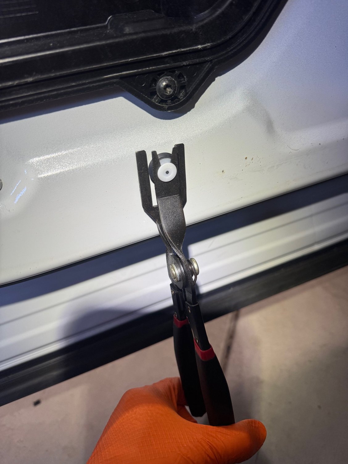

I used the HF trim tool to remove panel clips stuck in the door
My bottom door screw retainer was broken, will replace it later.

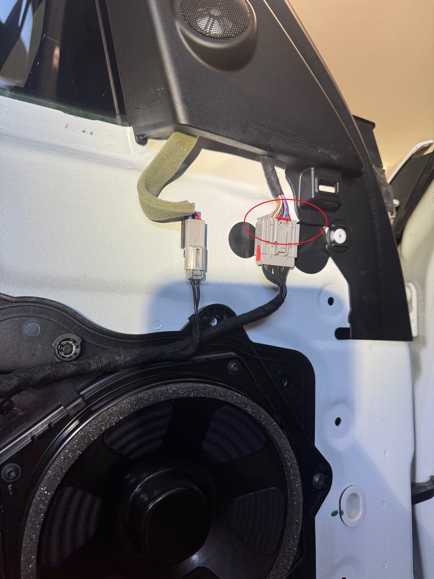

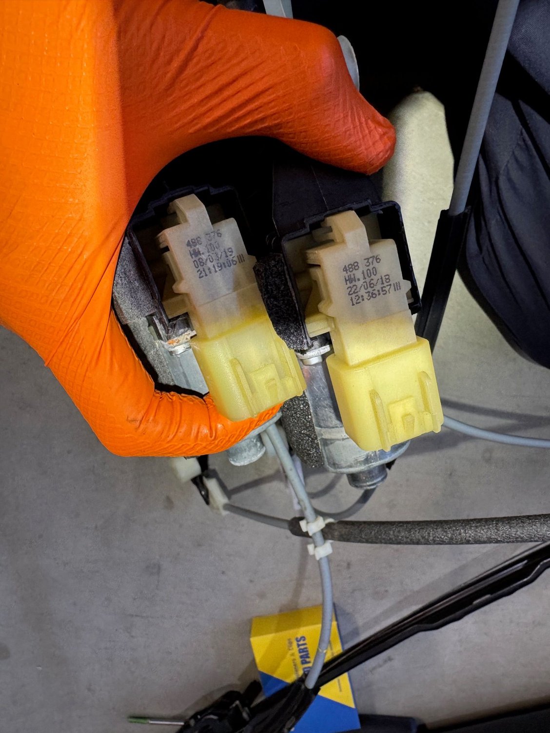

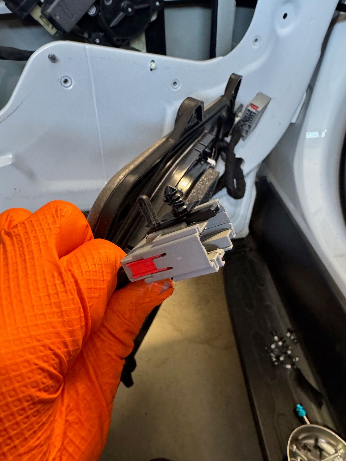

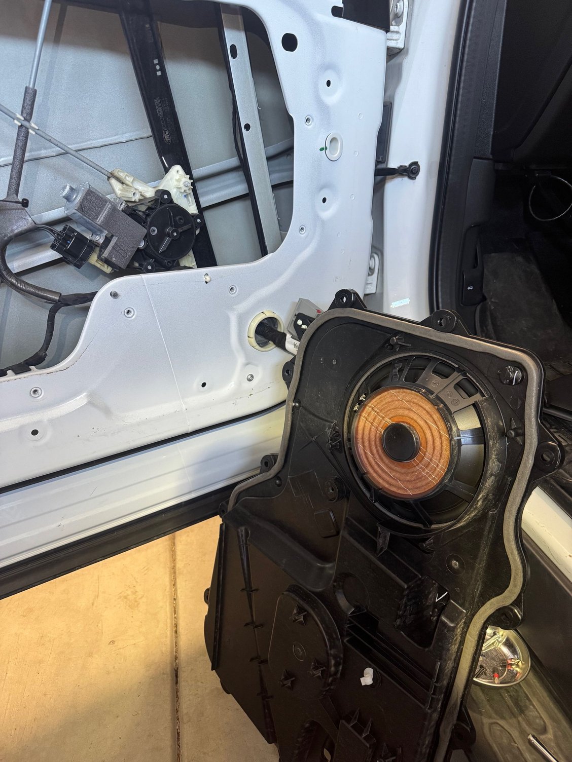

Remove two connectors, connector on right has a lock, pull upward and you can disconnect.
For more working space, I removed the female locking connector from the door with the HF trim tool.
Panel out of the way to allow working room.

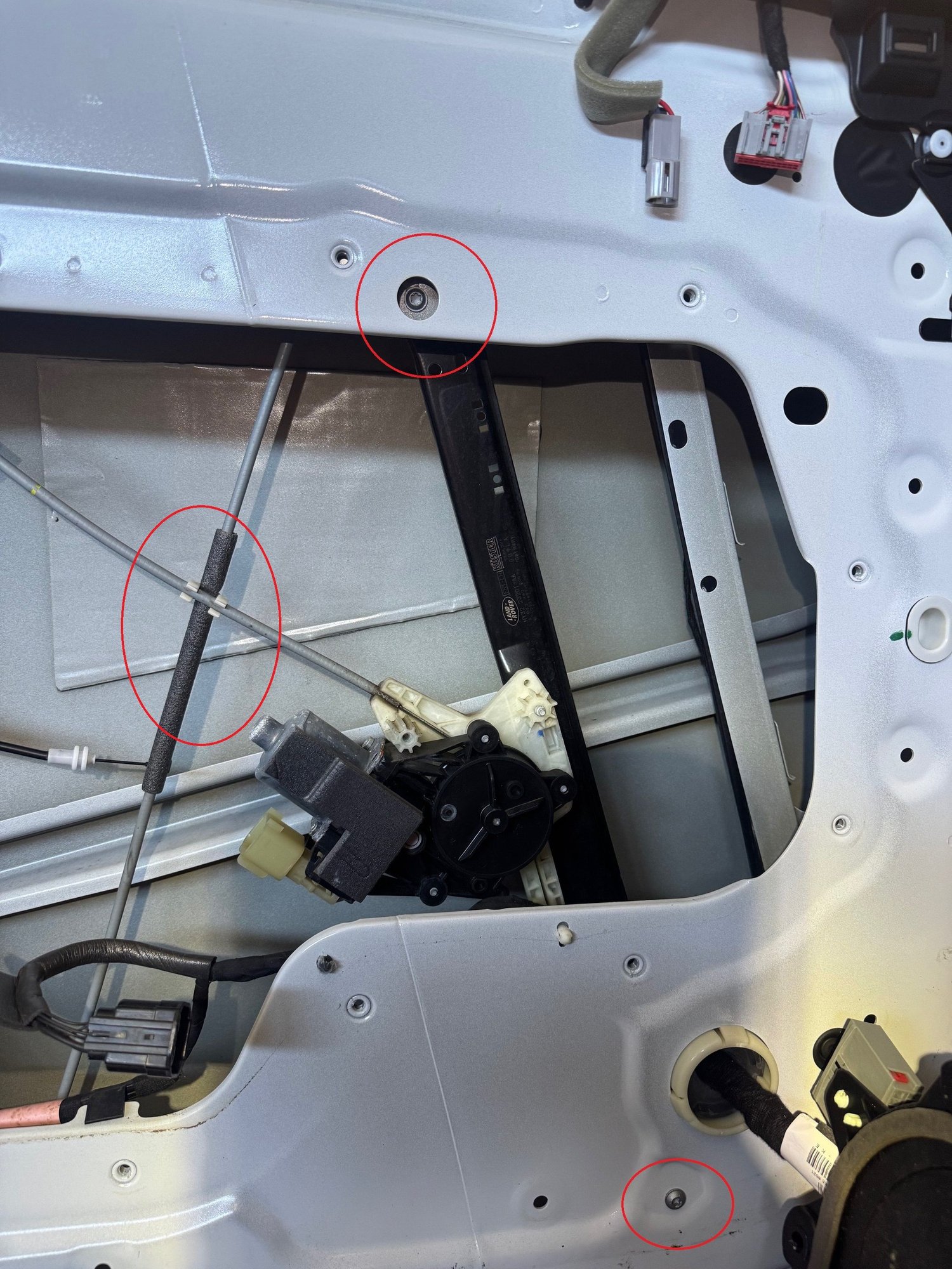

Window regulator screw locations.

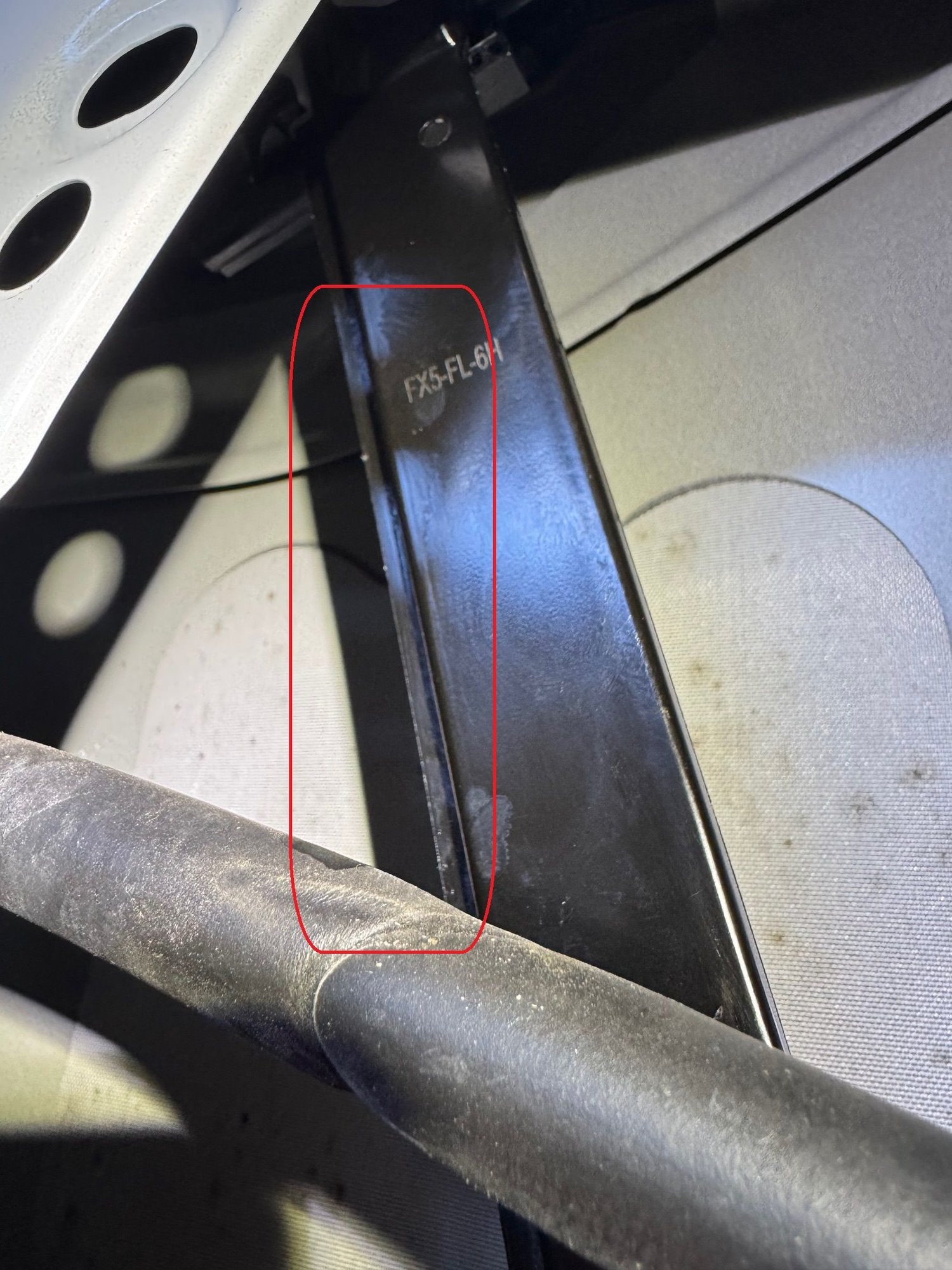

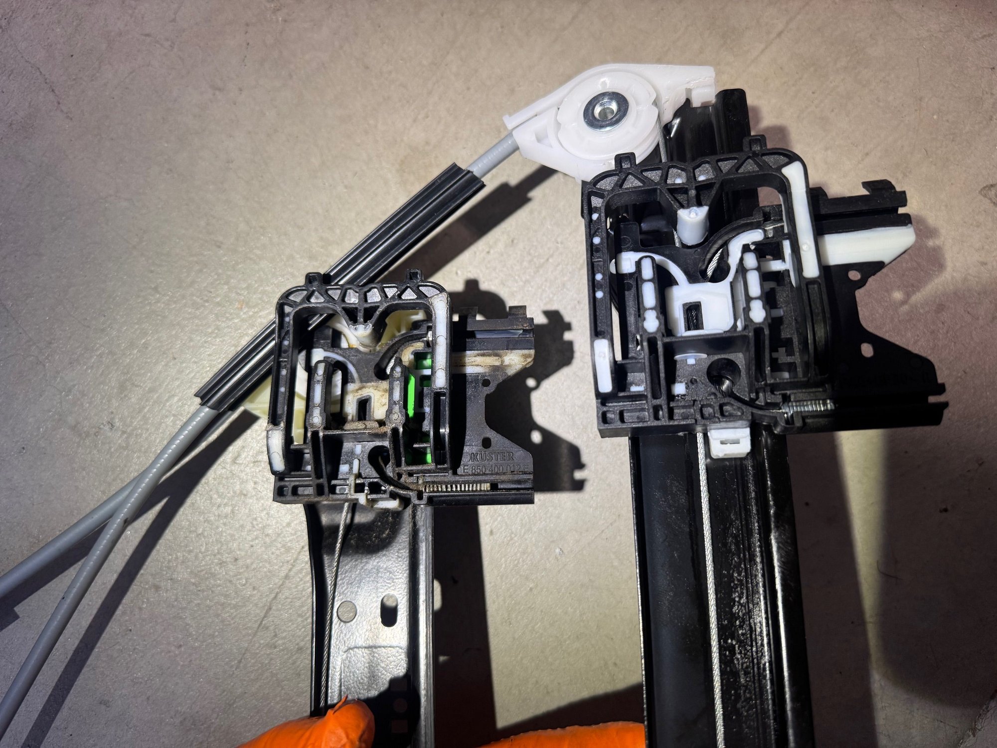

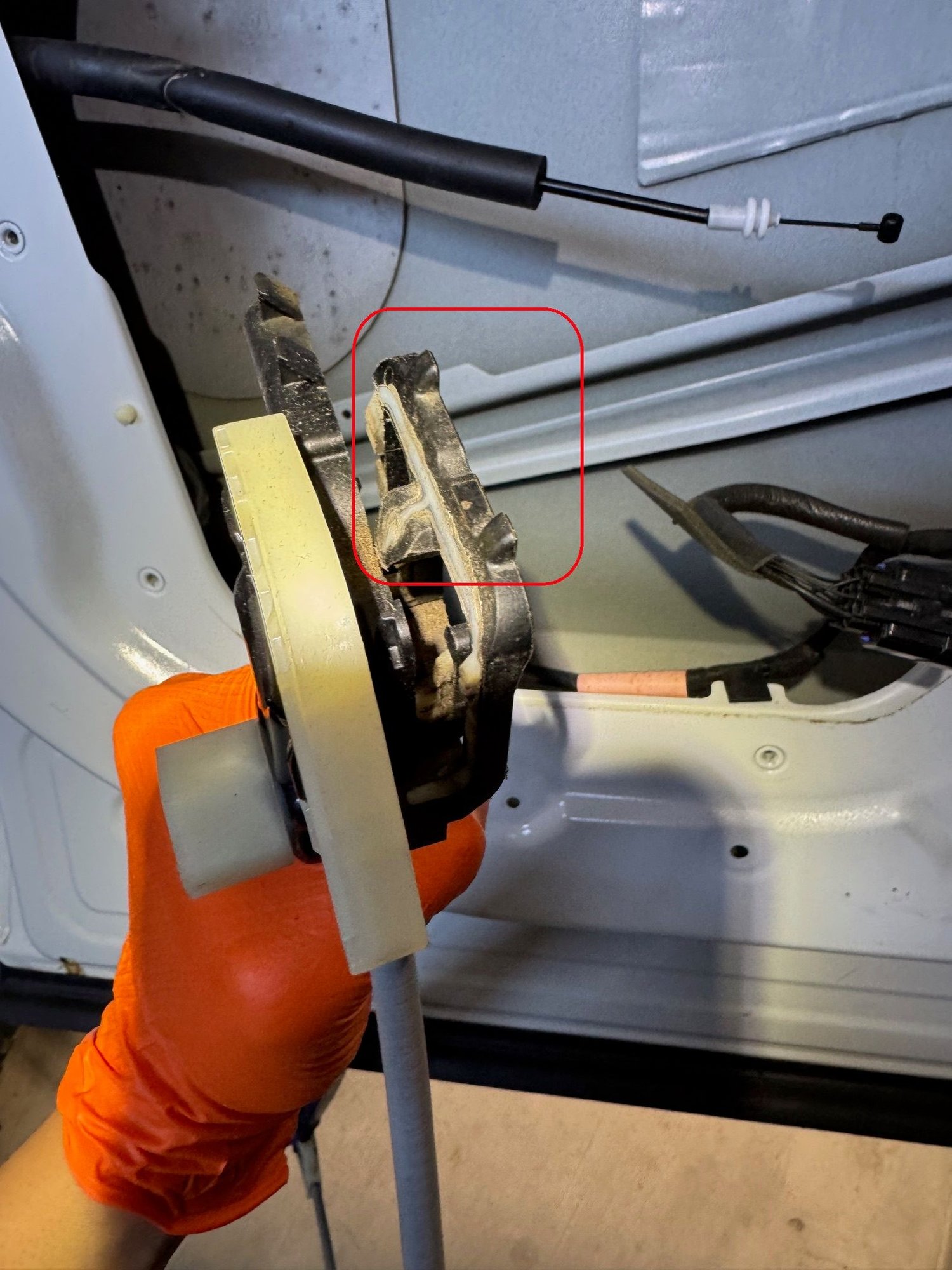

Remove the white clip, cut the foam straight down and remove. My replacement regulator didn't have this and I had to remove the panel a few times to transfer it over.
To remove the clip from the window, pry on those two tabs away from the window and wiggle off.

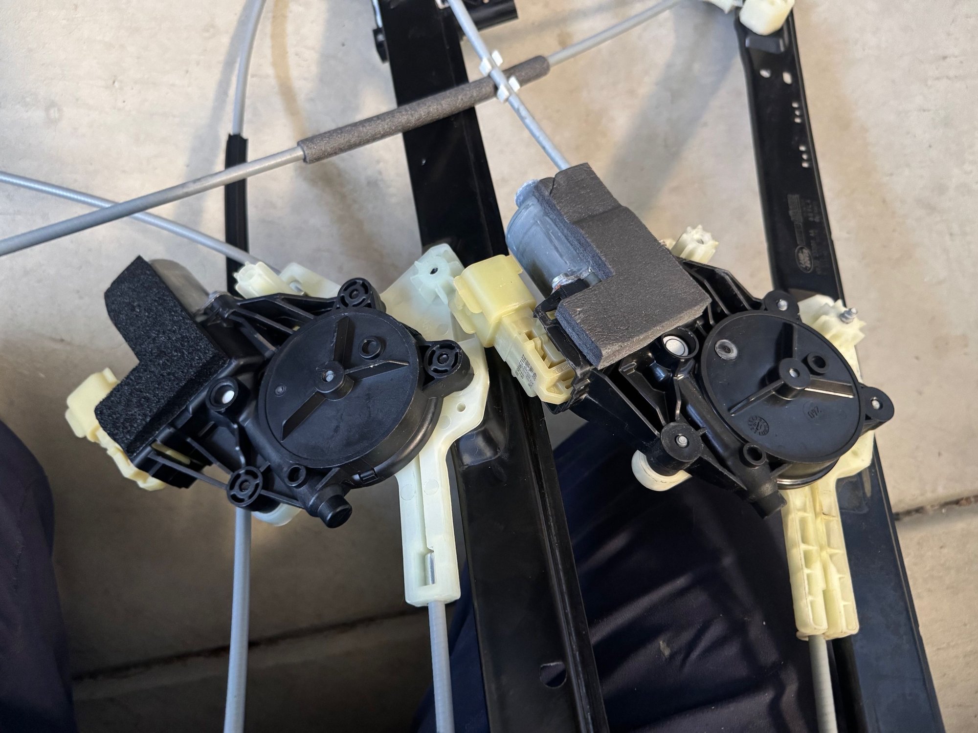

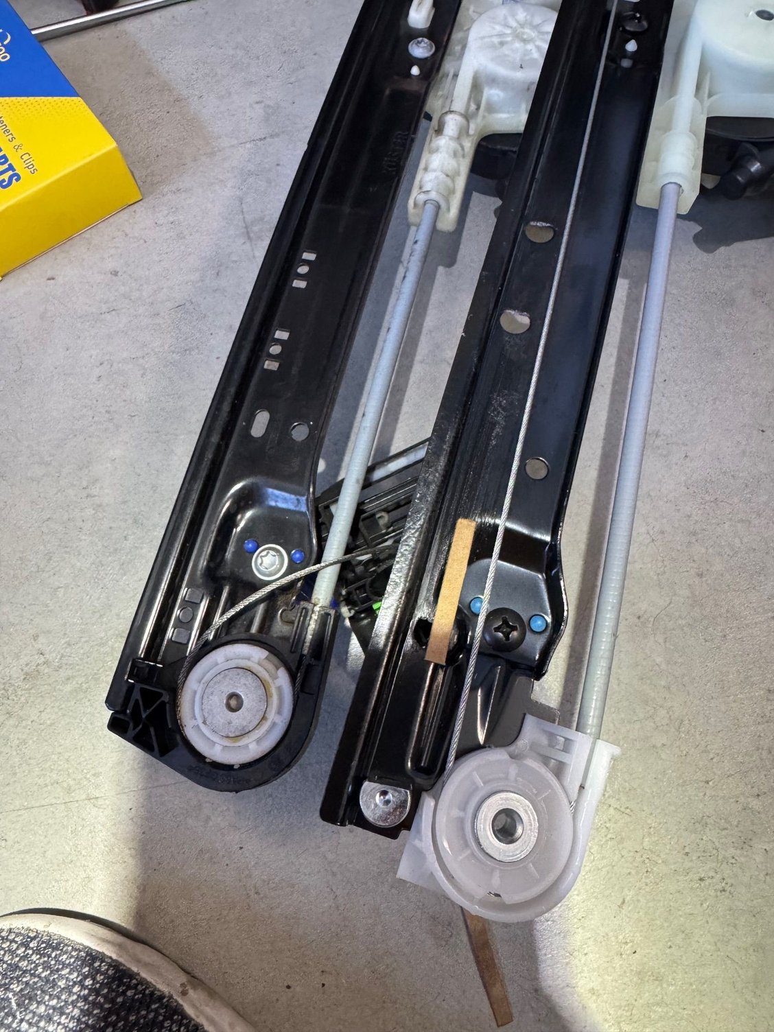

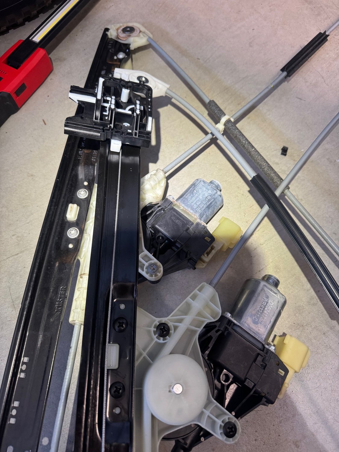

Amazon window motor compared to OEM.
Foam is slightly lower density but not bad.
Remove old regulator, install new one. I lightly greased with Superlube these channels on both sides where the window clip slides on. I also used the Dupont Chain Saver to wax spray the cables and pullies before install. Hopefully it will provide some protection to the cables, as my last one appeared to be rusted out.

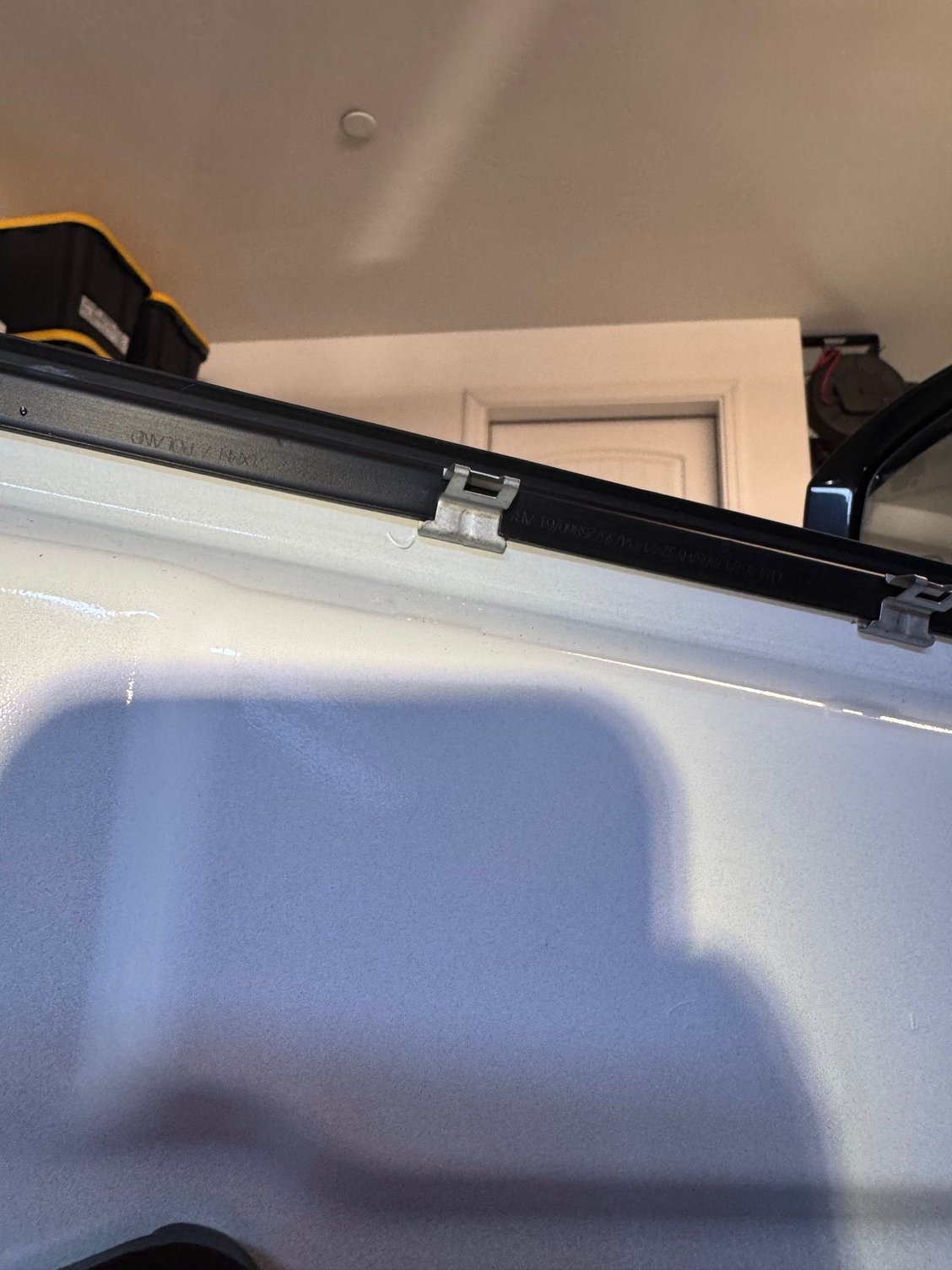

Reassembly tips - remove the top felt trim from the door panel and install it on the door BEFORE you clip the door panel in place. Remember to feed your door cable back through the inner panel.
Felt trim in place on door.

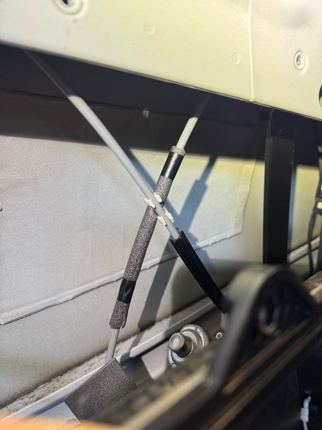

This is what I had to remove the door panel a few times for. Electrical tape the foam in place and use the clip to secure the two cables together.

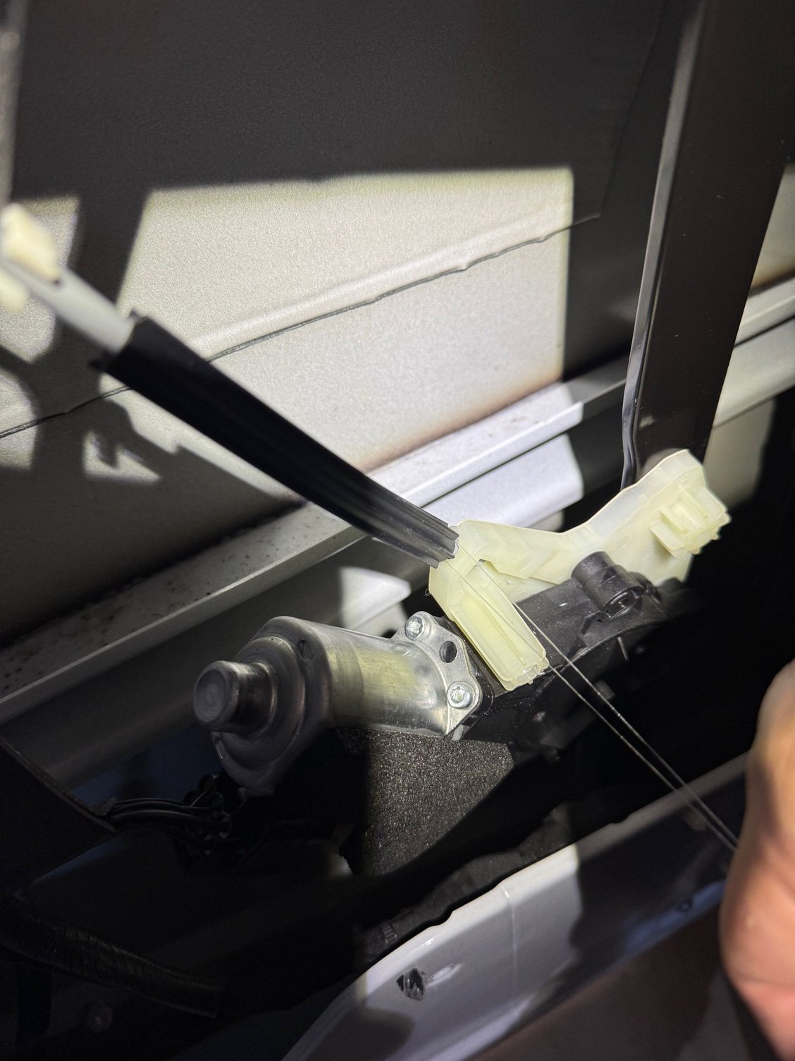

So, upon initial reassembly, the T20 screw in the center of the inner door panel wouldn't reach the new motor .
This is a trick I used to pull the motor close enough to the inner door trim to be able to screw it in. Use fishing line, loop it around the cable above the screw hole, and feed the ends out the door panel. Pull the line as you twist the screw, and pull out the fishing line after it catches. Reeassemble everything back together. Reconnect all connectors, install inner door panel, making sure you pulled the door cable thru. Attach all screws.
Align the top of the door panel with the felt trim clips, push those in place, then you can push the rest of the door clips in place. Make sure all trim clips are on the panel and none are stuck in the door.
I kept forgetting to feed the door cable thru the inner panel, so I had to go back and re-do it a few times.
Overall install isn't hard at all. As stated above, I greased the clip slider channels, and sprayed chain saver / wax on the plastic pullies and cable. No where in the SM did it address the motor screw not reaching, so the fishing line trick worked like a charm.
