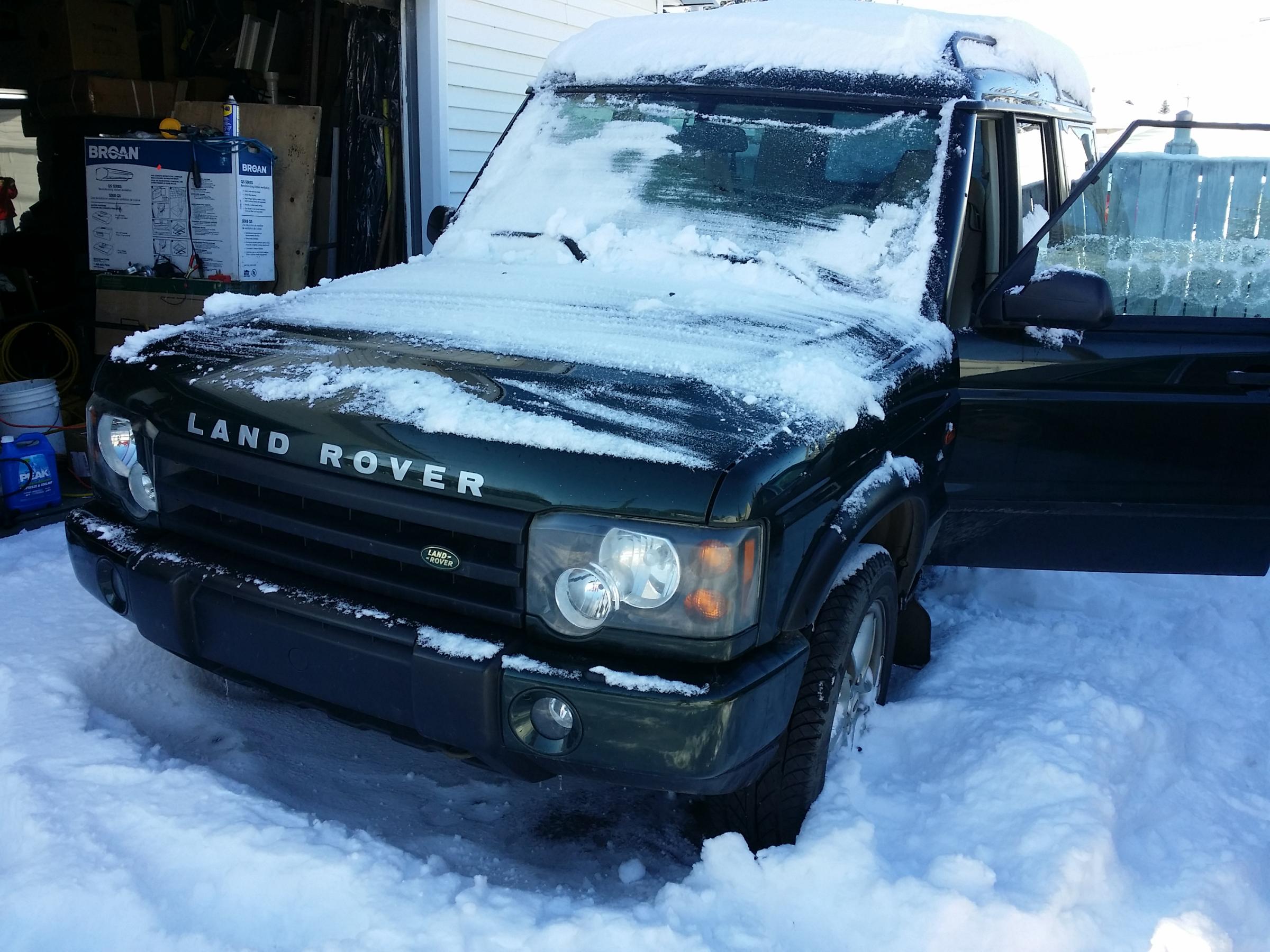

Have to sound like a dummy, never used an OBD tester before, so will post the photo and ask, what is the next step? The place where it displays Codes, states, "No Codes Found" . Now thats puzzling to me?
Open to what to try next. From reading the threads, I seen that it could be a faulty Fuse Box, which is my next guess, but yes, only guessing. I don't understand why an exact code wouldn't pinpoint the correct issue to address?
Anyother question, Not sure if Disco 2 or 2, or? Which is which?
