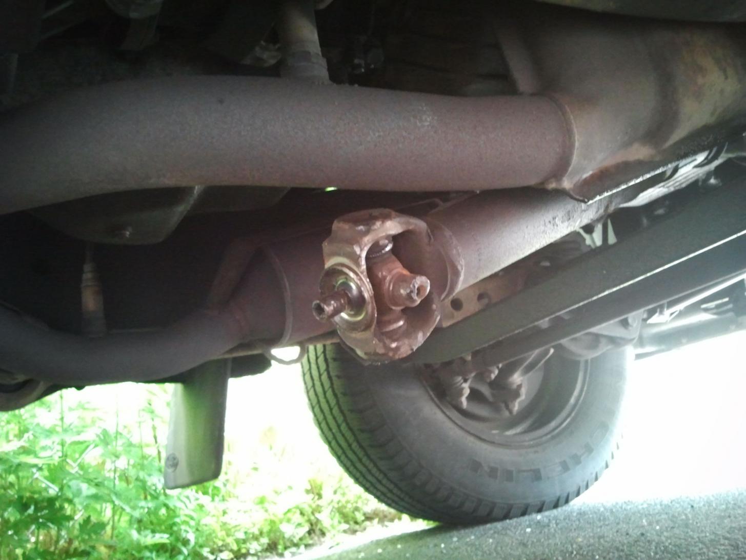

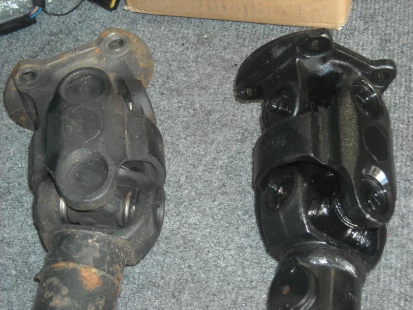

2. The D2 has a factory front drive shaft with no grease fittings on the double U joints. When the grease is cooked out by CATS, they will split with almost no warning, and then beat a hole in the transmission case. Avoid by rebuild now (article in our tech area) or an aftermarket shaft.
