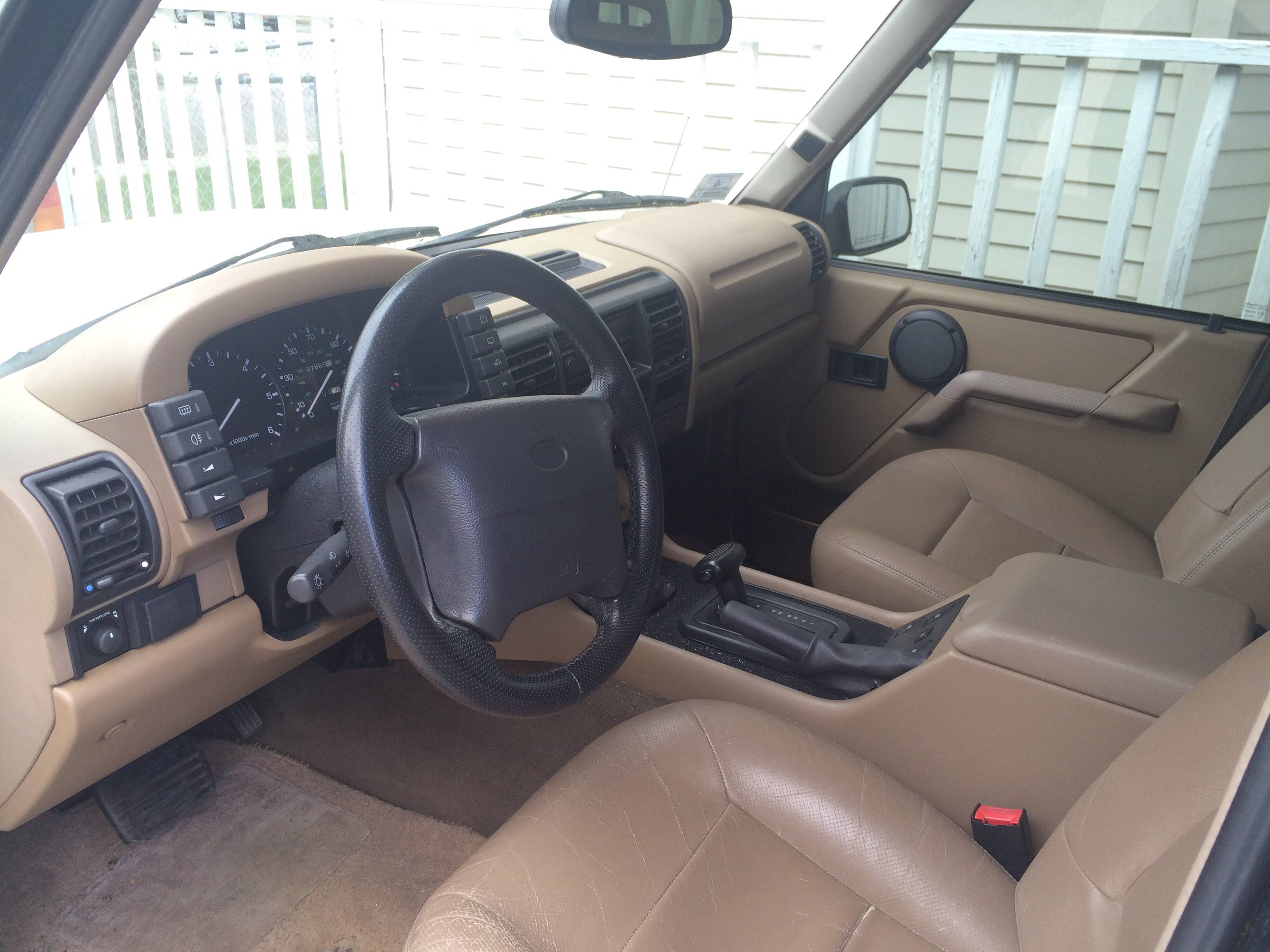

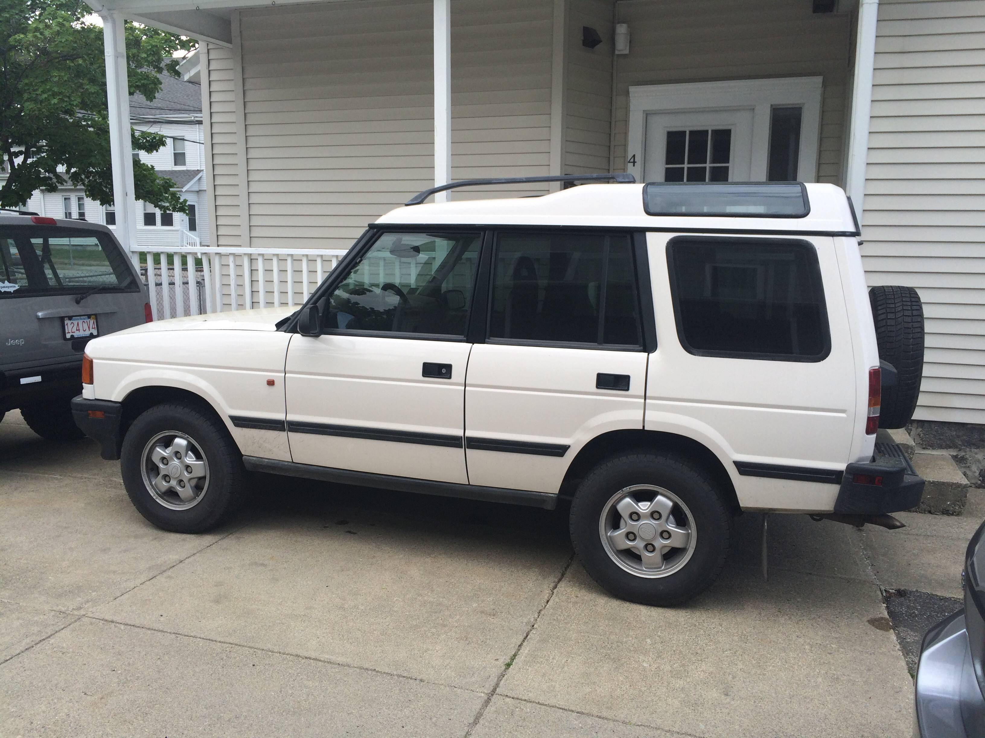

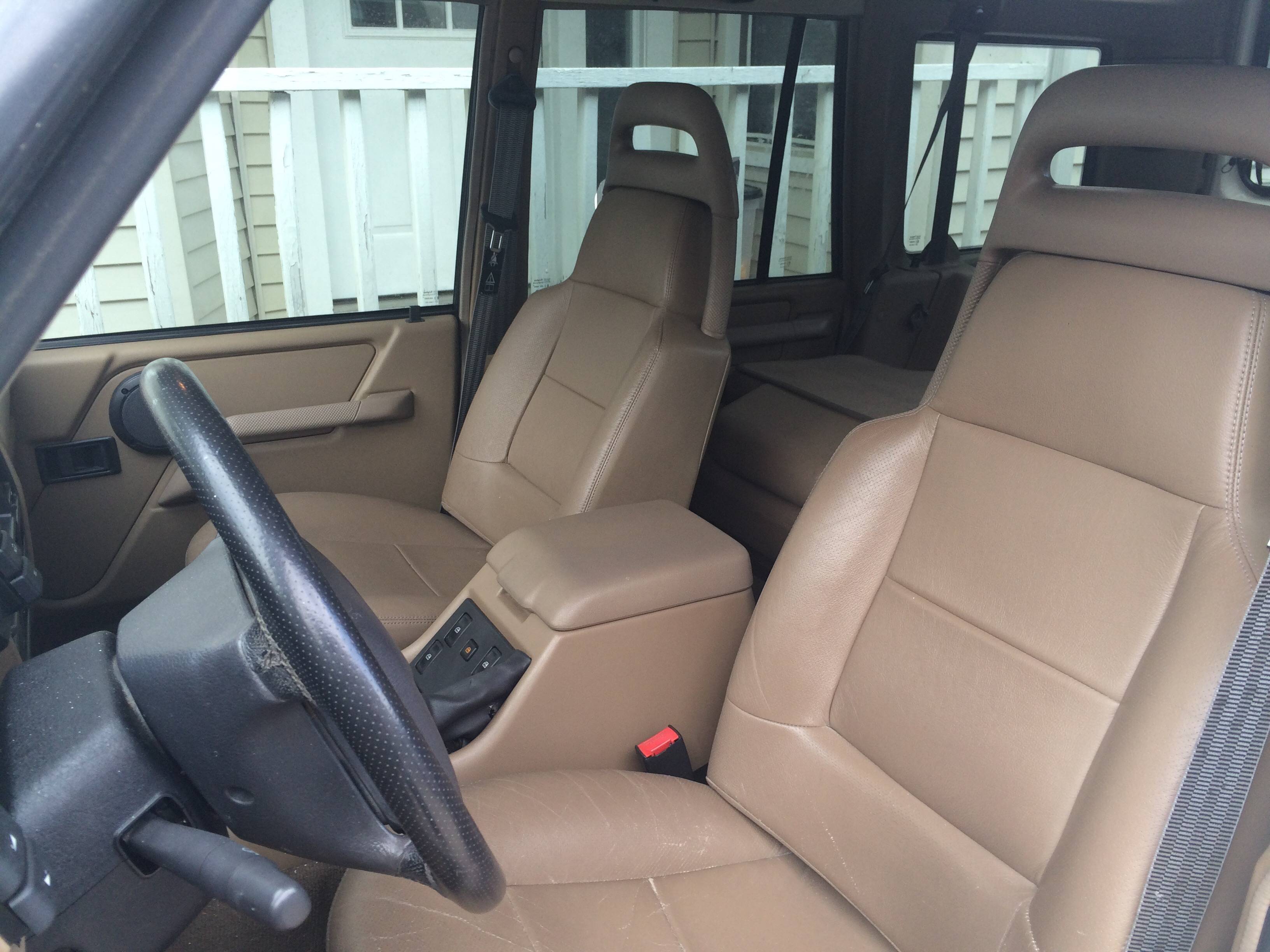

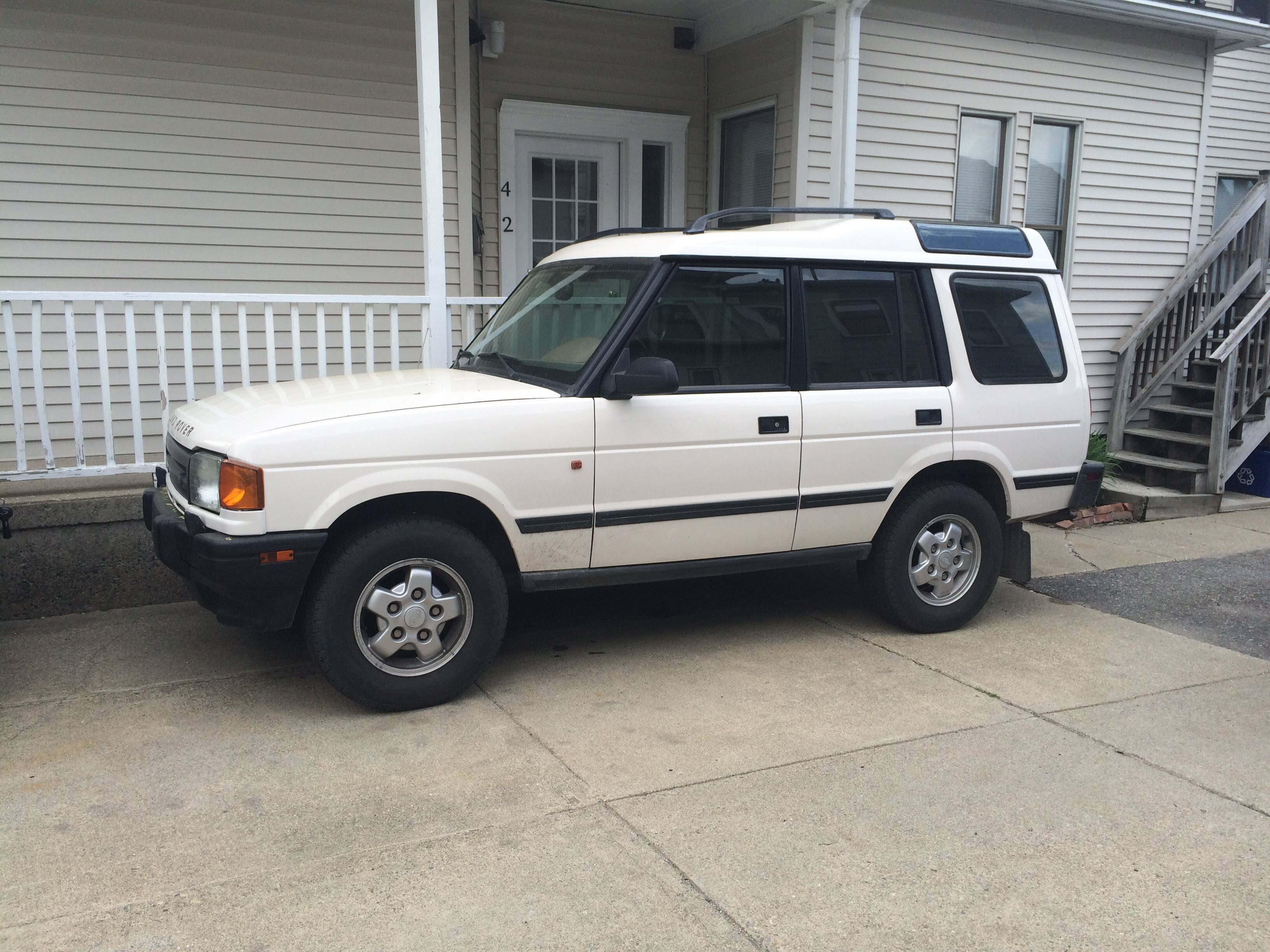

here's a few pics-

nice!! there is a valve on the fuel line where you can check to see if you have fuel pressure when it won't start. Looks like a tire valve and may have a cap on it. If you don't have pressure there , see if the pump runs when you turn the key on (may need a second set of hands) pump only runs a short time and if the motor doesn't start, it shuts off. ..if you don't hear the pump run, and no fuel pressure, time to start checking. Mine was the wire connection at the inertia switch under the hood.
