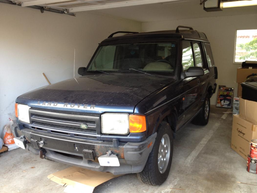

Finally bit the bullet and got my first Rover yesterday. Picked up a '95 Disco that is not running $700. I know I've got my work cut out for me, but I have high hopes between the RAVE and forums like this I'll be able to get through it. Picked up lots of information lurking already, and I'm looking forward to be able to put my own triumphs and tragedies in here soon.

Might be anything from simple to impossible. Start with a download of the factory shop and electrical manual set, called the RAVE, below. You'll need a battery charger to keep battery up so you can perform tests. Basics are good battery, starter turns over, makes spark, and 32- 34 PSI at fuel rail on passenger side.
