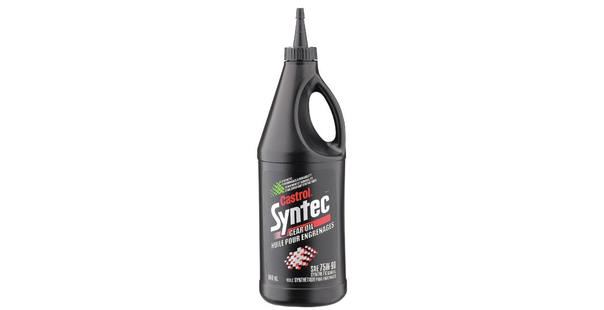

Smile Castrol BOT720 or 75W90
Hi, so here is an update for anyone who might make this mistake in future. I contacted the dealership and they recommended Castrol BOT720 or 75W90.
Using a 10$ hand pump, you can top it up. In my case the drained oil was 250ml, so i topped up with 250ml Castrol 75W-90. It's definitely gonna be a little messy, just make sure to stop the oil from coming out and screw the plug immediately.
DO NOT put all your effort into transfer cases, they are aluminum, they will crack and break. Ideally you should use torque stick to screw the plug, but even without it do not apply excessive force.
The picture of the oil and hand pump are attached.
Castrol 75W90
