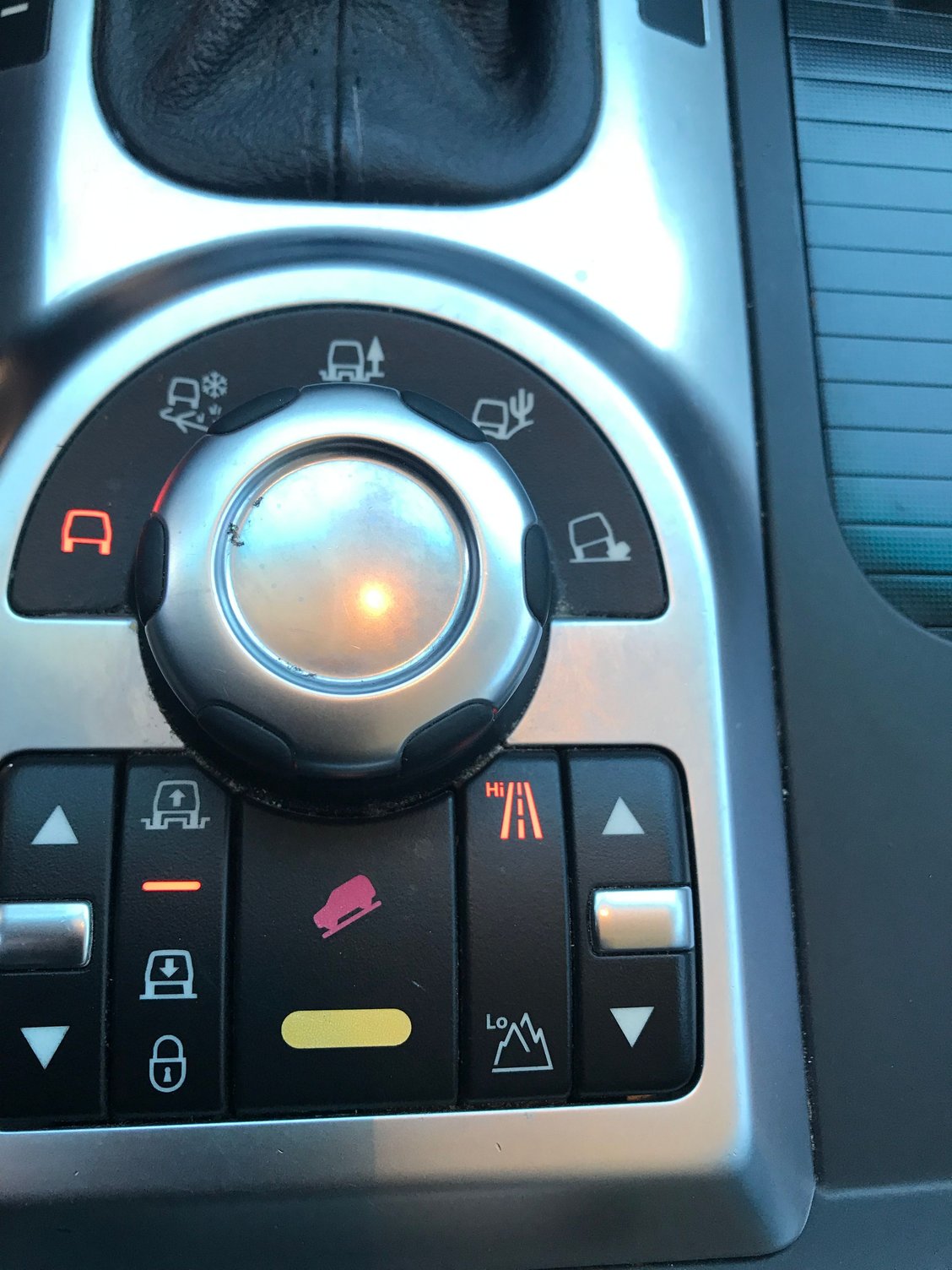

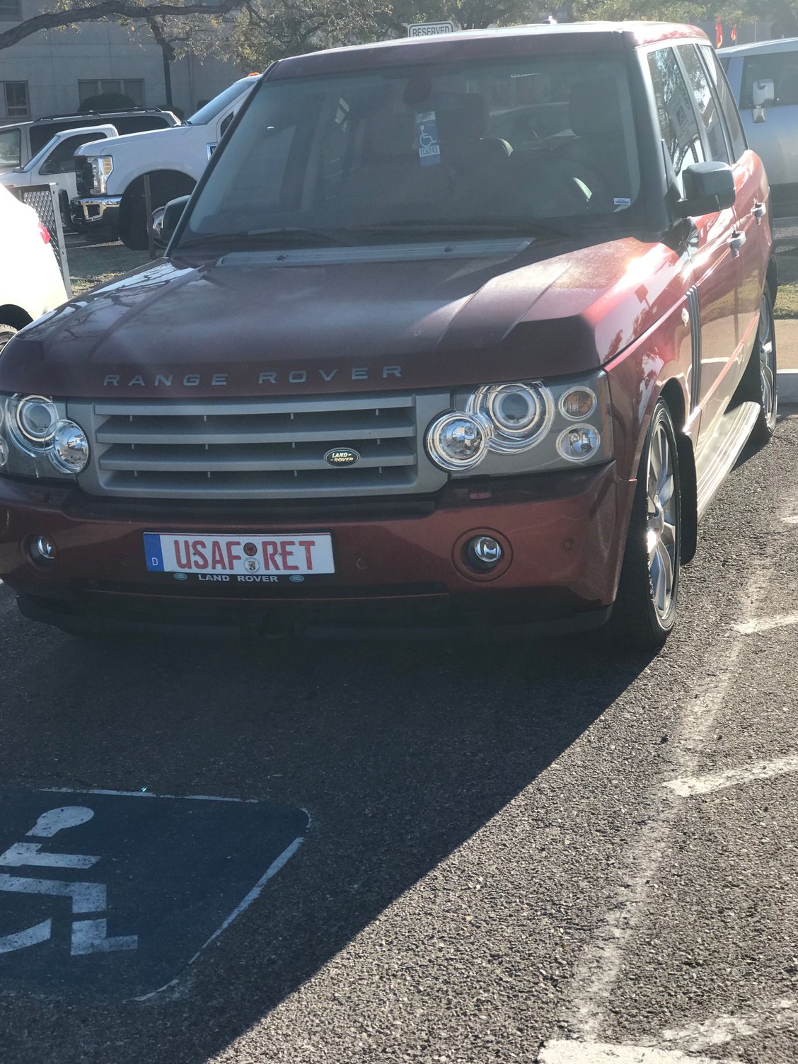

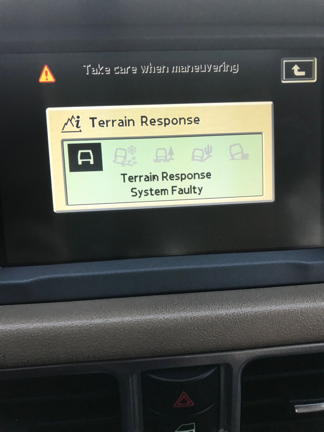

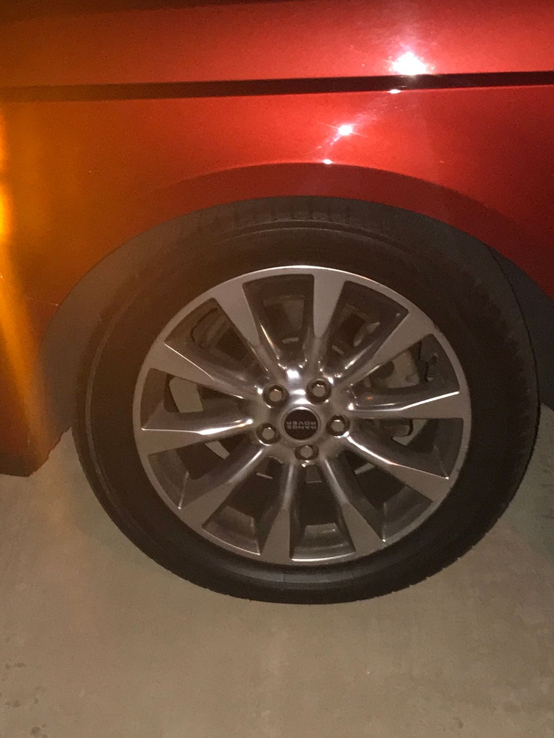

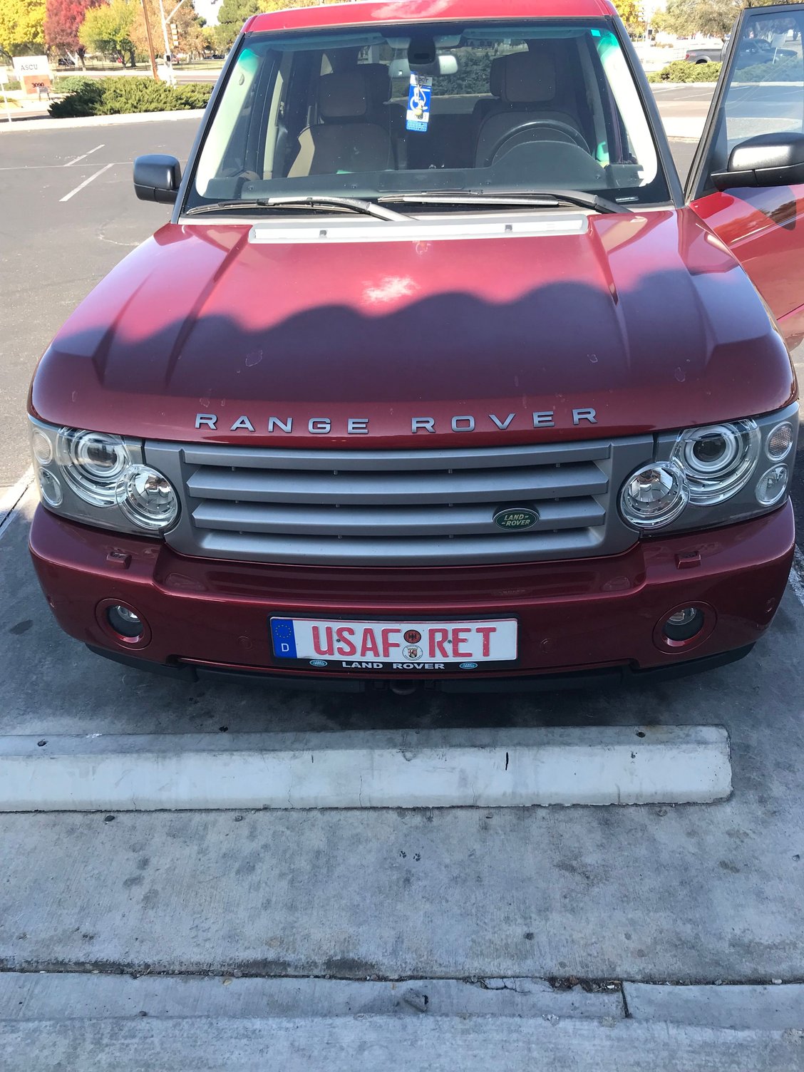

I have a 2008 LR RR HSE w/120K miles.My front end is lower than usual and will not raise up. It bouncy when I hit small bumps.When I start it up, the Terrain Response is in normal mode (Special Programs Off), On-Road Indicator is lit, and the High Range is lit. After about 30 seconds the Terrain normal & On-Road indicator lights go out, but the High Range light stays lit. When this occurs I can’t make any changes to the Terrain Response. I have no clue as to why it is doing this. Help!!
Sequence of events1) 1st Start2) After 1st Start #13) 3 Minutes after Idle4) After 2nd Start #15) After 2nd Start #2

Looks like you have an EAS fault and it is shutting down systems as a limp limp effort.
If it is isolated to the front. It could be an airline, valve block height sensor or spring.
To better diagnos the issue a Land Rover specific tool to pull codes is needed
