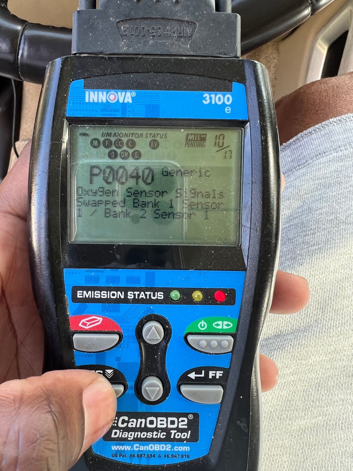

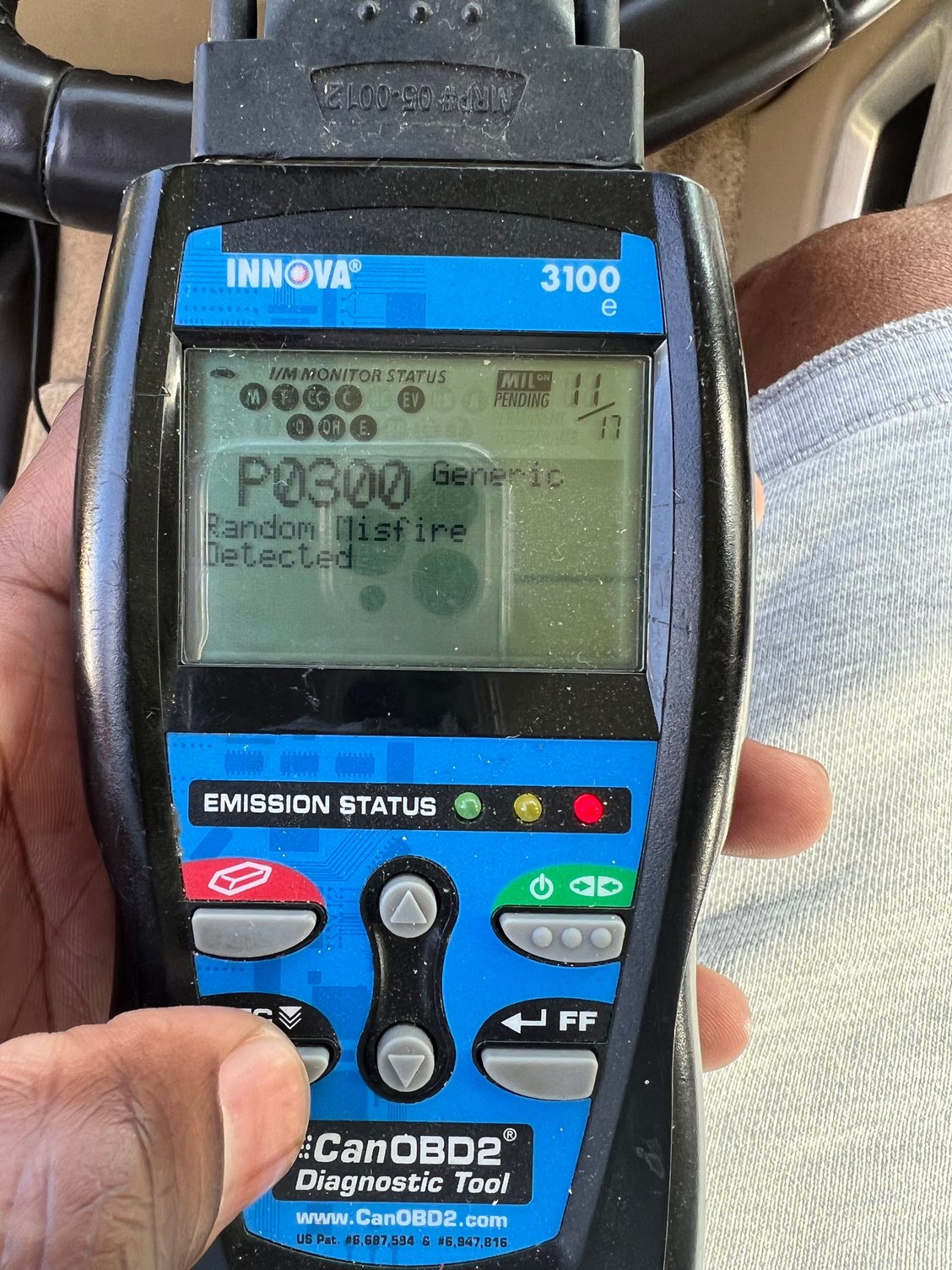

I was driving my vehicle yesterday when the check engine light started flashing. I pulled over to the side of the road immediately and upon doing so I noticed the vehicle would not move that was a very loud rattling shaking noise coming from the bottom rear of the vehicle. The vehicle would not go in Park it allowed me to put it in neutral the front tire seem to roll but the back tire seem locked up. These are some of the generic codes I received on my scanner.
I believe it’s the timing chain because I heard a small rattling noise but no check engine light prior to leaving the house.

Got a call the timing Chain broke and ruined the engine
