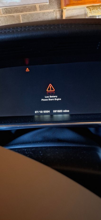

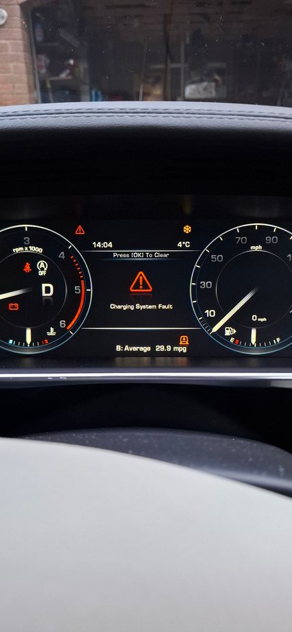

Hi Guys
l have a problem with my L405 Vogue it started after changing both batteries now get 2 warnings on dash low battery please start engine and charging system fault when these come up some systems don't work eg tailgate operation, stop start.heated seats,steering wheel l have a topdon dongle that l used to tell battery replaced friend also tried launch scanner. Faults still persist although intermittent l took reading of battery when showing charge sys fault engine running 14.00 volts any help would be much appreciated

How old is your current battery? Some ageing batteries will not hold charge for long after you charge them. If your current battery is older than 4 years, get a new one.

Hi
Both batteries new 8 mths ago

If you bought the batteries from your dealer 8 months ago, they should still be under warranty. If you bought them elsewhere, they should also have a warranty. Take them back and let them replace the batteries. If replacing the batteries does not cure your problem, you have an electric drain that will need to be diagnosed. Do you have anything aftermarket installed on your vehicle? Have you checked the ground on your car?
