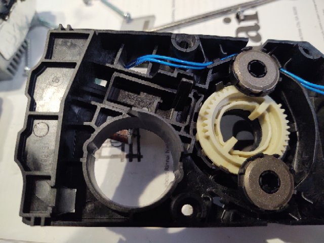

I replaced the Transmission Control Switch (TCS), Fixed the problem. For whatever it's worth, here is what the inside looks like. I have not tested the solenoid, but I suspect there is a failure in either the windings, or the board itself. I will test further, but as you can see from the locking pin, it can be bypassed to allow the shifter to turn, in case anyone wants to just do that.

Also, it does click when you press the brake, so no click, locked in park.

I don't think the TSB will help. The solenoid is usually dead. I saved my old shifter to see if I can either create a work around for emergency rotation, or replace the motor in shifter to make it work again. $350 each time is not what I'd call fun, but that is how JLR makes their money.
