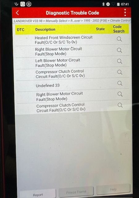

Decided to pull codes again today on the HVAC to see what is coming up and here is were I am. I also did the system test on the HVAC Control unit and I am thinking it failed. I have one in the parts truck but I’m not 100% sure it’s any good to be honest. I think I will pull it and the blower motor though and give it a shot.
Also I am going to roll the dice and order the RSW setup for the P38, the Launch seems to be working but it glitches a lot when messing with the p38 so I want to be sure of what I am seeing.
This is what it pulled up. Montoring live values seems to be working great coolant temps look fine. Still have the transfer case fault of course and I think I didn’t get the evap line fully clicked into the quick disconnect on the tank.

Alright so I tore into the center stack on the P38 and got the old control unit out. To be honest this was just a guess as I really had nothing pointing at the HEVAC unit being the problem. So I got it swapped in fired up the truck checked the codes and saw all the same data. Then it dawned on me I hadn’t cleared anything. So I cleared it and heard the compressor kick to life under the hood. So I hooked up the gauges and put some more Freon in the system and we have cold AC. I didn’t fully charge the system so I can check pressure this evening and see if it’s holding. If it is full charge and moving on. That just leaves the right hand blower motor I think to have what we need working!
