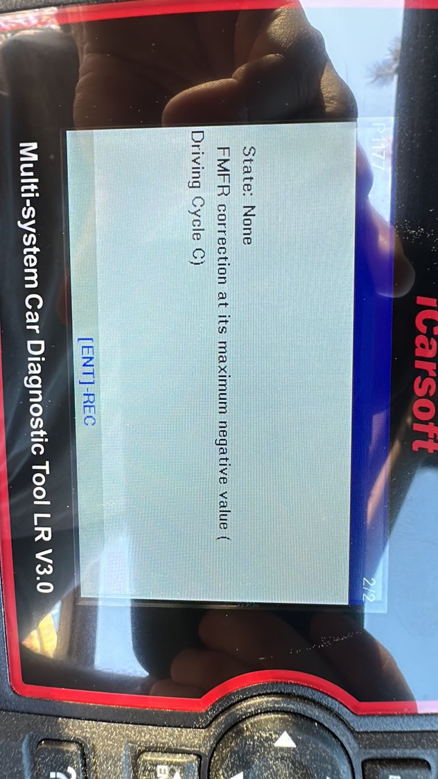

Ok so I got it plated today and drove it home from the shop. It’s running much better than when I got it but its way down on power and more than half throttle makes it angry
Junk iCarSoft LR scanner comes up with can’t talk to most anything but did give me this ”fmfr correction at its maximum negative value (diving cycle C)”. No P code but it seems to either be a P1177 or P1179. Most seem to point towards the MAF or needing to reset the adaptive. Of course this reader can’t do that 🙄. I’ll try the launch tomorrow back at the shop. It will run down the road doing 65 no issue but big hills are its enemy
Symptoms
1. doesn’t like to rev over 3k
2. Doesn’t like over half throttle seems to backfire
3. fmfr correction at its maximum negative value (diving cycle C)
4. Seems to be a lot of venting when you open the gas cap
Things done
1. Spark plugs old looked fine on burn but were obviously worn
2. Plug wires
3. Fixed vacuum leak by cruise control
4. New Air filter
5. Swapped MAFs no change
