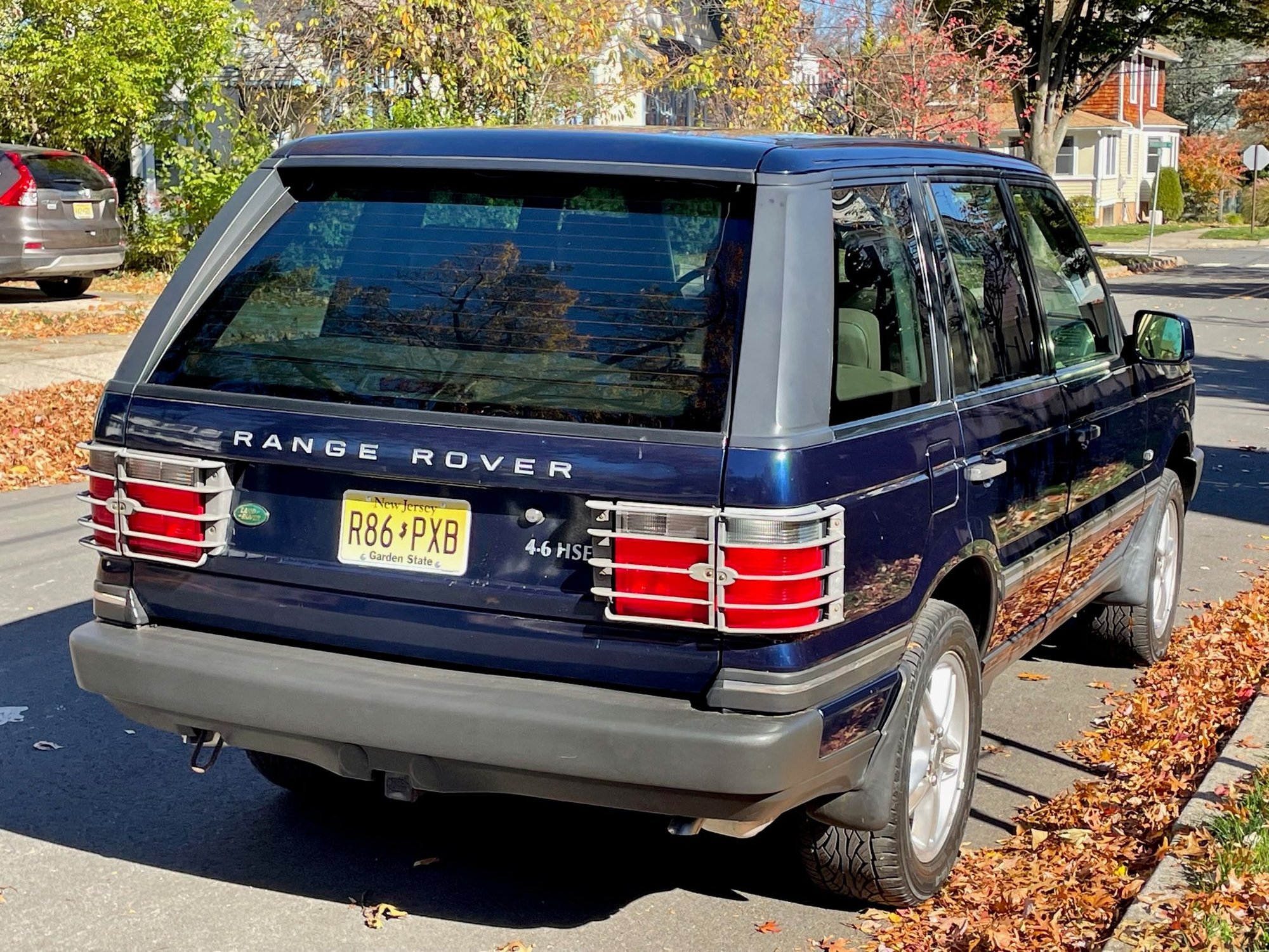

I acquired a 2001 P38 HSE 4.4 earlier this year and have a question on the air suspension. The car itself is beautiful, solid frame, Oslo Blue, tan interior, pretty much perfect, 9 out of 10, 1 owner car, 109K miles. When I bought it, the air suspension was shot along with some other items, but I rebuilt the entire system (and other stuff). New 3rd gen bags, shocks, dryer, rebuilt the valve block, new oem height sensors, pressure tested all lines and reprogramed the control module along with calibration the heights. Overall, the system works perfectly but after parking in standard height, after a few hours it drops down to access height. Not to the bump stops, but just down to access. Even after 3 days parked, just down to access. Is this a normal function per the control module? As much as love the car, it's coming to the time to sell it and move on to the next one. I don't want to sell it until its right if I need to look at this further.

PS welcome here. Nice looking P38. And it’s a 4.6, not a 4.4, at least per the marking on the tailgate.
Thank you! My bad-wasn't thinking it out while writing, definitely a 4.6. I just finished a timing/vanos job on a L322 so had the 4.4 on my mind. I currently have 5 Land Rovers (subject to change at anytime up or down) . I buy them, fix them, drive them and eventual sell them to support the addiction. I'm finding that as a driver, I'm liking the P38 best.
