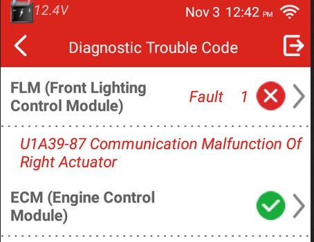

I got both lights seated and working......but.......now I'm getting the flashing adaptive headlight error light on the dash.
Pulled the code, pulled fuse #61, but the light is not going away.
At least I have headlights. Didn't know I have adaptive lights until now.
