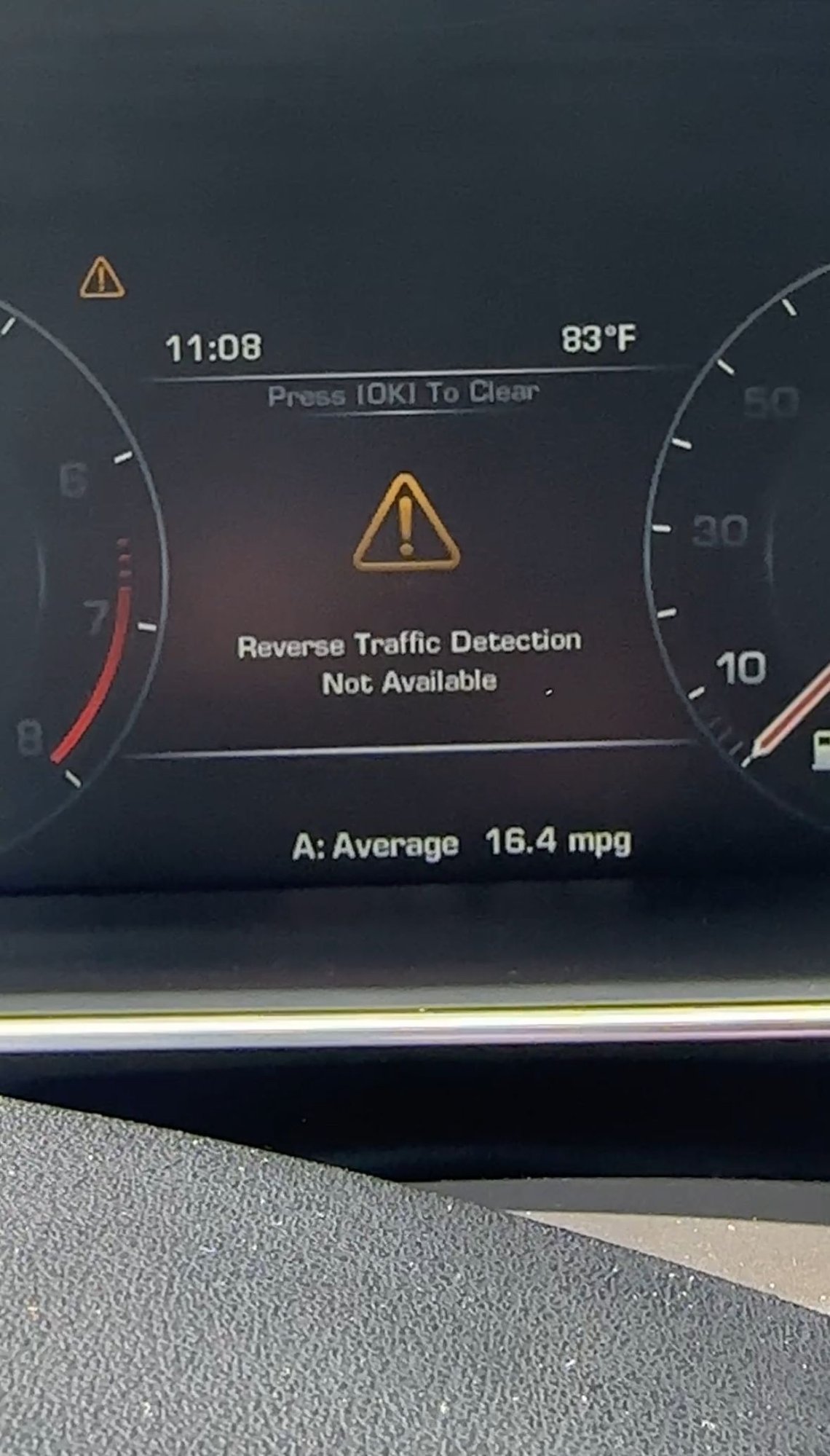

Hi everyone,
I’m having some issues with my 2016 Land Rover Range Rover Sport HST and was hoping for some advice or insights from the community. Here’s what’s happening:
  • A few days ago, the infotainment screen stopped working entirely. Normally, when I turn on the car, the screen would light up with the Land Rover logo, but now it stays completely black. Occasionally, it turns on for a few seconds but then goes black again.
  • The buttons on either side of the infotainment system don’t seem to function, though the button lights do turn on when pressed.
  • The steering wheel buttons (mode, volume, phone) are also unresponsive.
  • When I shift the car into Reverse, the rear-view camera does not turn on and a “Reverse Traffic Detection” message in the odometer area UI shows up
Some details about the car:
  • It’s a 2016 Range Rover Sport HST.
  • No accidents or exterior damage.
  • No flooding or other issues that could have impacted the electronics.
Has anyone experienced a similar issue or have any advice on what might be causing this? I’d appreciate any troubleshooting tips or guidance before I consider taking it into the dealership.
Thanks in advance for your help!

Hey Sansfly - in the end what solved it for me was disconnecting the battery for a few mins and then reconnecting. That seems to have reset the system and it started working again. Hope that solves it for you too!
