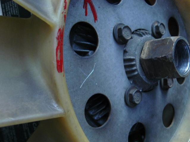

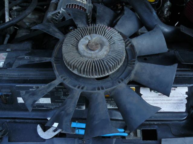

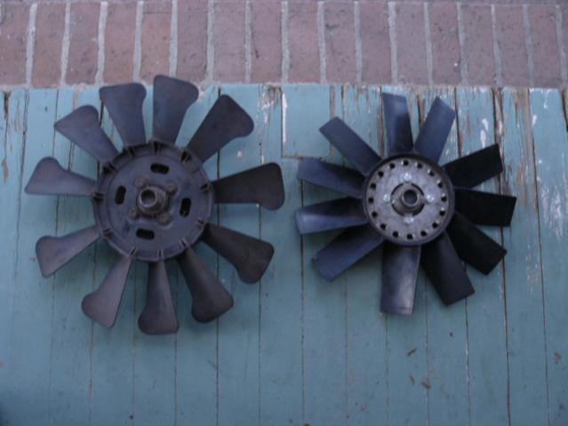

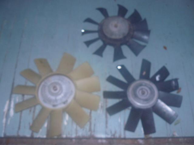

If all you need is the fan clutch, you can get that today at most auto parts stores - it fits a 2000 Chevy Express cargo van with the 4.3L V6 NO a/c. About $50. Write up on it in the technical area for the D1 part of the forum.
If you need a whole fan and clutch, dismantler or salvage yard would be a choice.
If you are tight for time, About $20 at salvage yard will get you a clutch and fan from a 98 - 2001 or so Chevy truck or Tahoe. It is a 6 inch, reverse rotation clutch that fits on the same water pump nut used on the Rover. Your neighbor will have to take a pair of snips or big scissors are CAREFULLY cut off just a little bit from each blade. A couple of examples are shown in the pictures.
Or you can remove radiator shroud and run fan as is, check clearances before shutting hood...., just won't do as well on really hot day, but should be OK this time of year. Being stuck away from normal support is tough, and these are intended as work arounds if what you want is not available or you don't have time to wait on factory parts.
