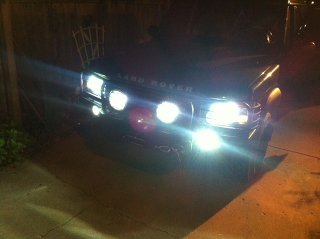

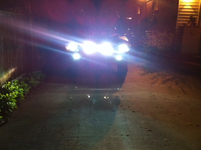

My larger project that took about 12 hours to complete. I wired up using a Factory Land Rover Harness my Land Rover Driving lights. I bought a range rover wiring harness as I thought they would be very similar. After reading through the instruction. I mean looking through Ikea instructions for 6 different international languages several times. I opted to skip wiring through the fuse block or ECM way. I did a straight to the battery using the supplied Tyco/Bosch 30amp relay and 15amp fuses between the switch and positive wires. I had a factory LR switch and one blank left on my binical on the dash. Installing the switch was a breeze. As I was able to fish the wire through with out removing the instrument cluster. I used the same opening in the rubber boot that I ran my oil pressure guage wire through. I had to add about 4ft to the switch wire to get it to install right behind the battery box. Man wiring takes forever, when you test everything.... then run it. It was also 110 degrees heat index on Tuesday. The next afternoon I had the lights wired up and then installed H1 5000k HID bulbs to match my Fog and headlights. It was a trick to find a good place to mount the balists under the grill with double sided 3M auto tape. But it works. They are super bright and are not switched off by using high beams. Totally independent switch. Wow that was a novel. Here is the basic diagram I used to install the wiring. 2nd option down on the page. This is my most complex wire project to date. Now I'm ready to film a Outback commercial!

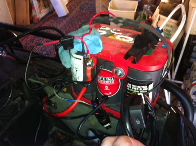

Testing wiring harness on battery separate from car's ground points, using relay and factory switch provided with harness.

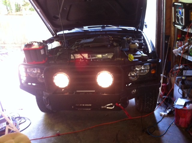

Bam lights turn on and off with switch. Time to run wires and secure them.

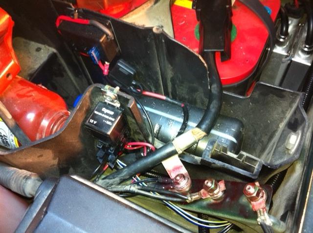

Relay nicely mounted to back side of battery box. Wires all tucked in and used provided ground points sprayed with non corrosive battery spary.
