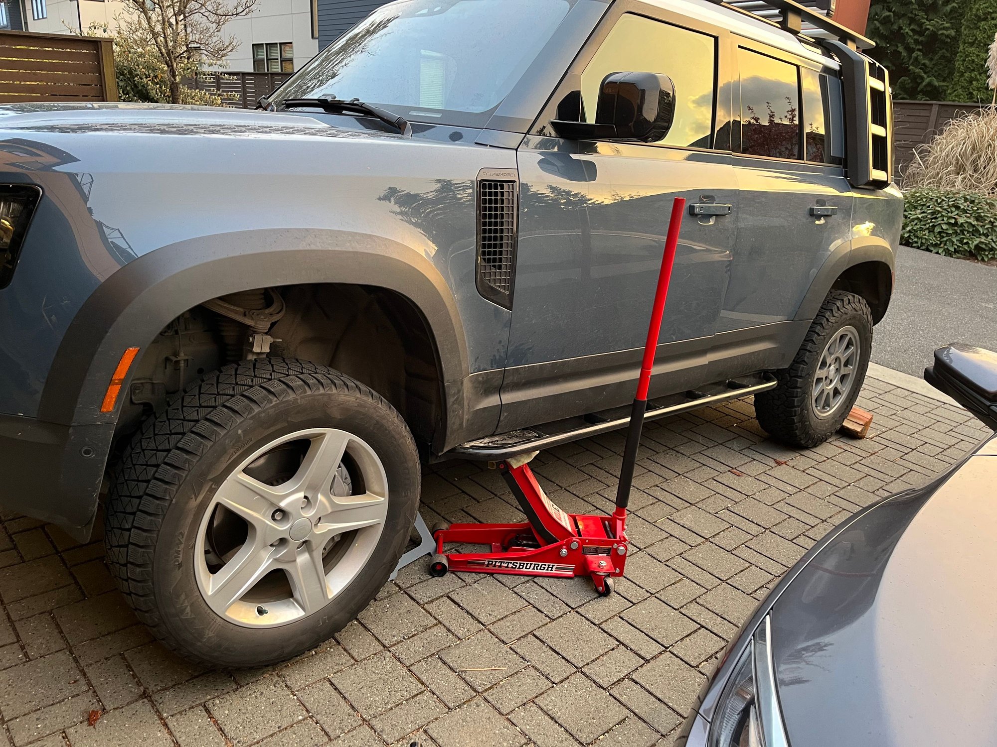

Very handy being able to Jack on the sliders.
Out with the Blizzaks on the OEM 20”s

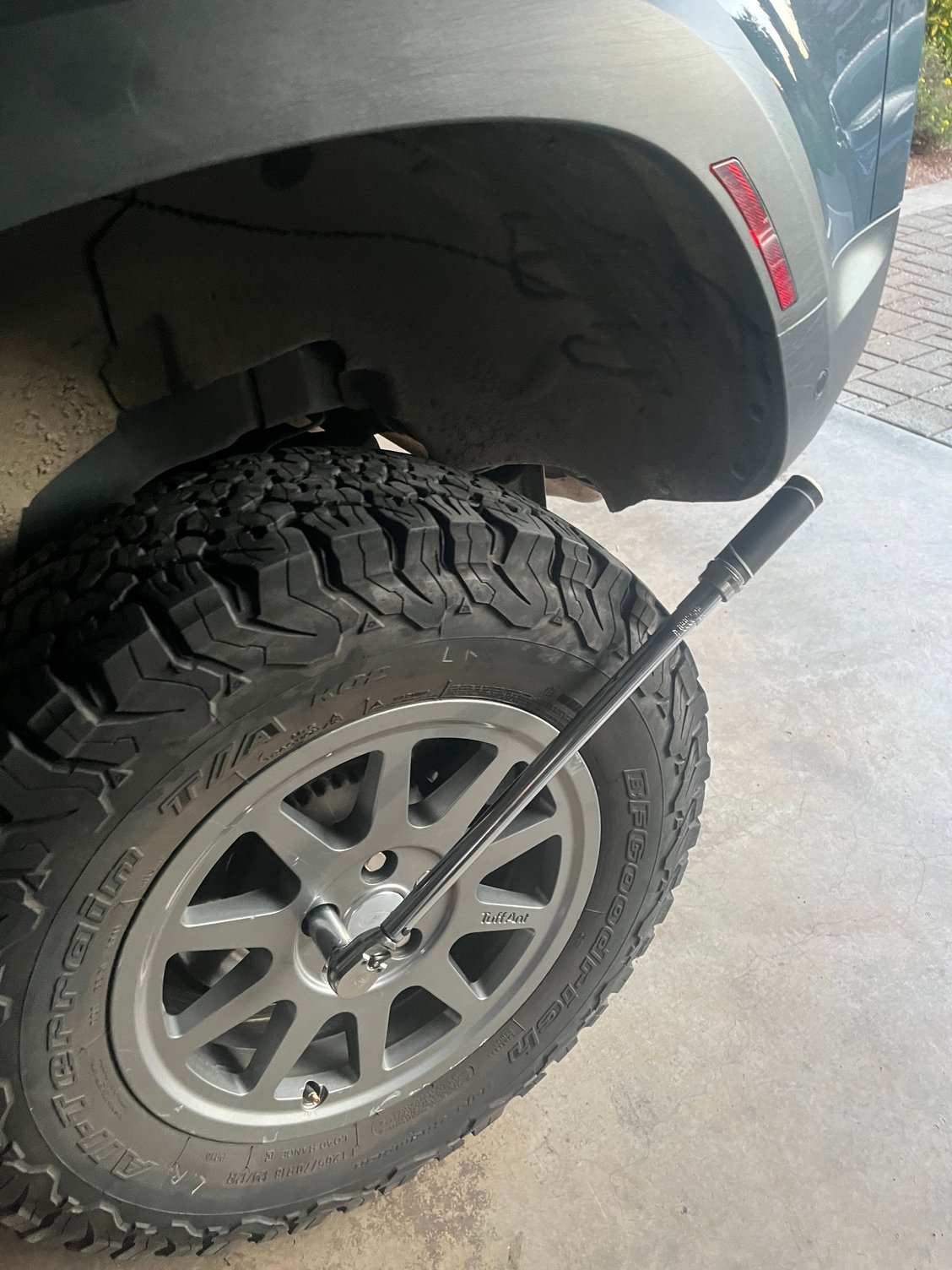

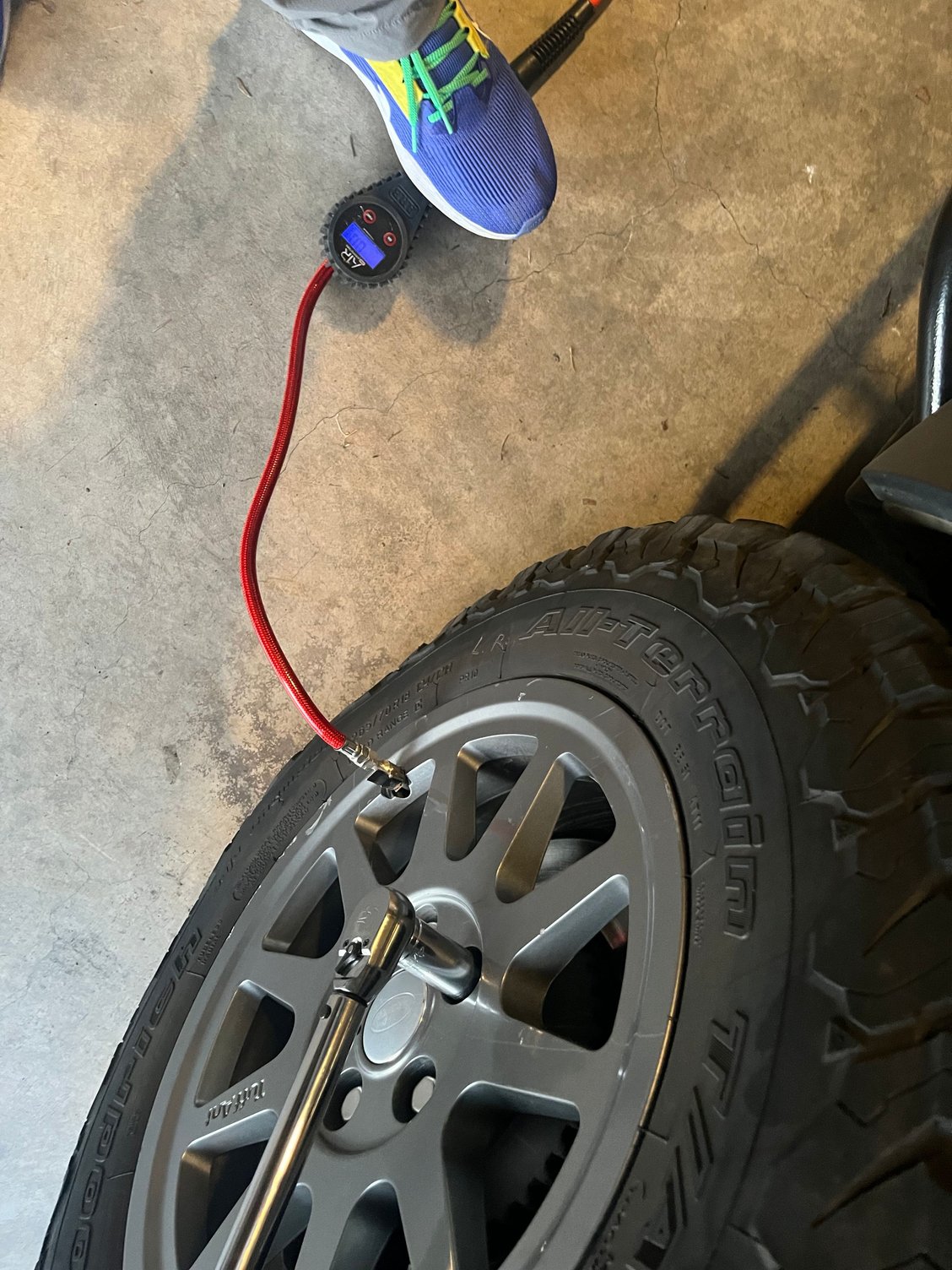

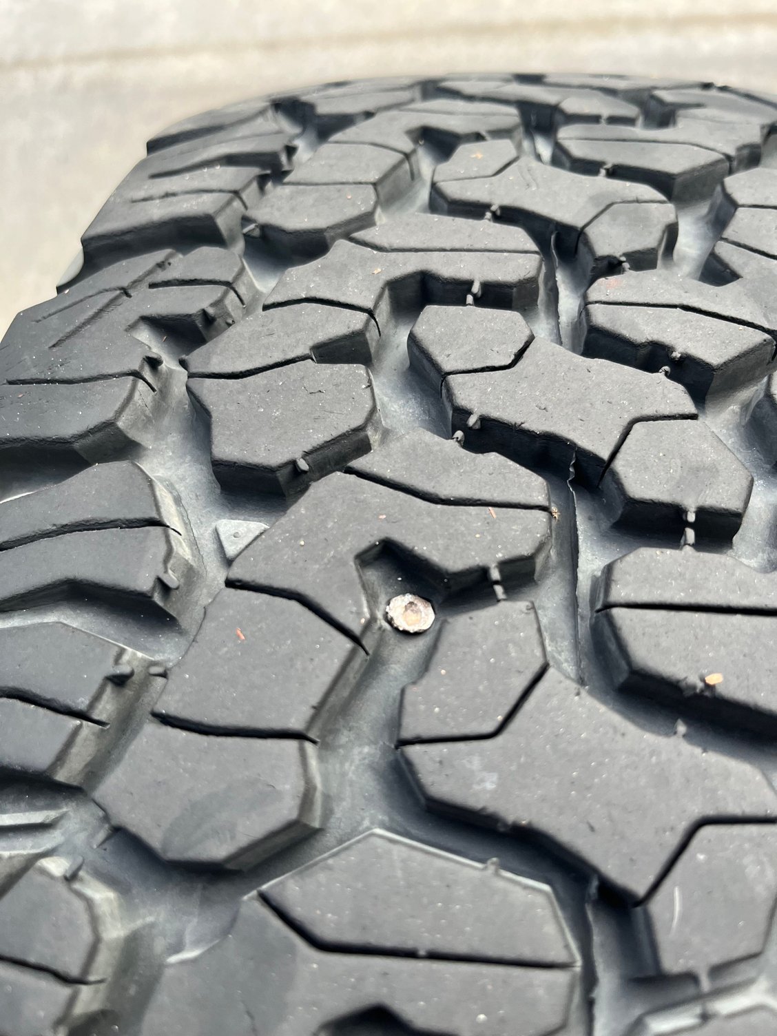

A puncture
Spike out
Plug trimmed. Good as new.
140 Nm
Plug reamer and insertion lance.
40 psi

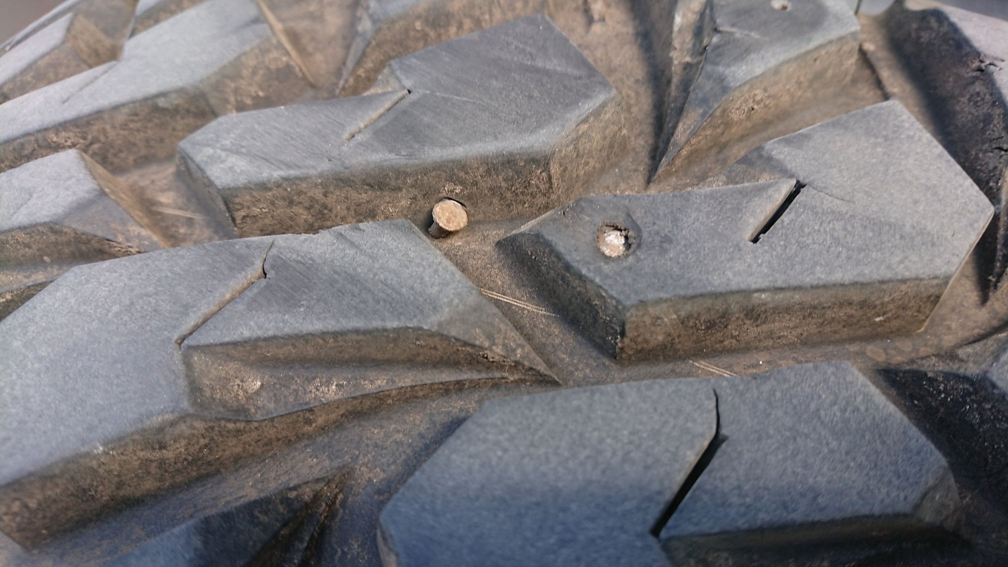

@GavinC one nail could be just bad luck..
Two nails in the same area came def. from some environmentalists , happened to me on Boulder Lane in Wales.
Old Jul 13, 2024 | 12:15 AM
  #89
GavinC's Avatar
Joined: May 2021
Posts: 2,593
Likes: 3,692
From: Kirkland WA
This leak has been in there a few weeks. I've been topping up the tire every week or so. No environmentalists involved. or so they'd have me believe.
