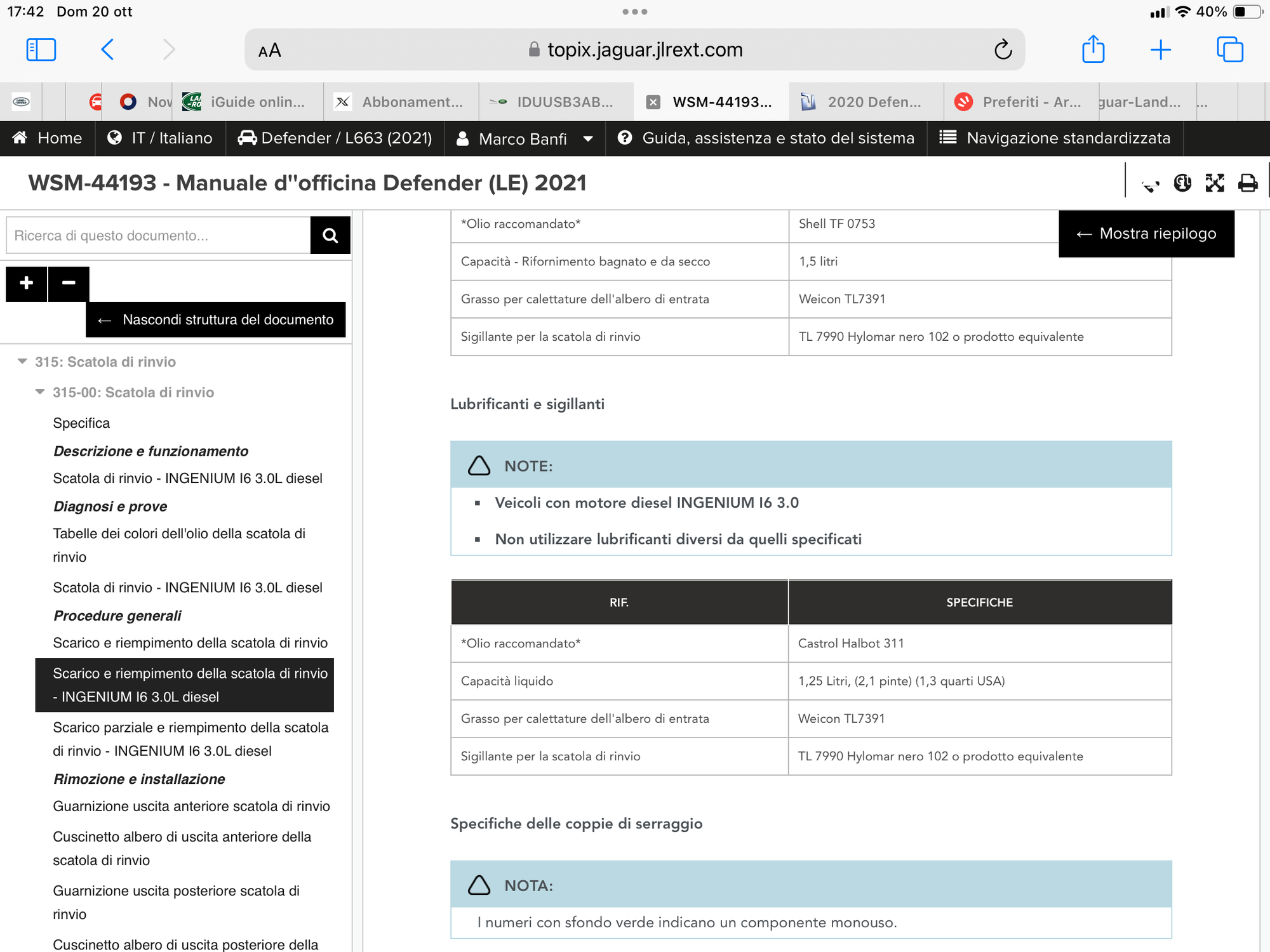

hi,
it should be 1.25 liters.

@mmbanf Superb info Marco. I couldn't find that info in the workshop manual. Thanks very much. My 2 quarts will be ample.

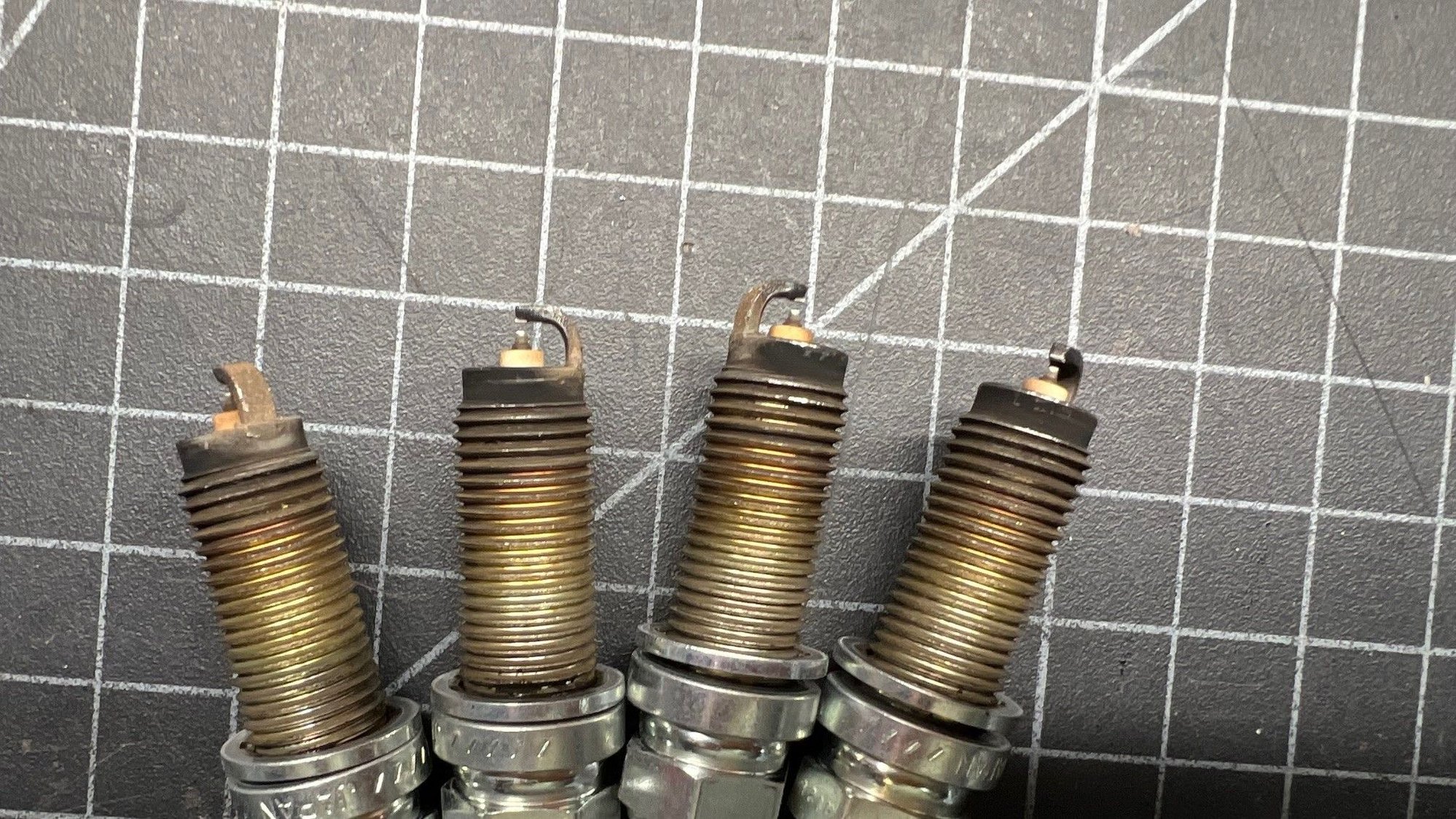

I did my plugs at 50K-ish on my 2022 P300 110 S. I did not have to put anything into a service position. It was very straight forward, just tight clearances for the socket on the plug near the bulkhead/firewall...used a very thin walled 14mm spark plug socket...the one I bought was for BMW. The gaps were way off from the factory for the ones I removed and the new ones installed.

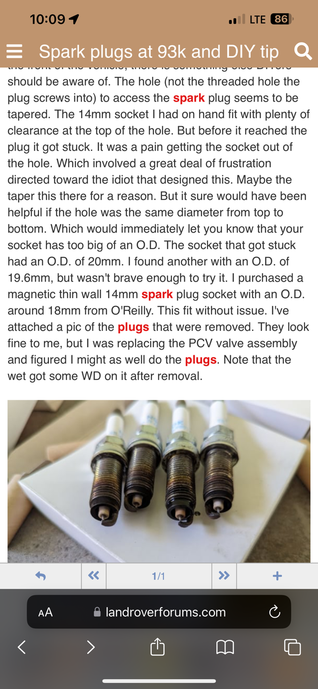

I got myself a narrow walled spark plug socket. I will try getting access to the plug nearest the firewall first. It will be the tricky one. LR do mention a special spark plug socket in their manual. It looks tapered in the pictures.

I did had to gap the new plugs myself and used the Lang 4450A Spark Plug Ramp Gauge to set the gap...they were way off and not consistent between them.

Ended up using two socket universal joints and extensions between them to get to the plug near the firewall.
