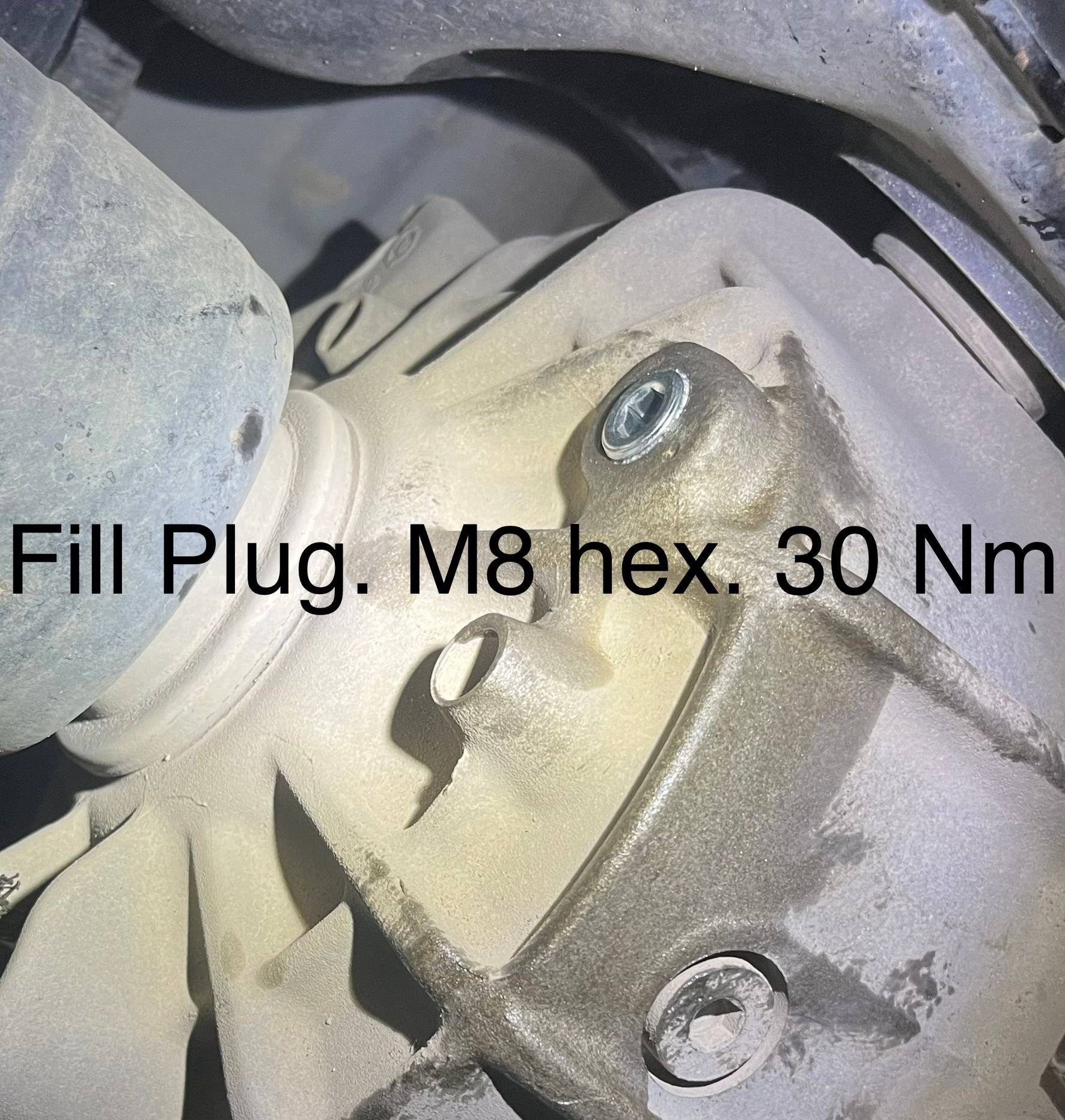

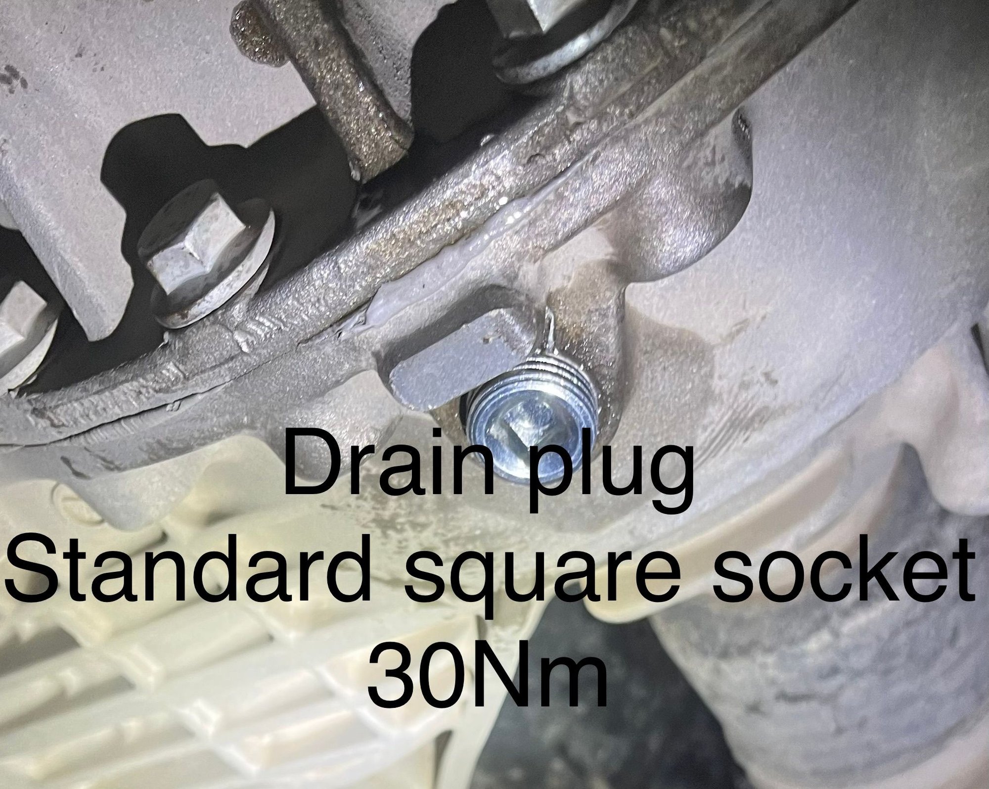

As tasks go, this is as simple as you’d like
I am glad to have done this change earlier than the 63000 prescribed mileage
very dark thick diff oil
Sludgy black diff oil
This is the fill plug
Metal shavings are minimal.
Gap tool and Trax getvyoubplentybof room to work
Gap tool and Trax get you plenty of room to work
Next up is the transfer case.

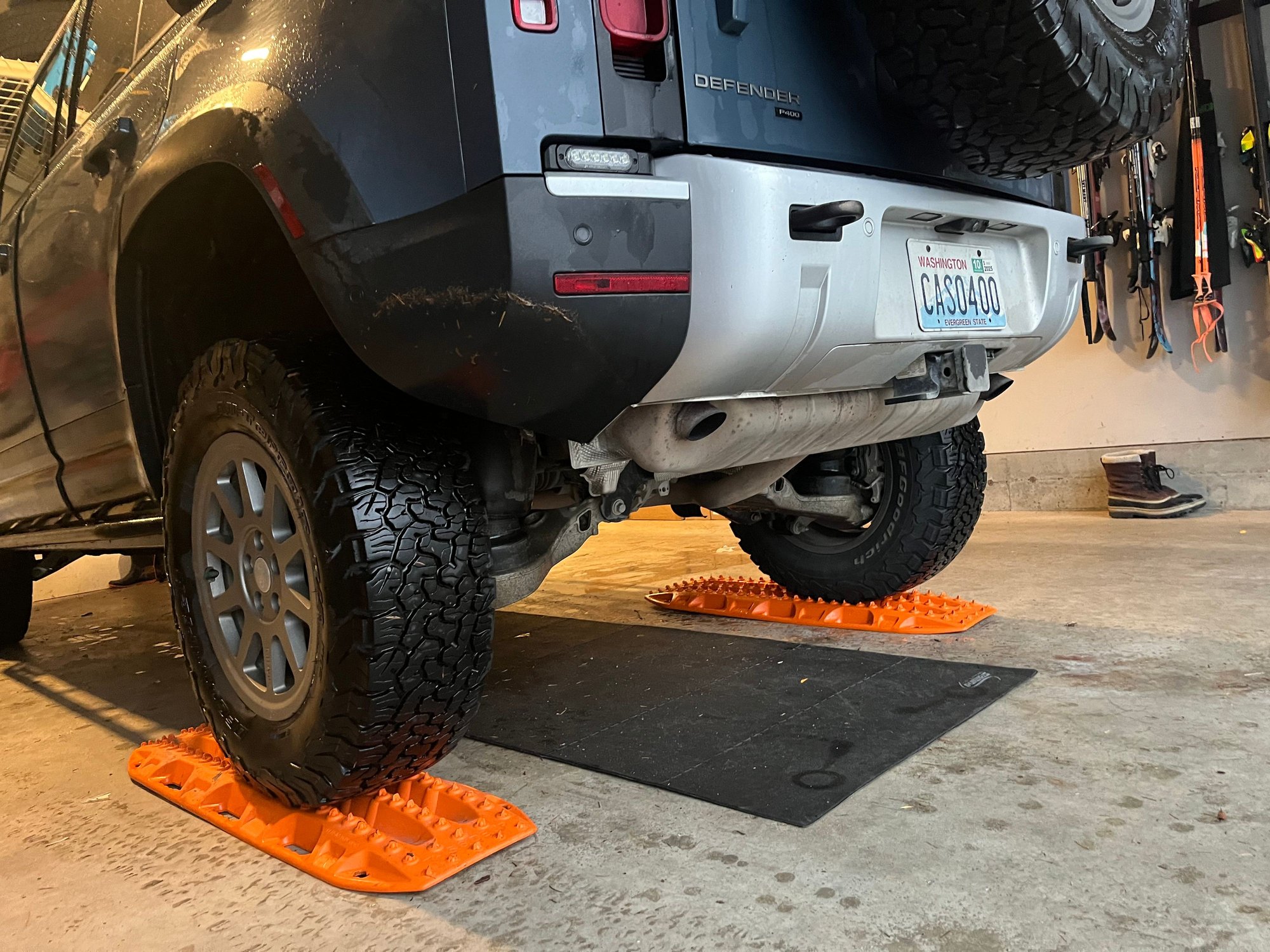

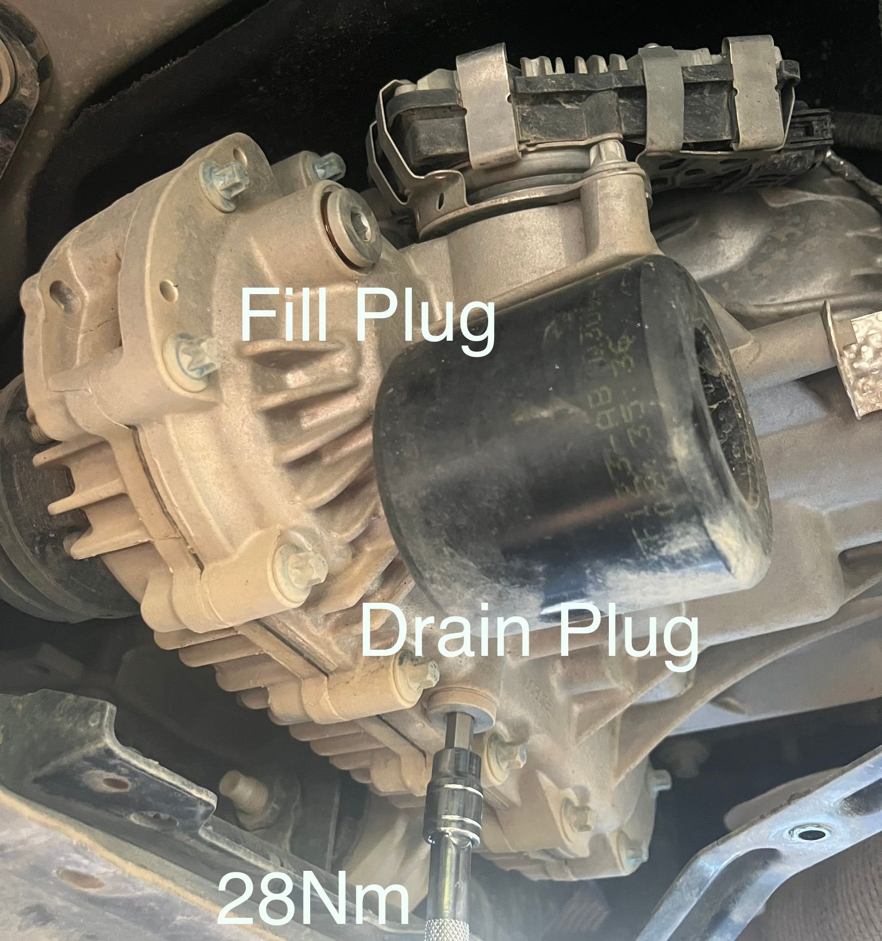

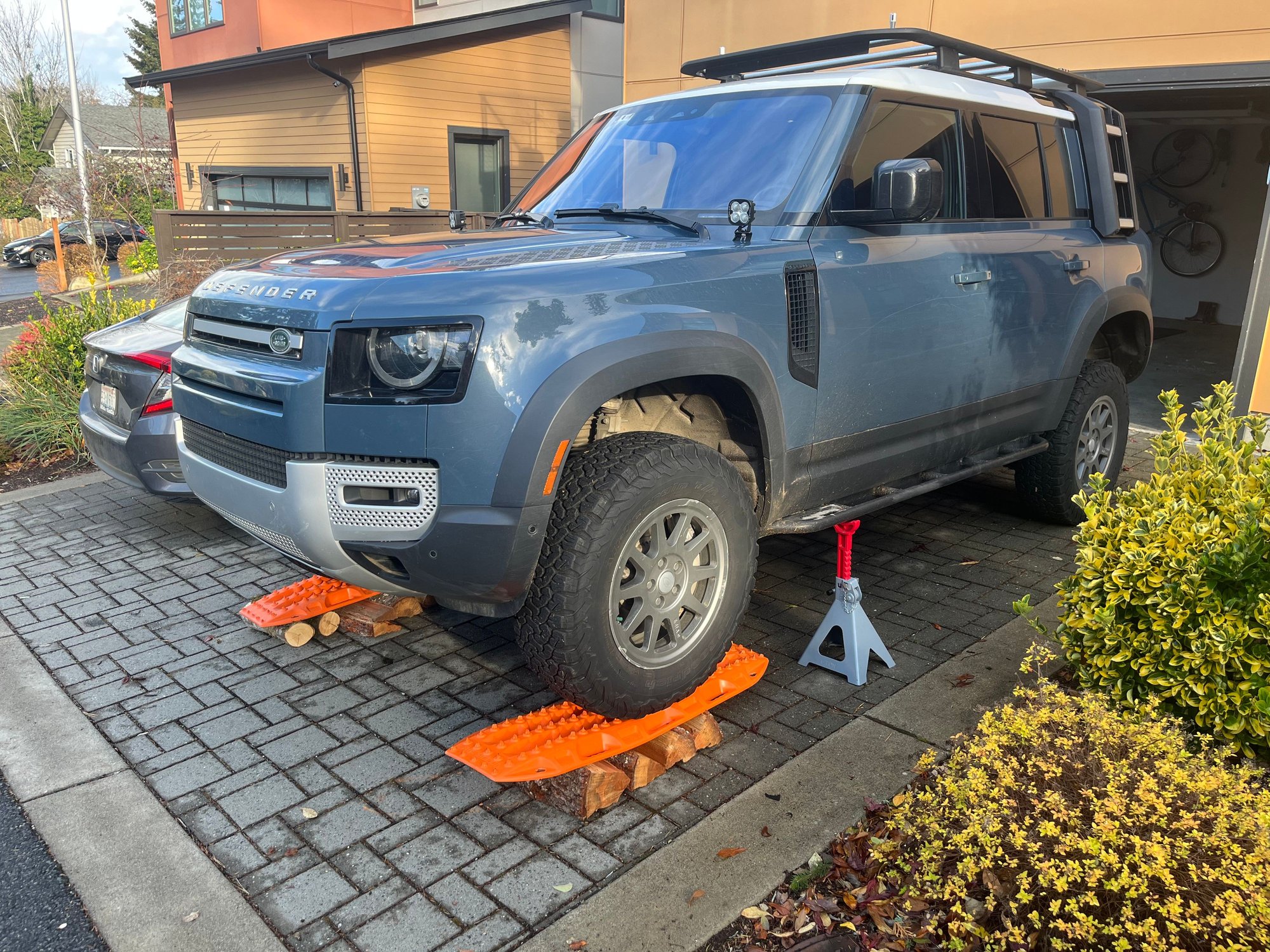

  • Lift the front end and chock the rear wheels
  • Pop off the undershield
  • Partially remove the left underfelt
  • Remove Fill plug
  • Remove Drain Plug
  • Drain transfer case
  • Replace crush washer and tighten drain plug to 28Nm (21 ft lb)

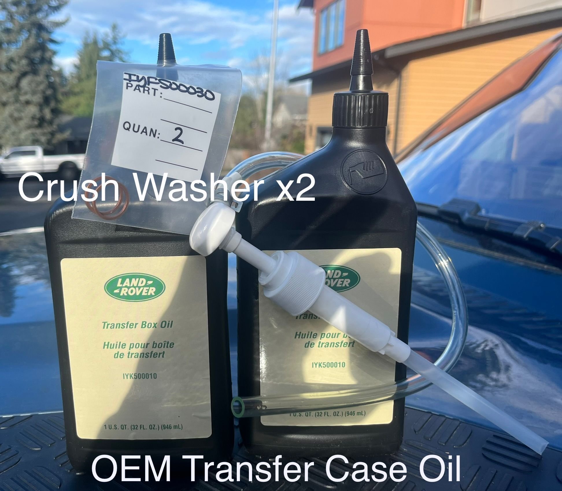

  • Fill transfer case with correct fluid. I used OEM
  • Replace crush washer and tighten fill plug to 28Nm (21 ft lb)
  • Reinstall felt
  • Reinstall undershield.

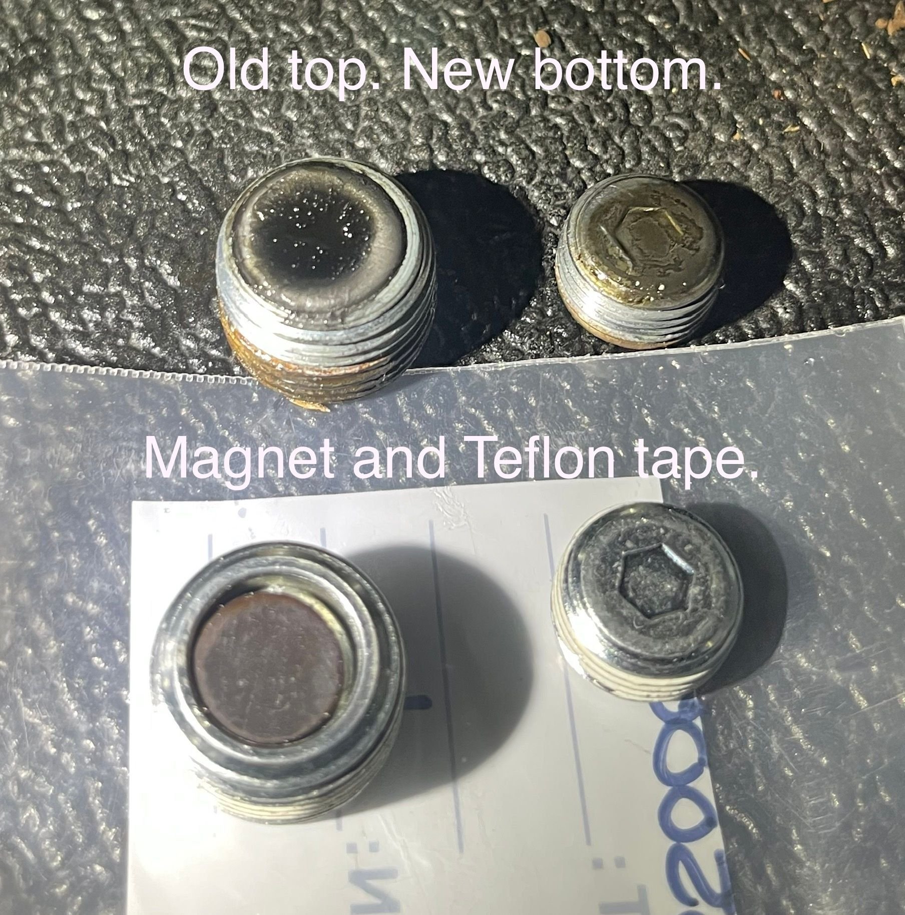

OEM fluid. Incorrect size crush washers from Landleaping.com Reused the old ones, much to my chagrin.
Hex socket on drain and fill plugs
Transfer case
Transfer case
Lift and jack stands as a fail safe.
