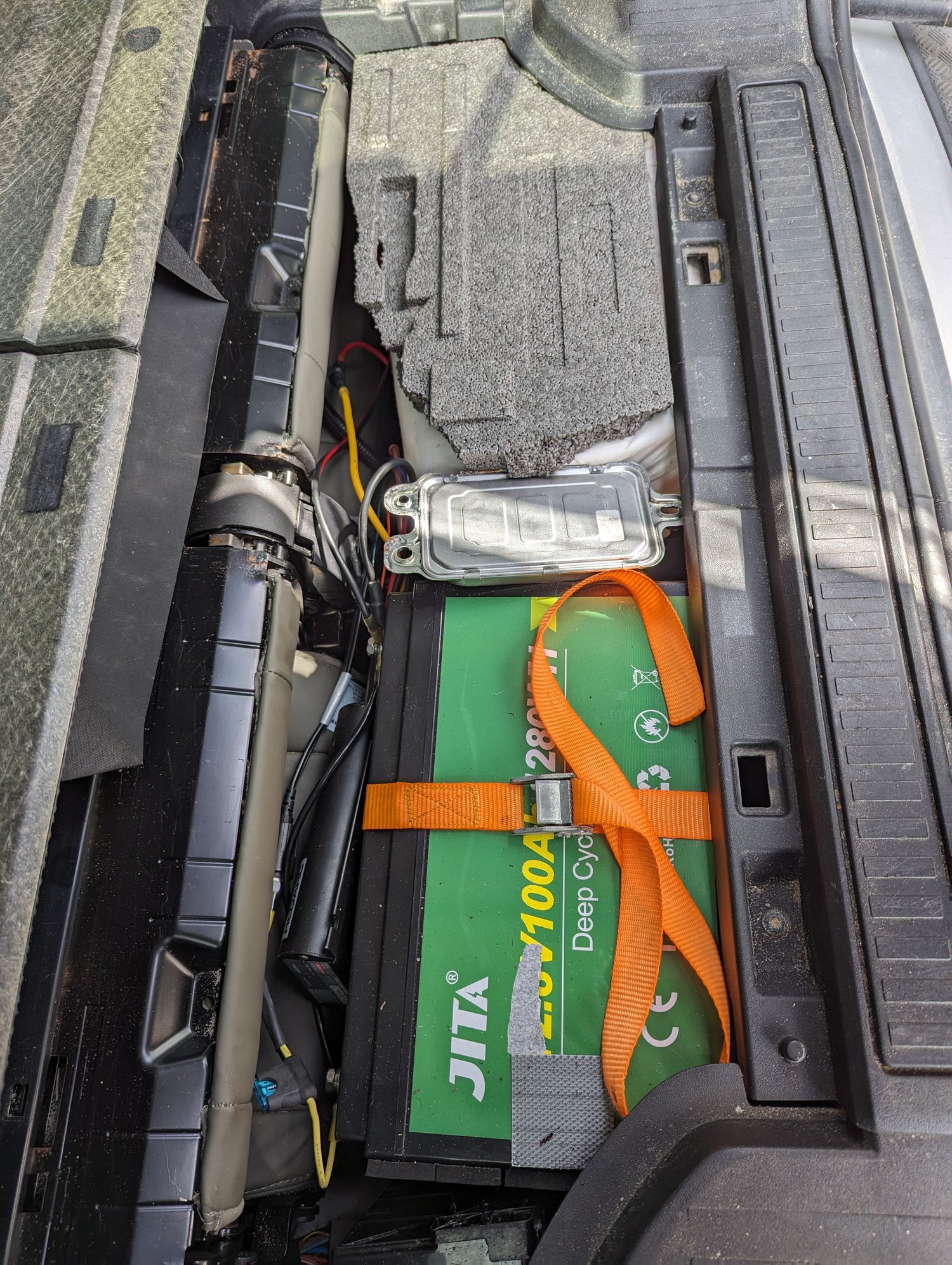

I took mine out (7-seat P300), but I don't recall exactly how did it. I think I just pulled the corners around the plastic interior trim that overlaps it. If you fully remove it, you will need something to support the folding floor piece. I ended up precisely breaking my foam piece in half and putting the piece that covers the air compress back. The side where the jack was stored is a lot of space. There are some electrical modules on the floor under the foam. I built a small plywood platform that bolted to the floor to cover the modules and was able to cram a 100a lithium battery and redarc bcdc in that space. See photo. Please ignore the messy wiring and dirty interior. Also, that metal silver piece withe three bolt holes was bolted to the floor where the battery now resides. No idea what it is, but never had to unplug it when relocating.
