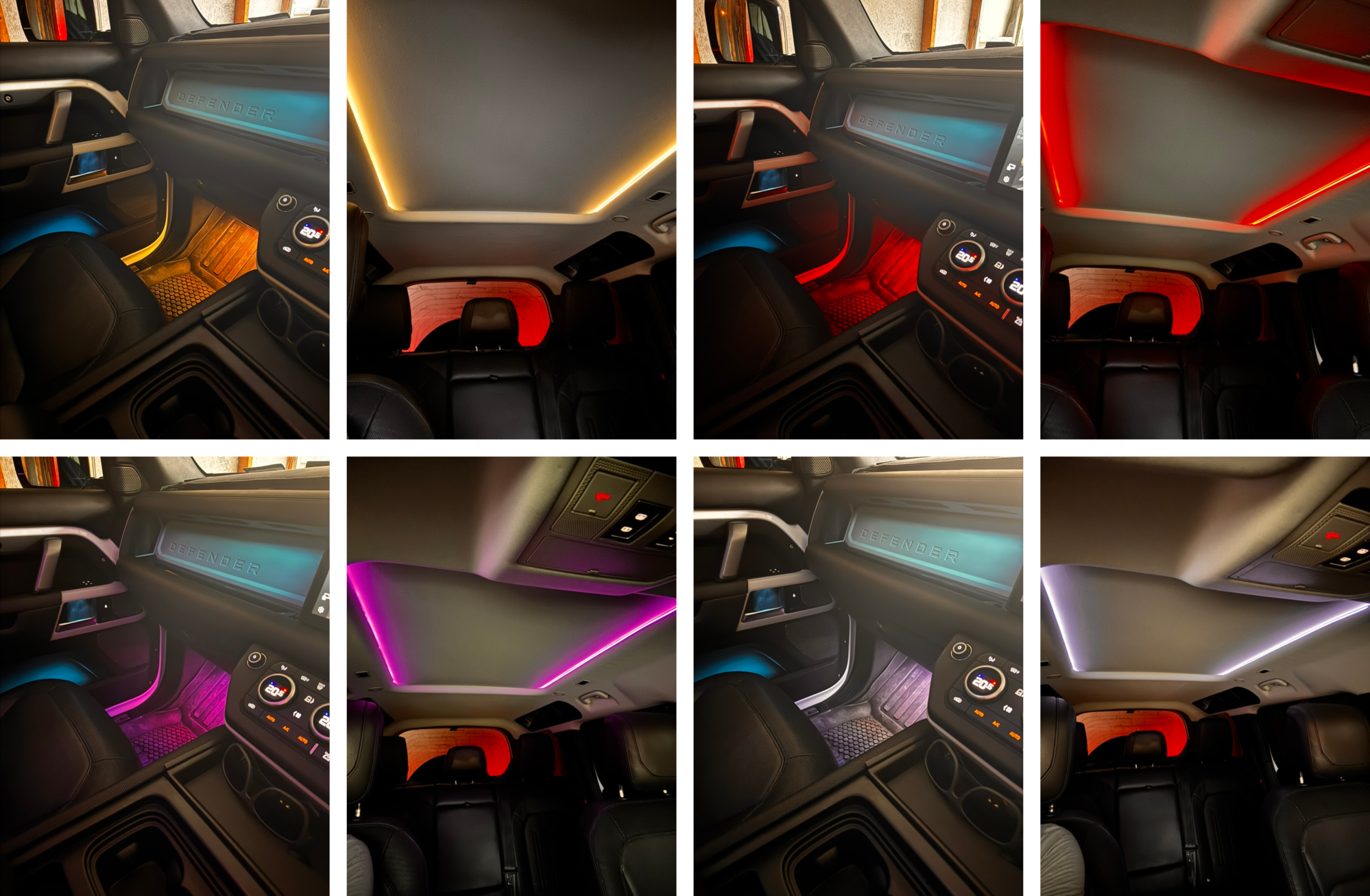

I had some ambient light hardware left over from a past project so decided to up the interior lighting game on my Defender 110. Added RGB footwell lights front and back as well as acrylic LED strips lengthwise either side of the sunroof.
These lights are controlled from an app on my phone which allows me to create a layered lighting setup when combined with the factory ambient lighting. For power I tapped into the same wiring already in place for my dashcam (passenger side fuse panel and ground point) though another option would be to power it from the dome lights using an adapter (like the ones sold by PowerfulUK.com.
Very happy with the result and super easy to install too!
Footwell lights (symphony footlights option): https://tinyurl.com/l663-light-1
Controller and roof lights (symphony wire option): https://tinyurl.com/l663-light-2

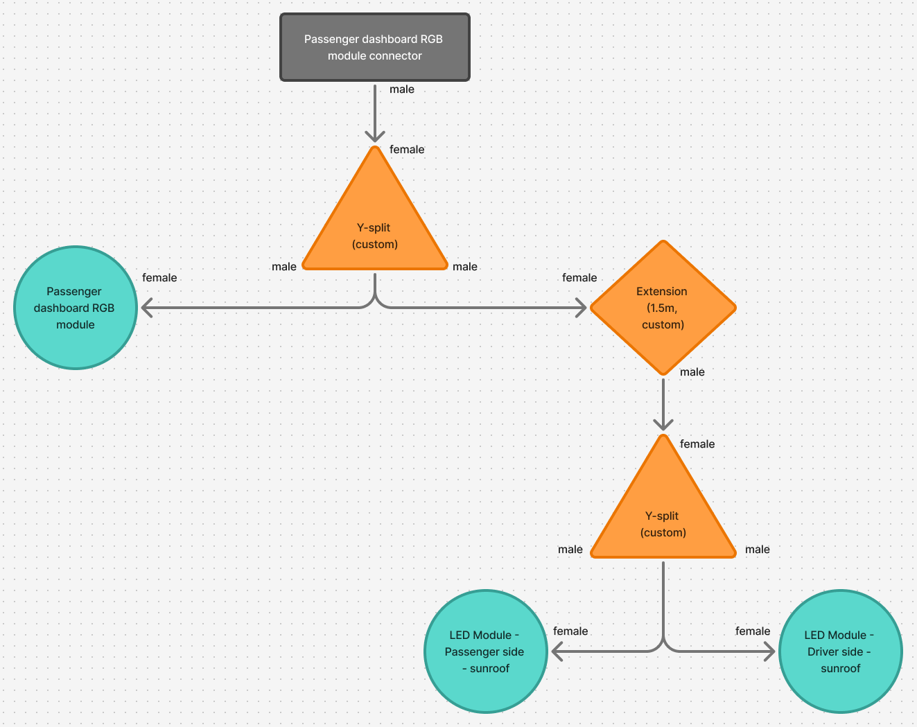

UPDATE: I decided to do a V2 of my extended ambient lighting mod. I used Land Rover OEM LEDs and VW optic guides for the lighting. The optic guides are made of ultra thin fiber optic threads wrapped in an opaque white sleeve. They have ****** ends identical to the fiber optic guides used in the Defender so they clip into the LED modules perfectly. I fabricated a splitter wire harness using OEM connectors and ran it from the ambient light in the top of the passenger-side dashboard, up the a-pillar, along the windscreen and through to the sunroof. Entirely plug and play 🙂

1. Create 2 x y-splitters with one female (to connect to the car's wiring) terminating in two male connectors
2. Create a 1.5m extension cable male to female
3. Route the extension from the sunroof (middle front) above the overhead console to the front of the headliner, female end
4. Tuck the extension under the headliner to the passenger side a-pillar cover (removed)
5. Route the extension cable behind the a-pillar cover to the passenger side dash trim (metal cap, removed)
6. Feed the extension from the passenger side trim to where the LED connector is located (underside cover with LED optics of passenger side dashboard removed)
7. Connect your first y-splitter to the car-side connector, the dashboard LED module to one of the male ends, and your extension to the other male end
8. Connect your second y-splitter to the male-end of your extension cable
9. Connect the two additional LED modules to the female ends of the second y-splitter
10. Test for functionality. The dashboard LED and the two additional LEDs should light up with the same colour
11. Connect the ****** ends of the optic guides to the LED modules
12. Secure to side of sunroof frame, below the guide for the retractable shade, using automotive mounting tape
13. Secure led modules to car frame using automotive mounting tape to prevent rattles
14. Test sunroof retractable share for unobstructed operation
15. Reassemble
