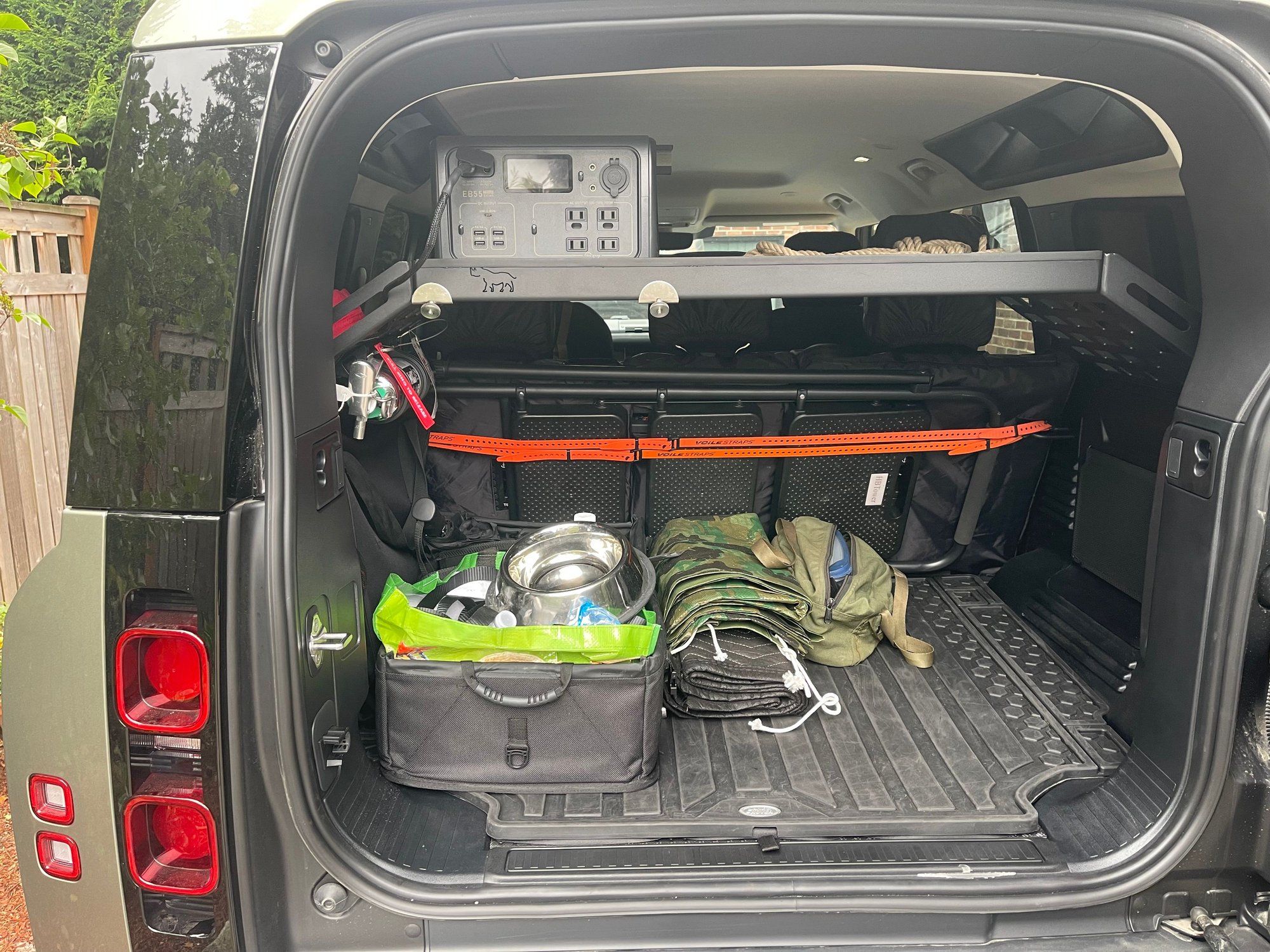

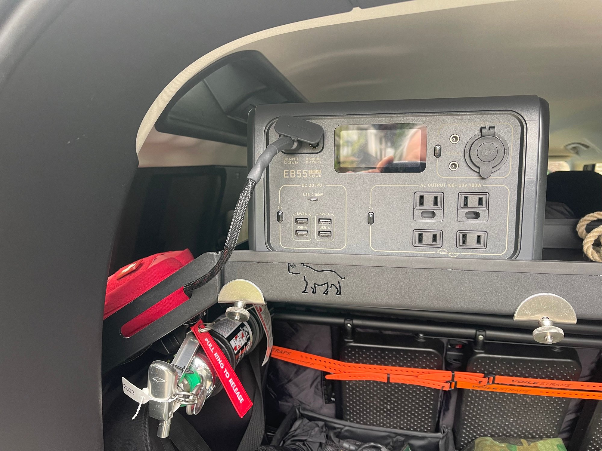

Here’s mine. It’ll run a TV for a whole weekend if need be. No solar panels required and no threat to the battery.
what shelf is that…?😳

It’s a rhino cargo bridge. I got this one from Lucky 8.

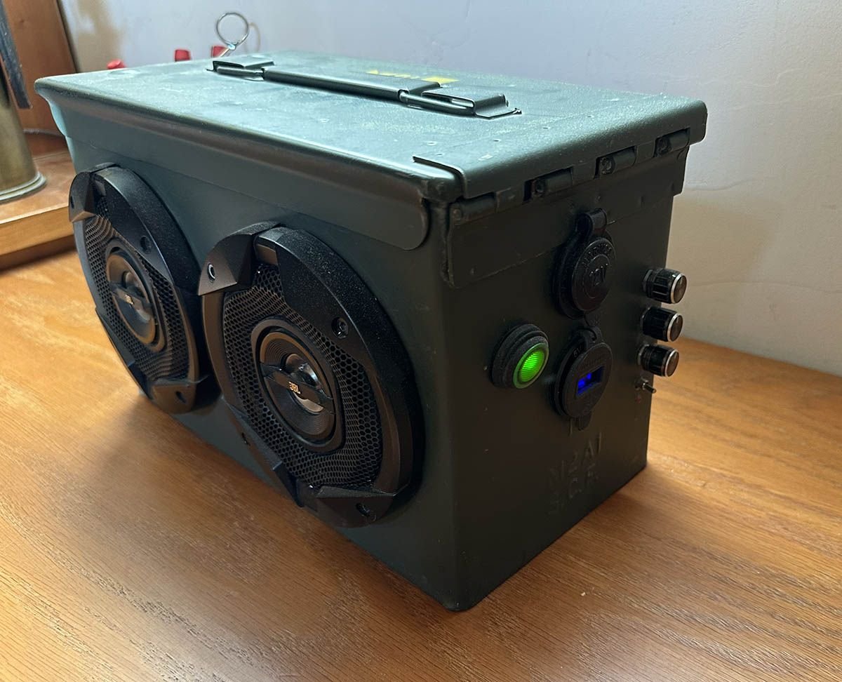

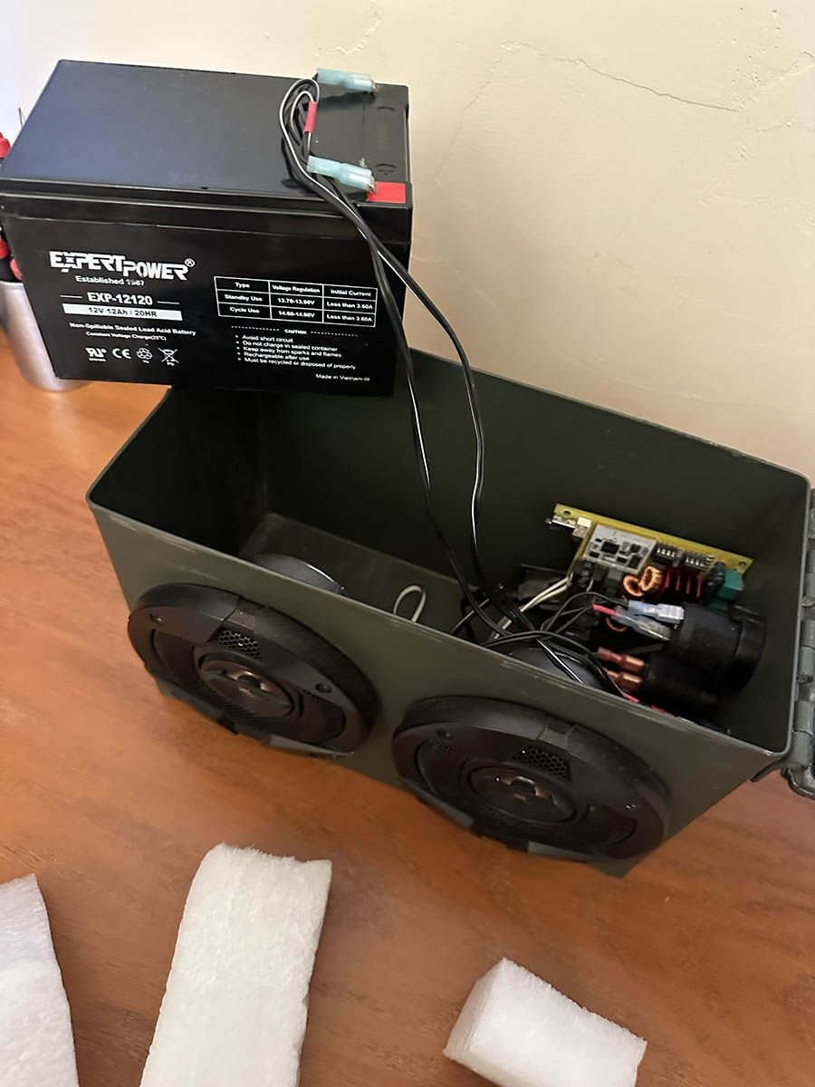

I have a similar LiPo battery generator. I just use one I made more often for a variety of reasons. It is much smaller, stupidly cheap to make and doubles as a surprisingly great sound system, both bluetooth and wired. It consists of an ammo can, a gel cell battery, two decent speakers, a bluetooth amp and a couple of USB surface mounts. I actually added one more that does much higher USB-C output than my original, which also display voltage. to use AC, just plug any old inverter to the 12V socket it has, which doubles as a charging port for the system via a double headed plug. It actually lasts quite a long time and is compact and...as tough as an ammo can can be. I even used it as a sound system for Rick and Morty Theatre at Renegade Burn. We had a projector system that displayed a 15' projection on the playa and this box did the sound for, what turned out as, quite a crowd. Lasted all week.
