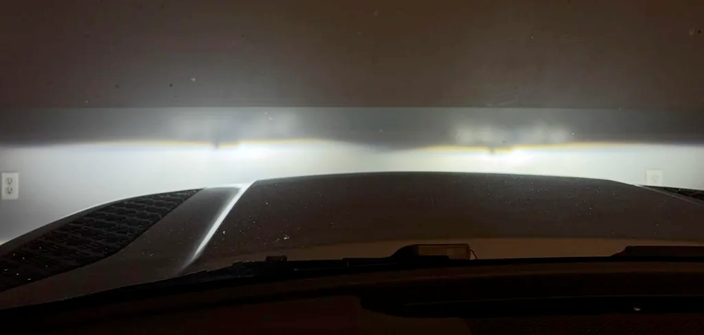

I had my passenger (rightside) light replaced due to DRL failure, and i think it might be a tad too low, keep in mind this is only a foot away from the garage wall... Anyone got any pics of how theirs look? The adjustment seems easy enough, apparently there are two screws to adjust height/horizontal level. Thanks!

Take it back to the dealer who replaced it if you are not happy with the alignment of the light. Looking at the picture you posted, it appears to be fine, in my opinion.

If you're on air suspension, the headlights are auto-leveling. If you're on coils, they aren't. That looks right to me, but I'll have to double check when i pull in my garage tonight.

ok so i think something is definitely wrong, at night i see two cut off lines as if they are not aligned, and passenger side one is always lower, sigh...so frustrating because this was a headlight replacement done by JLR dealer here, seems they can never get anything done right the first time. I'm going to see if I can adjust the cut off manually otherwise it's going to be more time at the dealer

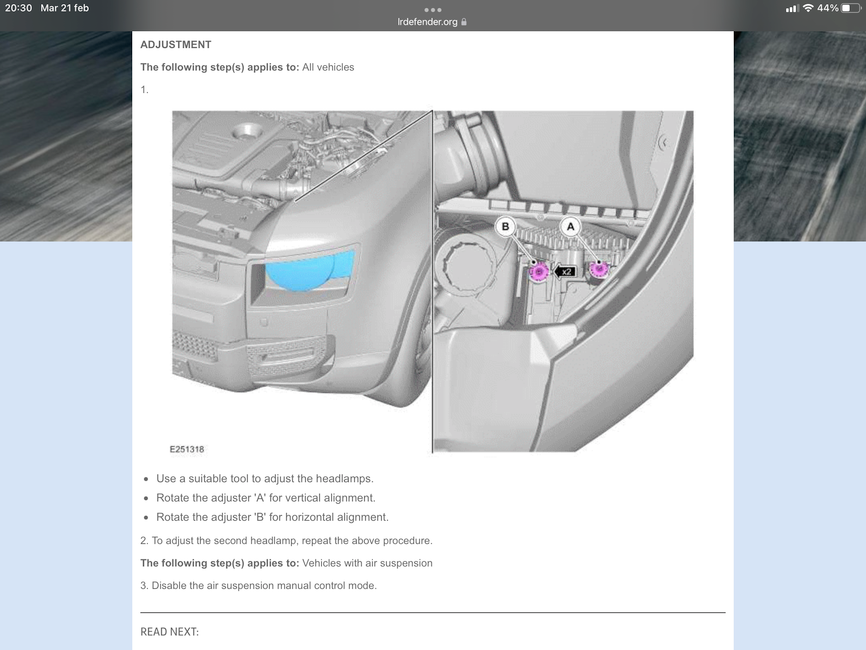

update: i was able to adjust the height pretty easily with the ***** on the headlight found here, also I have air suspension but manual adjustment was needed
