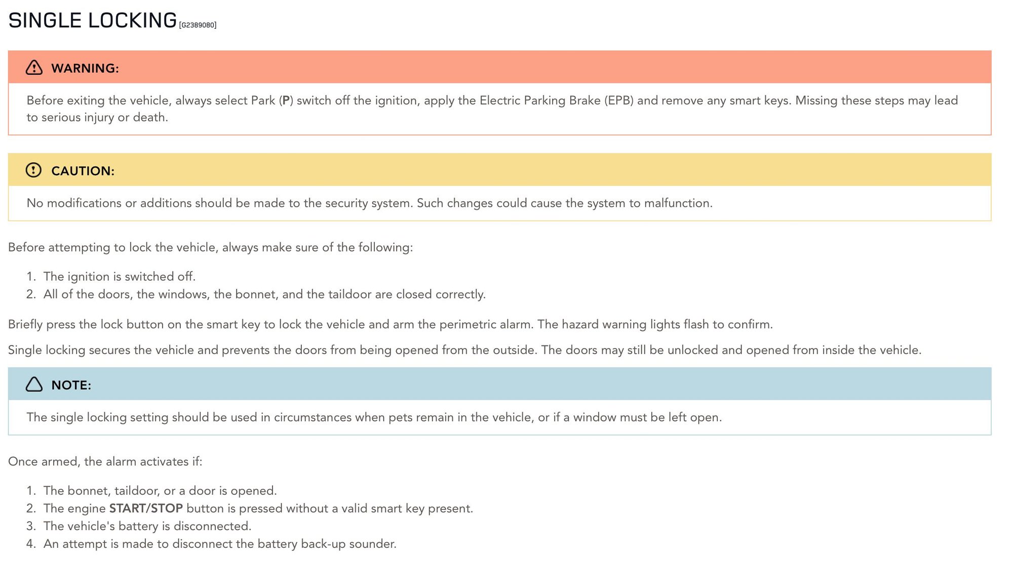

From the manual:

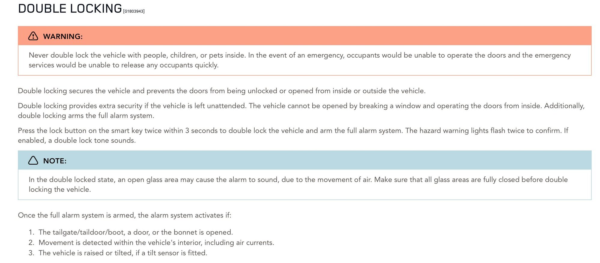

Check your CCF first, in Europe and some more ROW regions the single lock activates everything
When the vehicle is single or double locked, the alarm sensors arm.
The alarm sensors comprise: A tilt sensor to detect if the vehicle is titled or raised.
An interior motion sensor to detect movement within the vehicle.Prior to setting the alarm,
the sensors can be overridden for one alarm cycle via the touchscreen as follows:
Touch the settings icon.
Select Vehicle.Select Safety and Security.
Touch the Alarm Sensors toggle to switch on or off.
Multican 563 -AlrmSensonSingLock = Alarm sensors on
Changed in = No Alarm sensors on single lock.
So doggie can sit in the front of the car with Windows open shortly, no more alarm and phone calls from InControl.
