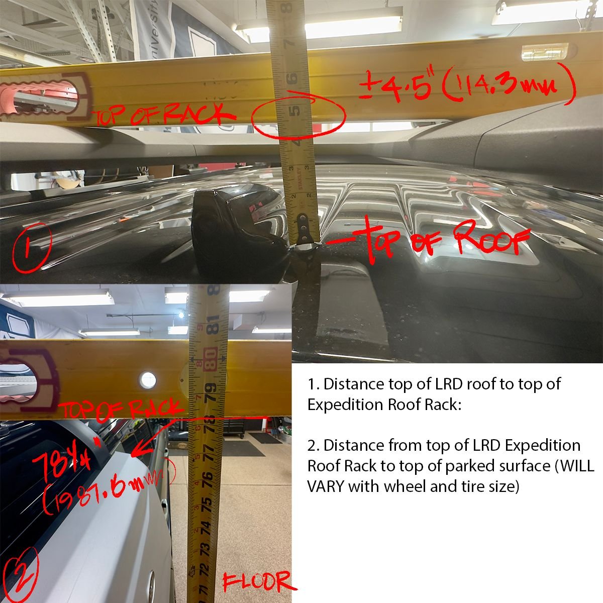

It took me a bit of time to read the comments on those videos claiming the extra height is 4.5", and further to find this image (original credit). Thanks a lot for the seed.
The +67mm is quite a bit more than my own measurements at +53mm but both are in the same ballpark,

I did a deep dive into this before buying too. Short version is when the my 110x with stock 19” Goodyear DuraTracs is in ACCESS height it cleared easily WITH roof rack. It would ALSO clear in REGUAR drive height. My garage max height to the door trim 83 1/4” (2.11m), and this obviously varies as does the open adjusted height of the door
1. Distance top of LRD roof to top of Expedition Roof Rack: distance noted will vary depending on where on a roof ridge one measures. The measure meet it then at the lowest roof ridge feature.
2. Distance from top of LRD Expedition Roof Rack to top of parked surface: This dimension will obviously vary with wheel and tire size. Dimensions shown to ground are with new, 18” BFG KO3 265/70 installed. This is obviously the critical dimension
3. Obviously garage door clearance varies with home/garage. I did have my garage door opening height adjusted so it cleared the external garage door trim.
Basically I”ll never hit the door itself - the door trim isn’t safe but easily replaceable.
