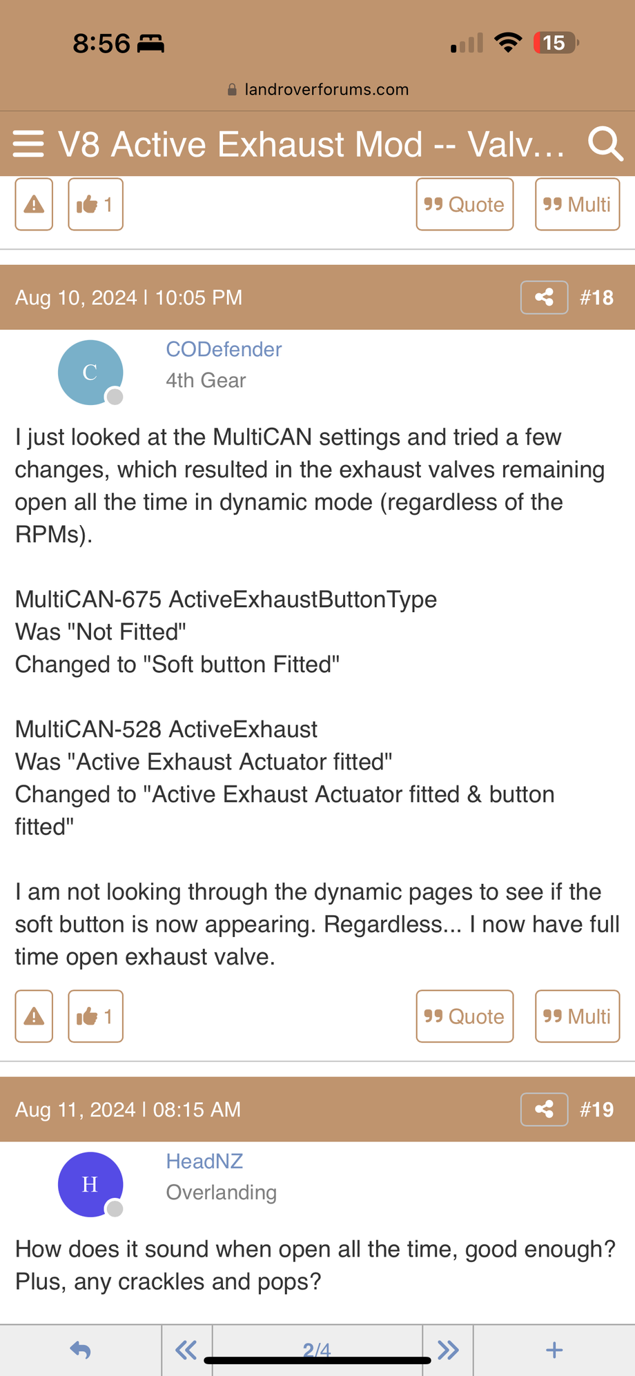

I have a V8 on order. Are there any gap tool adjustments for the exhaust when in dynamic mode? I thought I saw something about a setting to keep exhaust valves open in dynamic mode 100% of the time vs above a certain RPM. I just can't find it searching.

I believe this is what you are looking for; however, personally, I disconnected the valves to try it out, and found it really just provided a little more drone under 2k RPMs that I didn’t like… others like it though

Yes - this is what I saw but could not find. Thanks!
