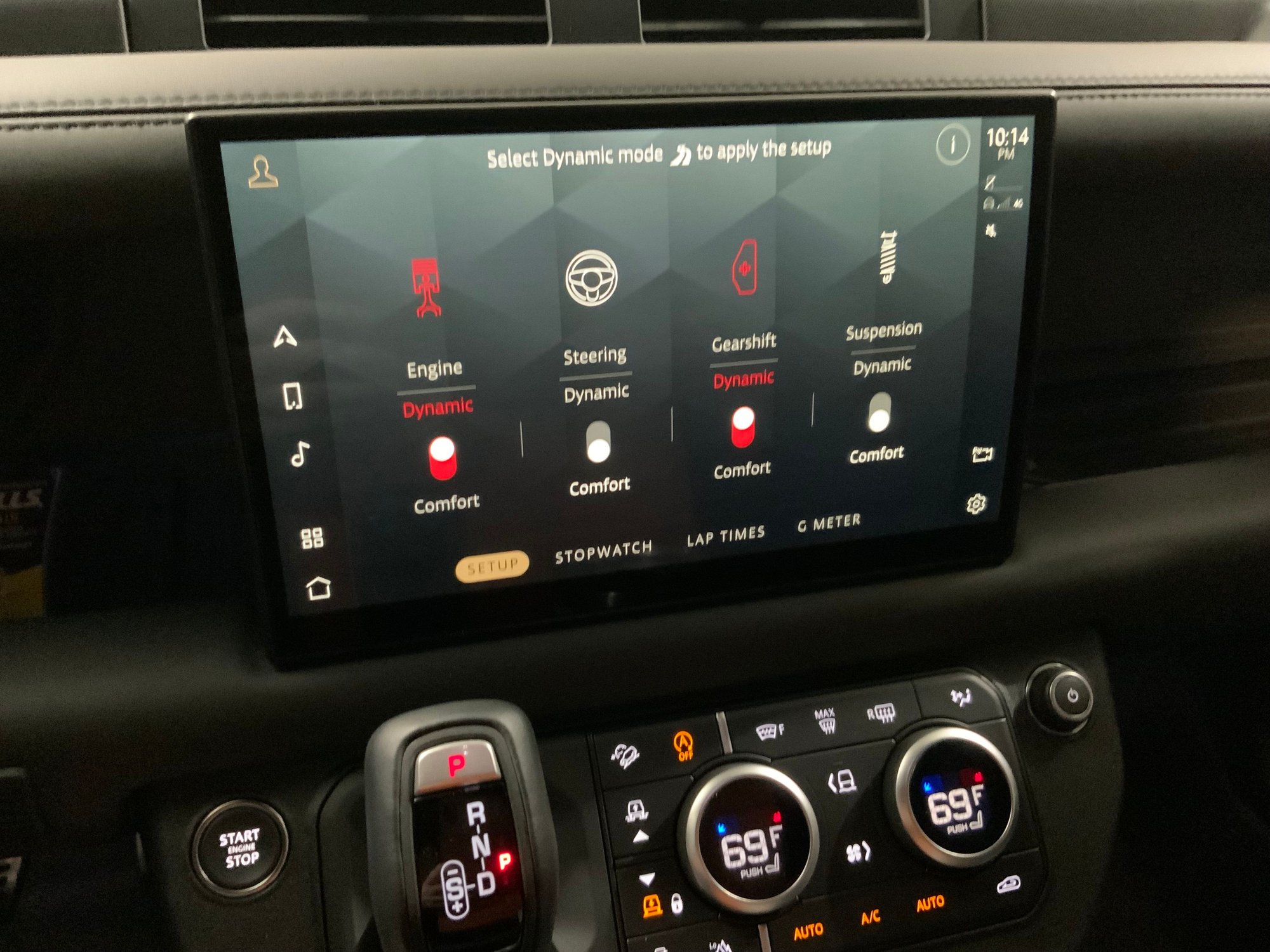

You can enable configurable dynamic mode, and basically turn all the dynamic mode functions off except for the exhaust.
I have my exhaust valves programmed to stay open in dynamic mode, and have my suspension and steering set to comfort.
Yesterday I shut off all the dynamic features except the exhaust, seems to drive pretty much the same as when in normal mode, only more exhaust sounds.
Where this would not work would be if in any of the off-road modes or eco mode.
But I am normally in dynamic or normal/comfort mode. I think I am now satisfied with the use of these now enabled features.
