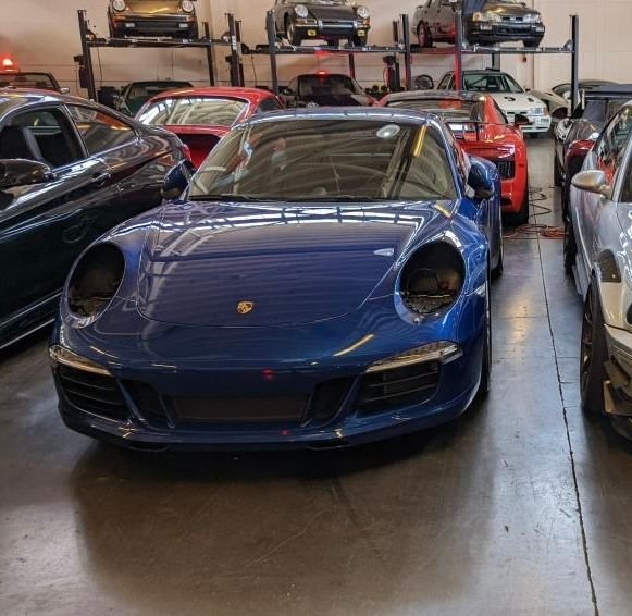

@AVLDefender interesting. Good sleuthing. This is pretty competitive for what it is on Porsche 911's (the 991, 2012 to present, and the 981's). I just paid $900 to have my 911's headlamp lenses replaced from a company called Rennlights. The replacements from Porsche are similarly insane (I think $3400 per side) and Porsche is not covering them under CPO warranty or goodwill post warranty (991's ended in 2019 so they're basically all out of warranty). In that case it's a lens issue, not a circuit board. But the process is the same. I'll email the guy there to see if he wants to start doing Defenders...
BTW rather annoying on a 22k mile all garaged Porsche... just like this on our Land Rovers where mileage or severity of usage condition doesn't seem to have an impact.
I have a feeling the custom headlight companies are not yet dialed into the opportunity the Defender presents. They are likely the best option for a reasonable fix. Keep us posted on what Rennlights can offer, I would certainly be curious.
While I sympathize with the Porsche issue, I find some solace in knowing we are not alone. 😜
What an absolutely stunning vehicle BTW (even without headlights)! Is that your garage!?
