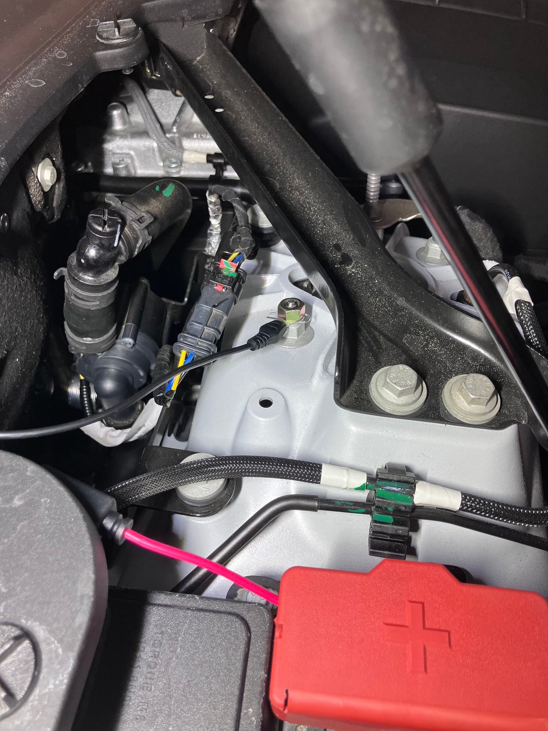

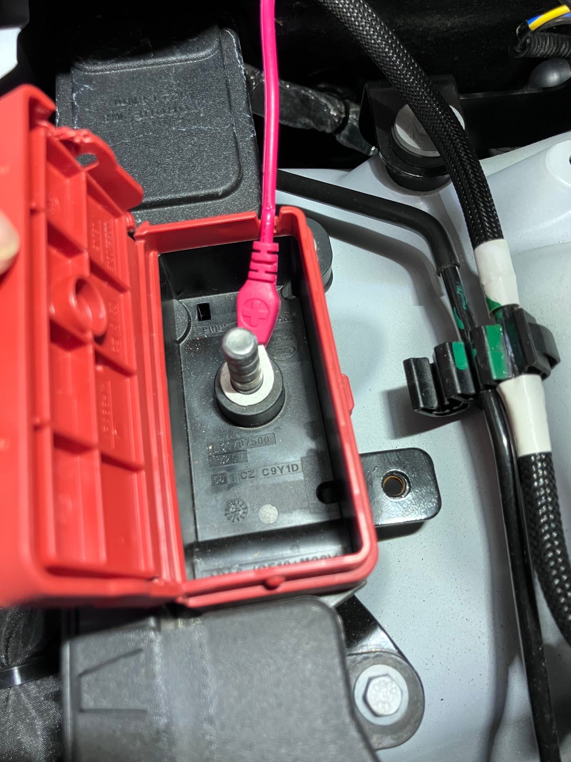

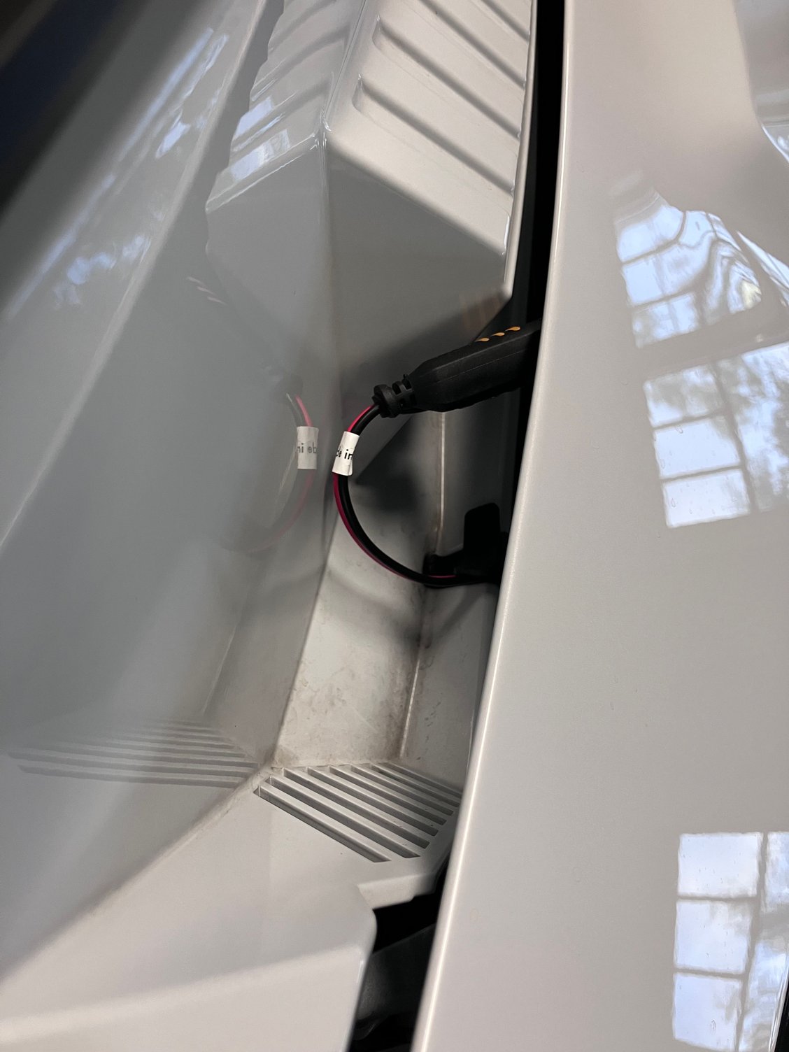

My redneck solution - used Ctek comfort connect, negative eye on random bolt at top of shock tower with nut to secure; positive eye fits tight on jump post just by itself, cut a notch in the red box so the top closed properly. Wire runs under the black rubber "T" shaped plug in the front cowl. No need to open hood to attach charger.

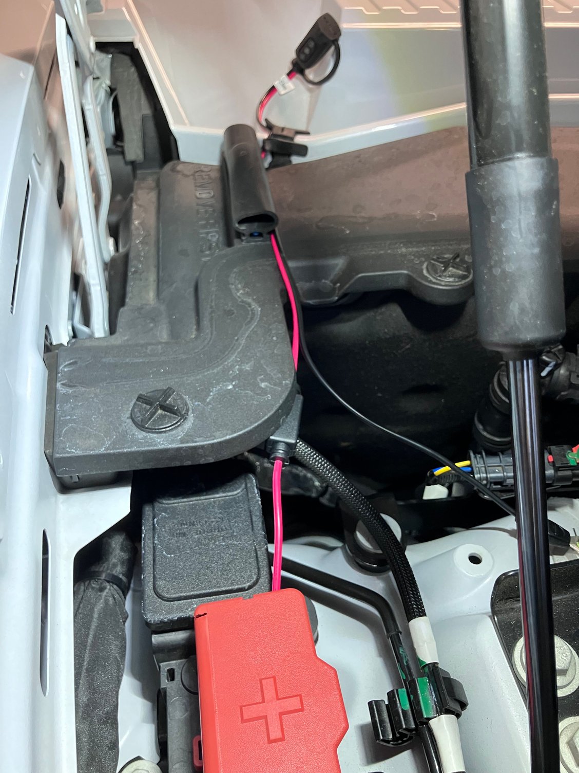

@Norsk tapped the most convenient point but it may not be secure enough for some because it's difficult to thread anything onto it. If you back up a bit there is a black plastic cover that you can tap into. You can see it clearly on this Link. You will likely have to trade out a larger O-connector but that's an easy switch (recommend the heat shrink type). One MAJOR caution. Disconnect your battery before playing with this and make sure you have an in-line fuse because it will be able to draw a LOT. My winch is connected into the empty location on the left of the image. Also if you go to the left, you can get your own fuse, likely much lower than the 450-Mega that's in the pic.
EDIT: On second thought, the right mega fuse may not be there. Check, but this is a prime access point either way - provide your own fuse and all the normal obvious disclaimers.

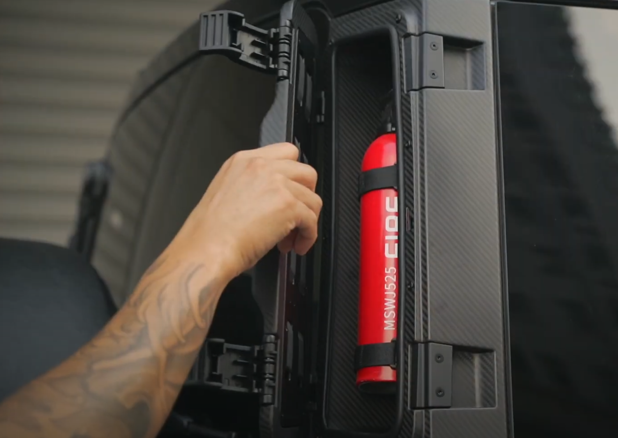

I'm going to say "probably". I'll check it next weekend and send a pick. Here's a pic of the "original" plumb version with a 525 Firebeater fire extinguisher. At ~9 1/2 height x 2 1/2" diameter it is roughly the same as a liter Nalgene at ~8 1/4 x 3 1/2". Ymmv. That fire extinguisher has something mounting it and the nalgene is fatter. Ping PowerfulUk for interior dimensions or I'll take a measure in a couple weeks.
Definitely fits most 750ml liquor bottles. May just have to rethink your hydration choices.
