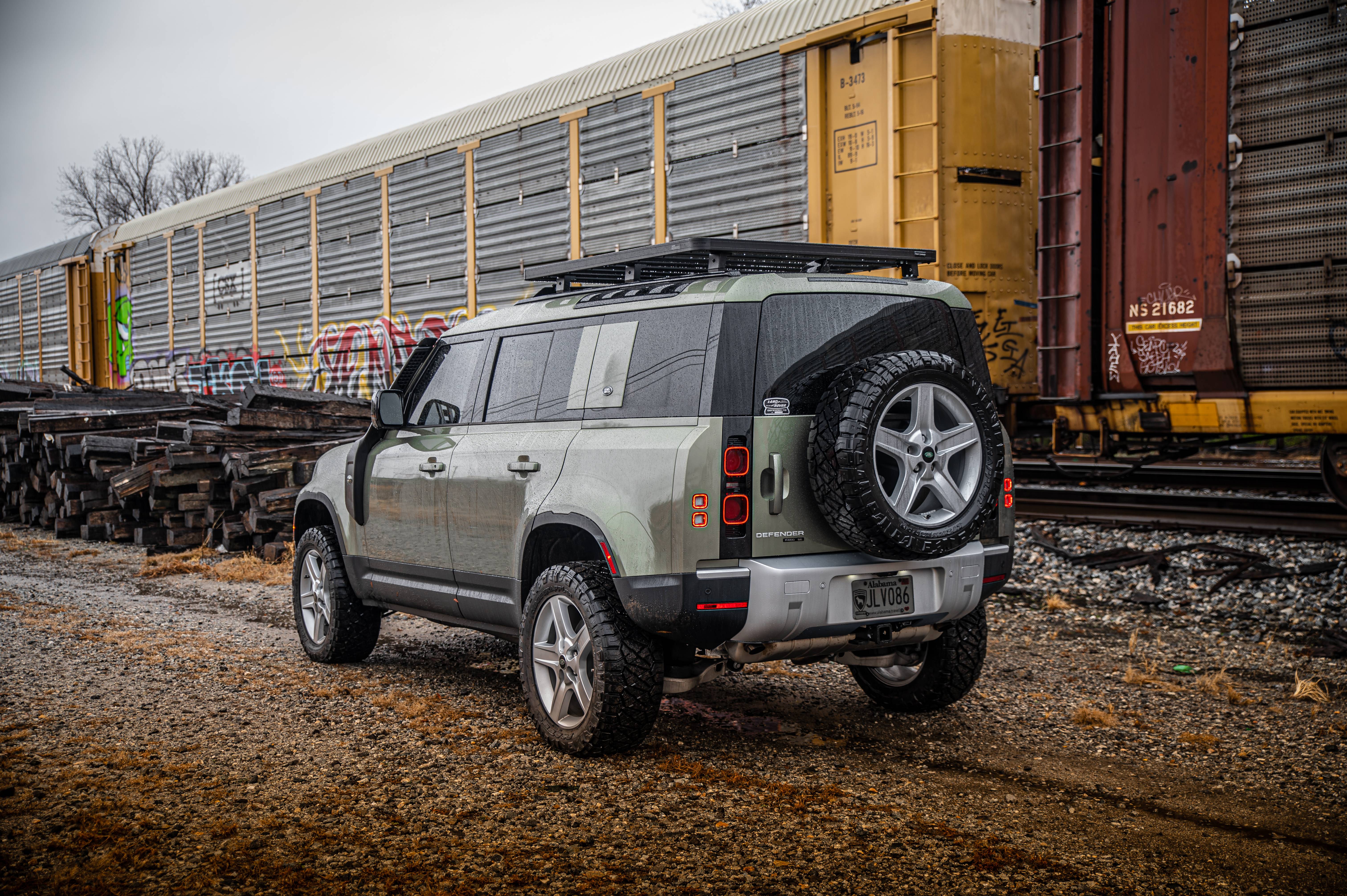

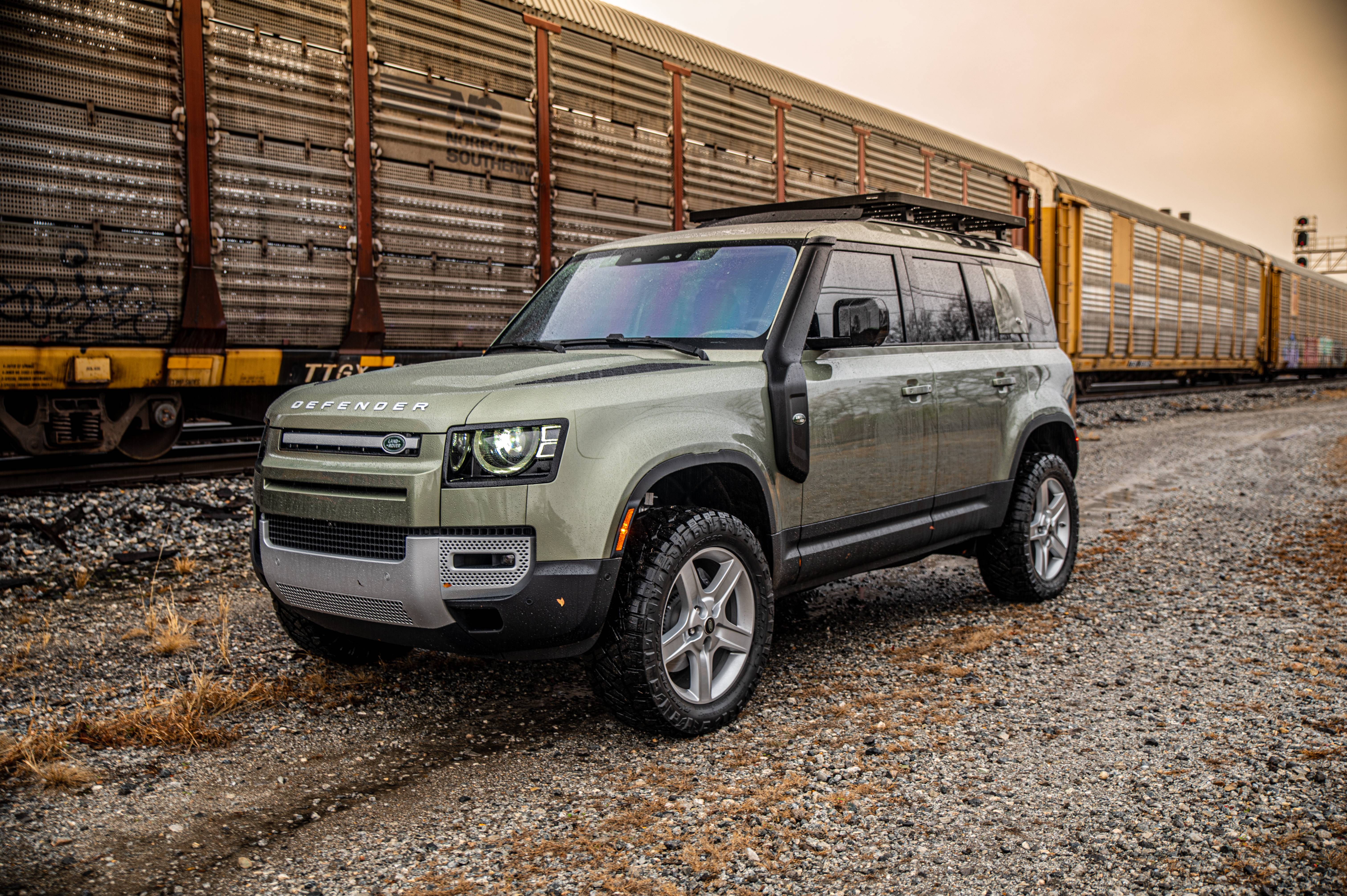

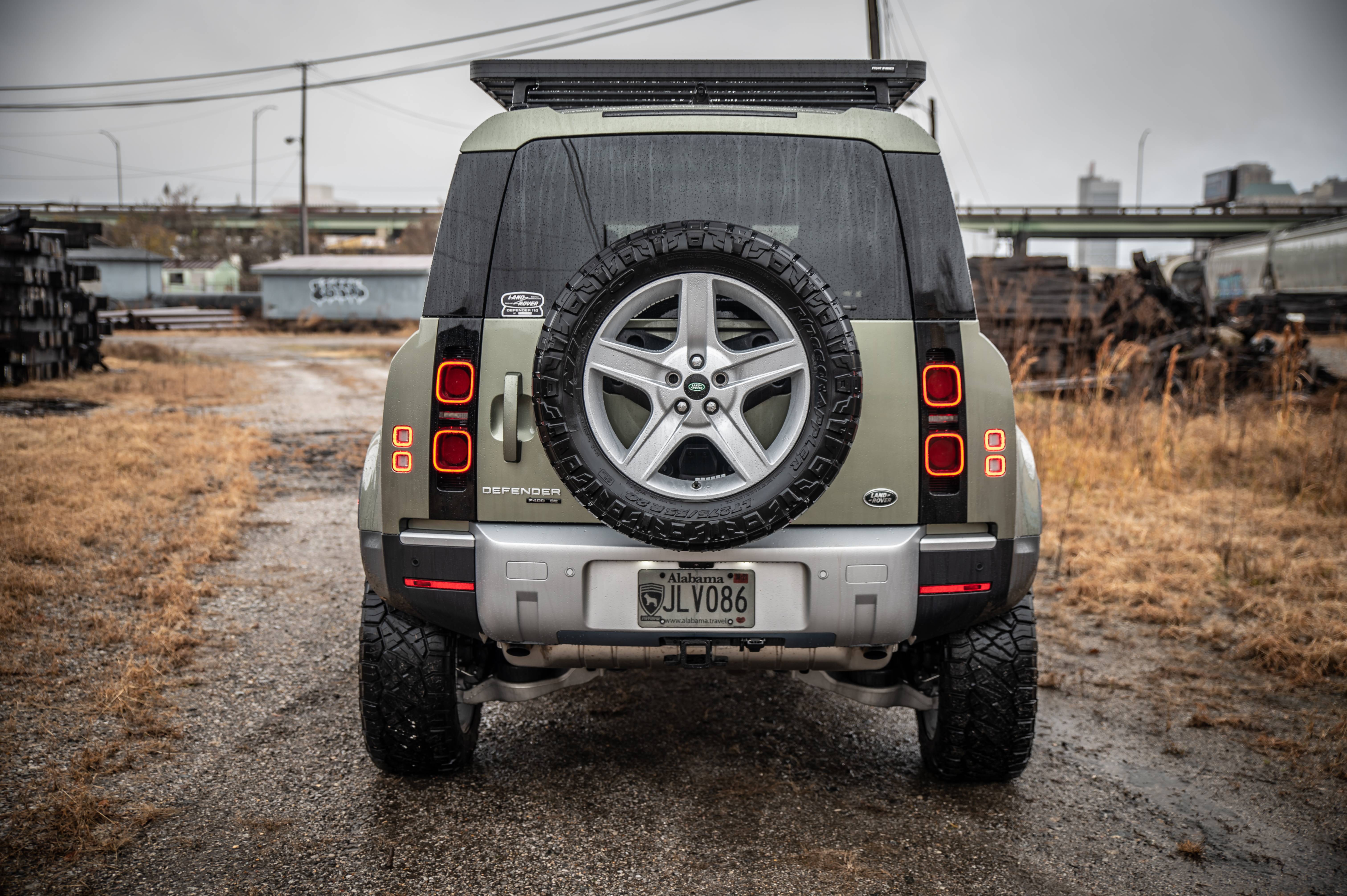

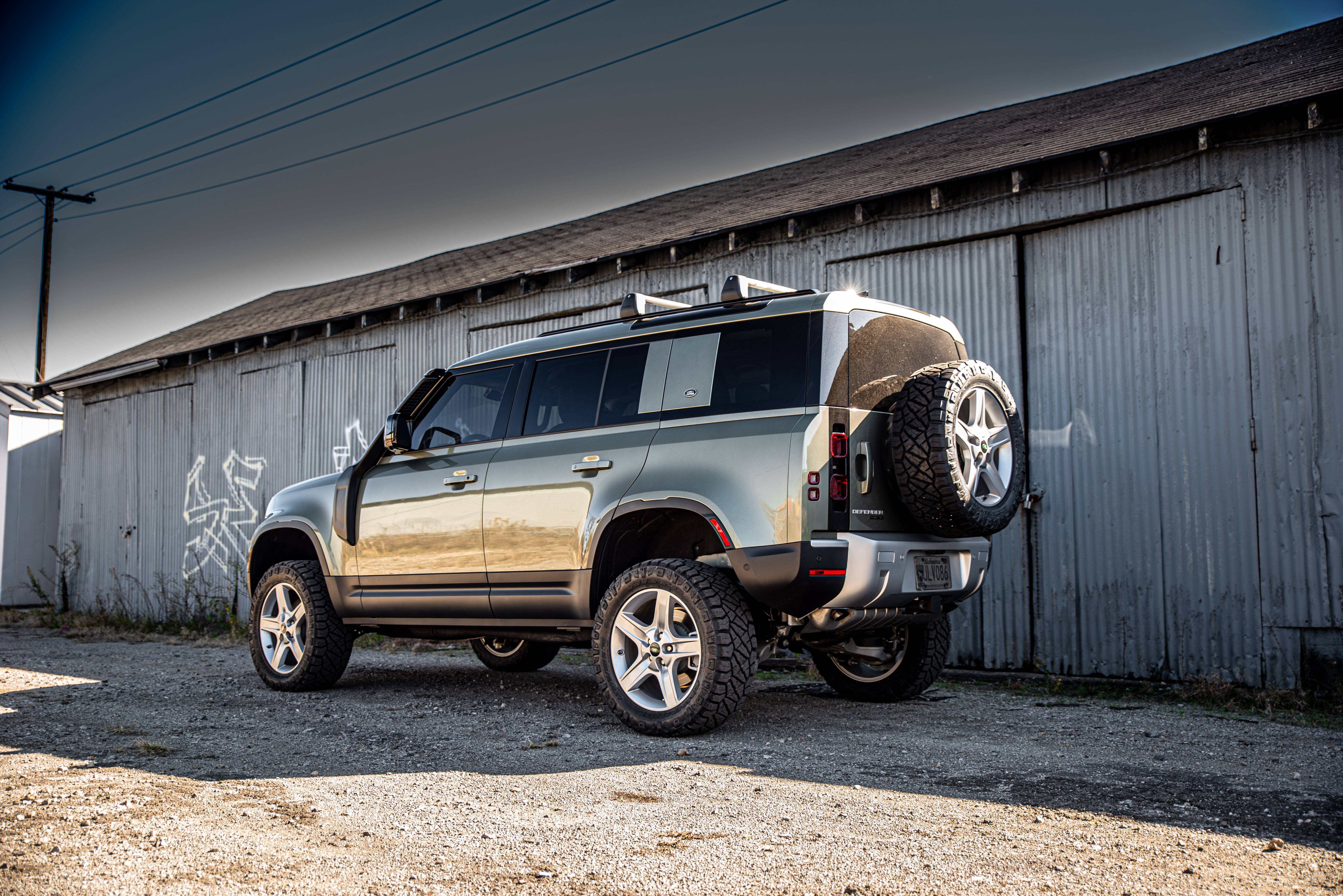

Originally Posted by JesseRohr
Next phases:
The wheel is a 20x8.5 with 41.5mm offset. With the spacers the wheel is pushed out 30mm creating a 20x8.5 with 11.5mm offset.
H&R makes a set of 25mm spacers as well that would work. 20x8.5 with 16.5mm offset would be that functional setup.
25mm set - Part number 50757257 (you need two)
30mm set - Part number 60757257 (you need two)
30mm wheel spacers and new BFG K02 Tires:
Windows tinted 15%:
Attachment 55205
Attachment 55206
Nitto Ridge Grapplers swapped in instead of the BFG after three were warrantied for out of spec shape. Also JLR factory Raised Air Intake and Cross Bars installed:
Attachment 55207
Proud Rhino 1.0 lift arms installed:
Attachment 55208
Attachment 55209
FrontRunner Slimline 2 rack (For OEM Rails) installed:
Attachment 55210
Attachment 55211
Attachment 55212
Attachment 55213
Attachment 55214
