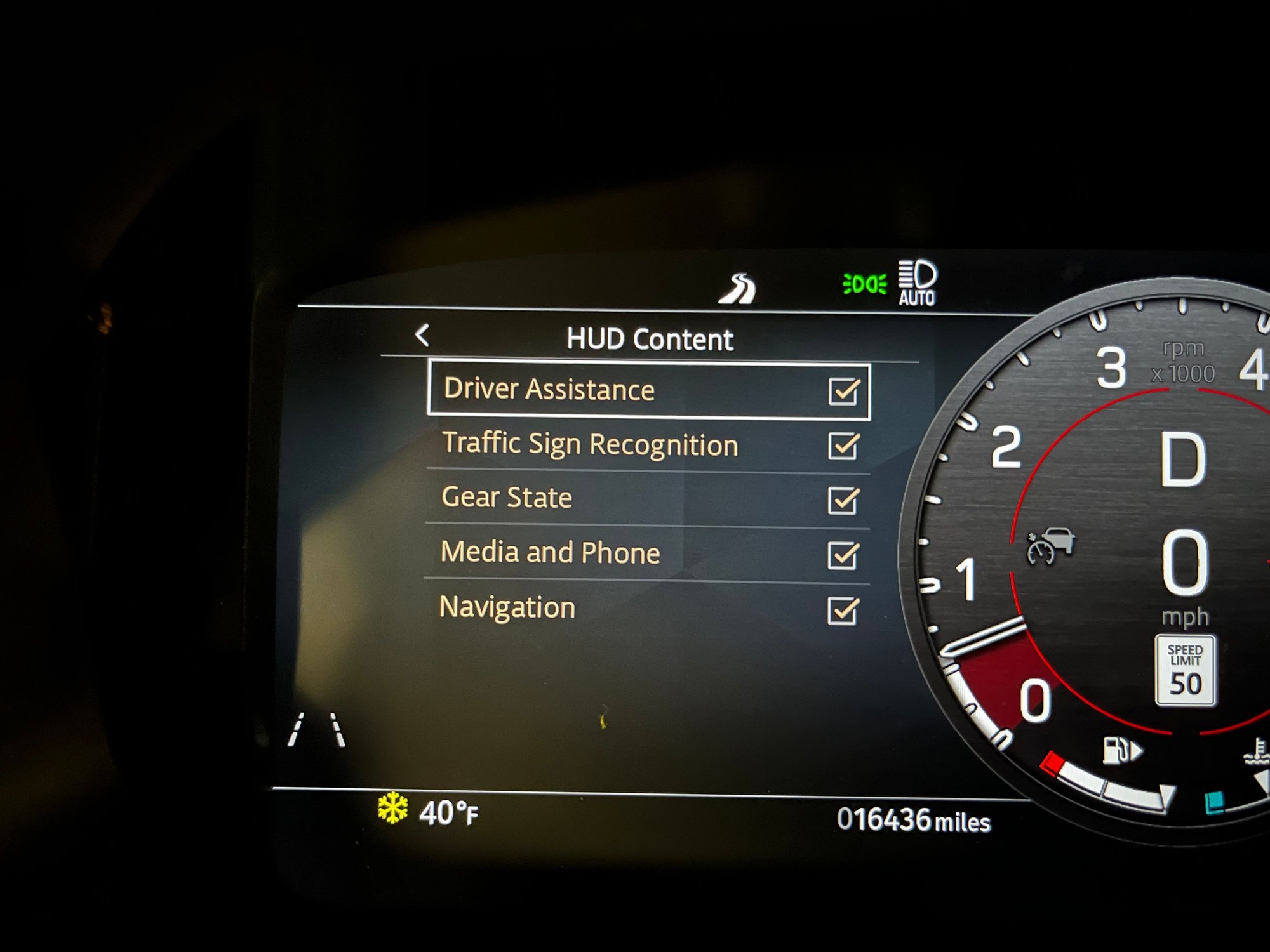

1. My HUD does not show navigation directions/commands if I have either the destination set in Pivi Pro's default Navigation app or Apple Car Play. I would find this very useful as sometimes at night I turn off the Pivi Pro screen entirely as to not disturb the wife while driving. Is anyone else with a HUD having this issue? I have even played around with disabling all the other HUD Content as maybe if there is a limited amount of space available in the HUD.

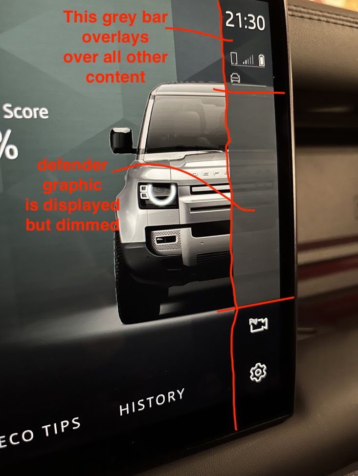

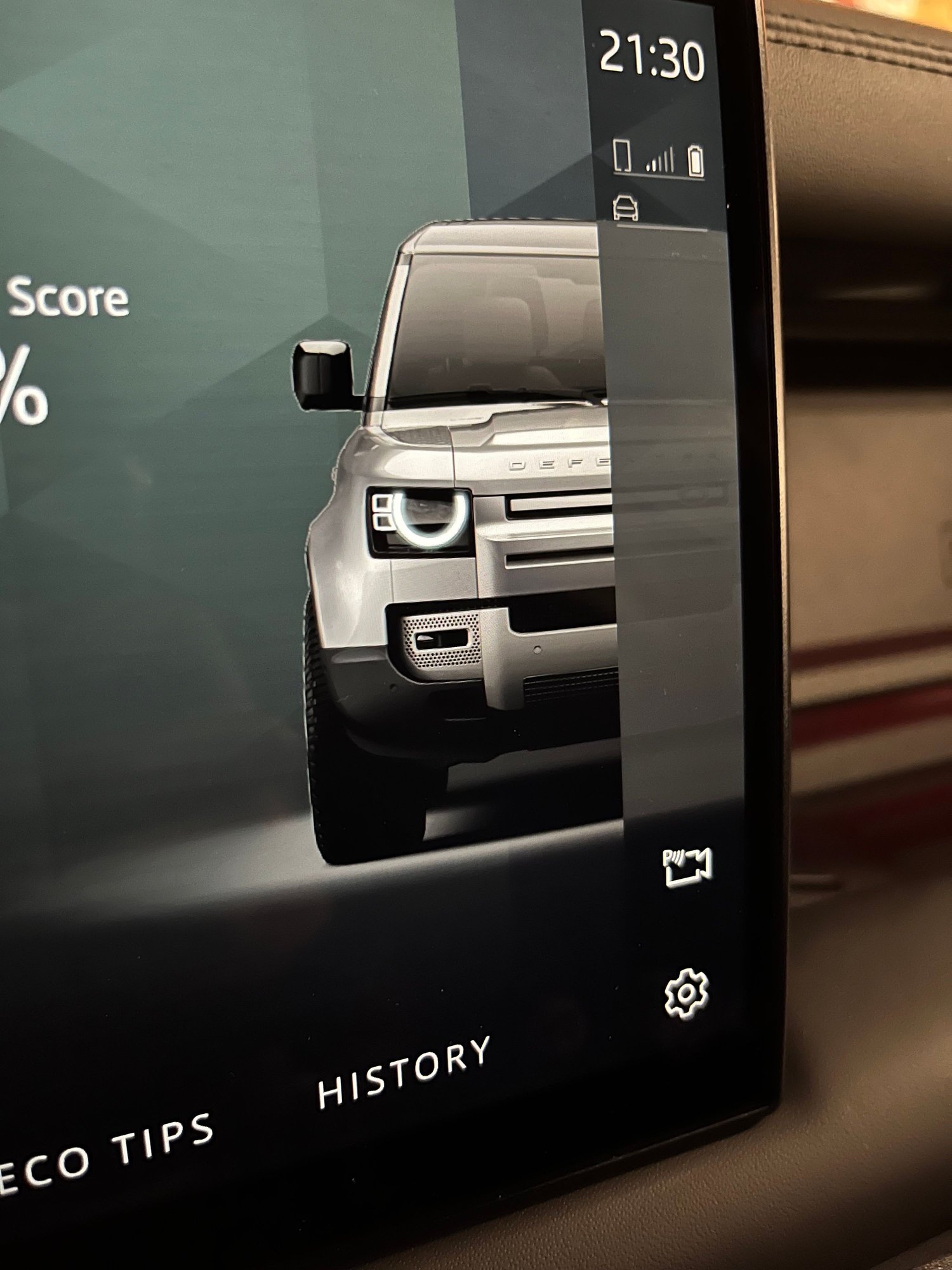

2. In the Eco Data screen (1st tab) the image of the Defender appears to be half image/half grey bar. Can anyone confirm if they are have this same issue?
Screenshots attached below. I know very nit picky but just curious, maybe these can be updated with a software patch? Thanks!

To the best of my knowledge I've NEVER been able to get Apple Car Play Mapping data to display in the HUD. I'll wager that's intentional by L.R. I DO SEE the native L.R. / Pivi Pro navigation appear both in the CENTER of my Dash and in HUD when the navigation prompts are running. I generally have voice ON so that might be worth checking to see if it affects things. I'd also check the layout pattern being displayed on the dash - perhaps that's related. I typically have the CENTRE of my digital dash show fuel data (miles to empty, etc), and that center display is replaced with mapping direction data prompts when active. E.G. does changing your digital dash display (presuming you have that and not analog) change the behavior of displaying navigation data in the HUD. I too have EVERY function for HUD ENABLED - found it interesting when driving off road.
2. Half Image Half grey bar for Defender graphic
I believe that's intentional and varies with the screen/data being displayed. Note - on your screen shot - there is data being displayed at the top of the grey bar that is overlaid ON TOP of the Defender graphic. I believe that's the nuance you're seeing

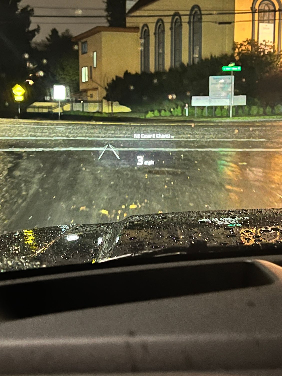

YES! I can confirm that my heads up display no longer shows turn-by-turn arrows, when I have a destination set in the pivi nav. I don't think it ever showed them when using apple's nav via CarPlay.
Now the HUD just shows me the name of a road when I need to make a turn, instead of an arrow. I am 10000% sure it used to show me a turn arrow, etc.
Here's what I now see (crappy pic below). It used to have an arrow. Which I liked because I could just keep looking out the windshield.
I played with all the settings last night driving and couldn't get them to reappear.
