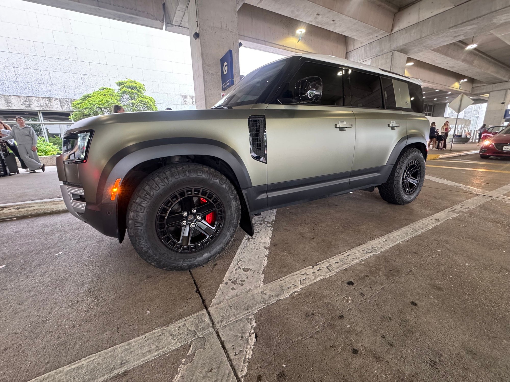

275 / 60 R20. Goodyear Duratrac's
Goodyear Duratrac 275/5R20
- No Spacer, Index Finger Space Between Inside Tire and Upper Arm, No Rub on OEM Mud Flaps

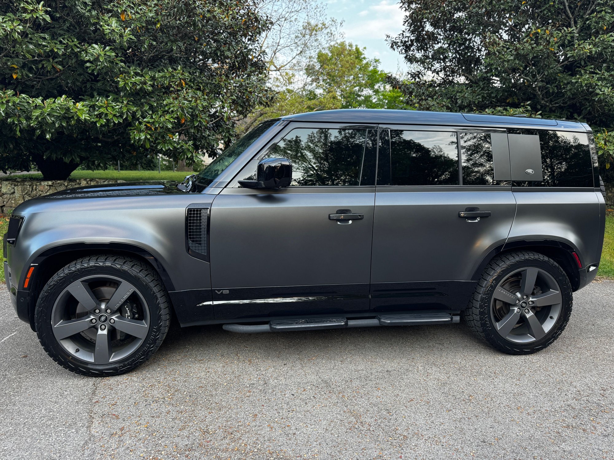

I can make a strong recommendation for the new Nitto Terra Grappler G3s. I have 2023 Defender 110 V8 and I LOVE these tires. No rubbing. 285/45R22. They are super quiet (as quiet or better than the stock Conti street tires), ride better than the Contis and look awesome. Have a buddy who put them on his G-Wagon and has the same rave reviews.
2023 Defender 110 V8 on Nitto Terra Grappler G3 285/45R22
