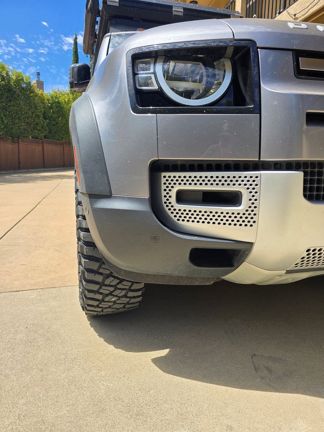

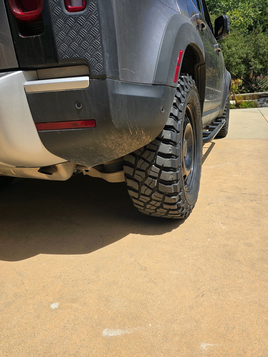

Default 275/65 R18 success with BFG KM3s
After 50k miles, my General Grabber X3s are toast. Worn out and chunked up from many miles offroad. I tried to get the same tires as I have been happy with then, but General is no longer making them.
I went with 275/65 r18 BFG KM3s on stock steelies on my P300. I was happy with the KM2s on my P38 Range Rover and wore those down to nothing. So far, they seem to clear on access mode butnI haven't tested them on full articulation yet. A bit of rub at full stuff, I can live with.
I'm headed to the Continental Divide Trail next month for a week of trails where they will be tested.
