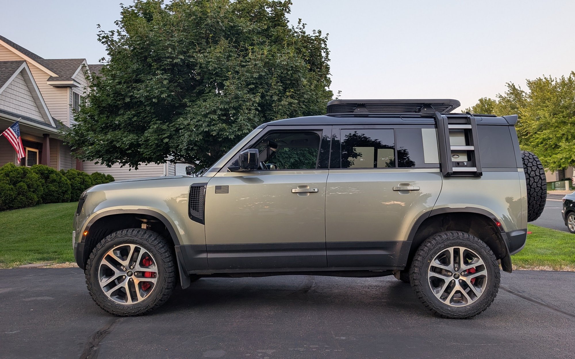

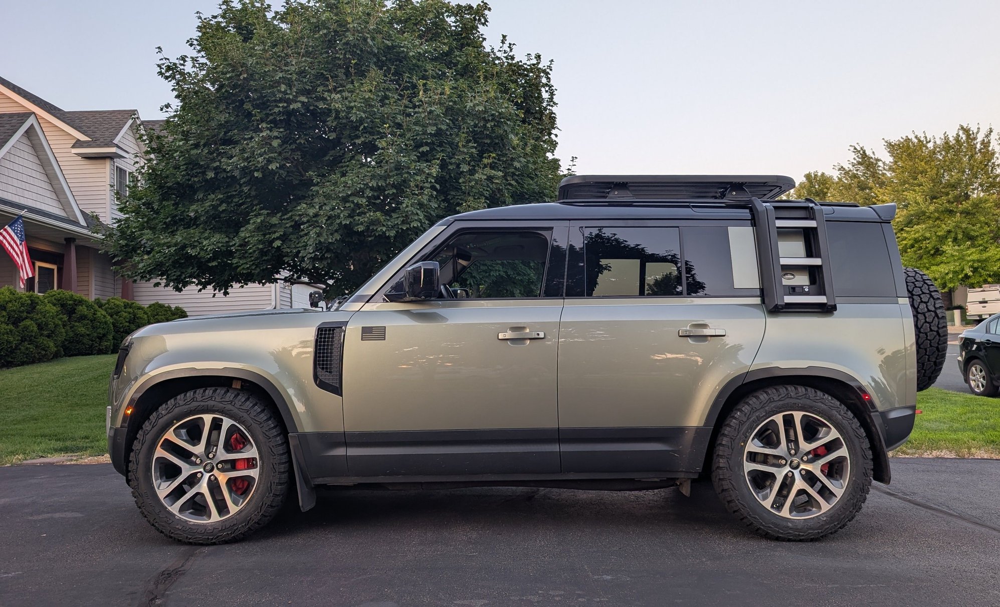

I put new KO3s size 275/55r20 on my 2022 Defender P400 110 with stock rims, and then promptly put 120 miles on them driving from Denver to Breck and back (including some light trails while I was there). Initial impressions:
- No rubbing anywhere - even at full articulation.
- Rides better than the stock Goodyear Adventures. Bigger jolts are more muted, but sharper impacts like expansion joints are maybe a little more pronounced. I'll probably play around with inflation a little to see if it makes any difference (currently at 35 psi frt, and 40 psi rear).
- Definitely handles better. Steering is a little heavier, and seems to track better with less wandering on the freeway.
- MPG took a hit. Hard to tell how much until I fill up a few times, but at least 2 or 3 mpg. These tires are almost 20 lbs heavier than the Goodyears and I can definitely feel it during acceleration and when going uphill. They also seem to decelerate a lot more quickly when I let off the gas.
- They look pretty good. I'll post pics soon.

Here's a pic from this last weekend.
