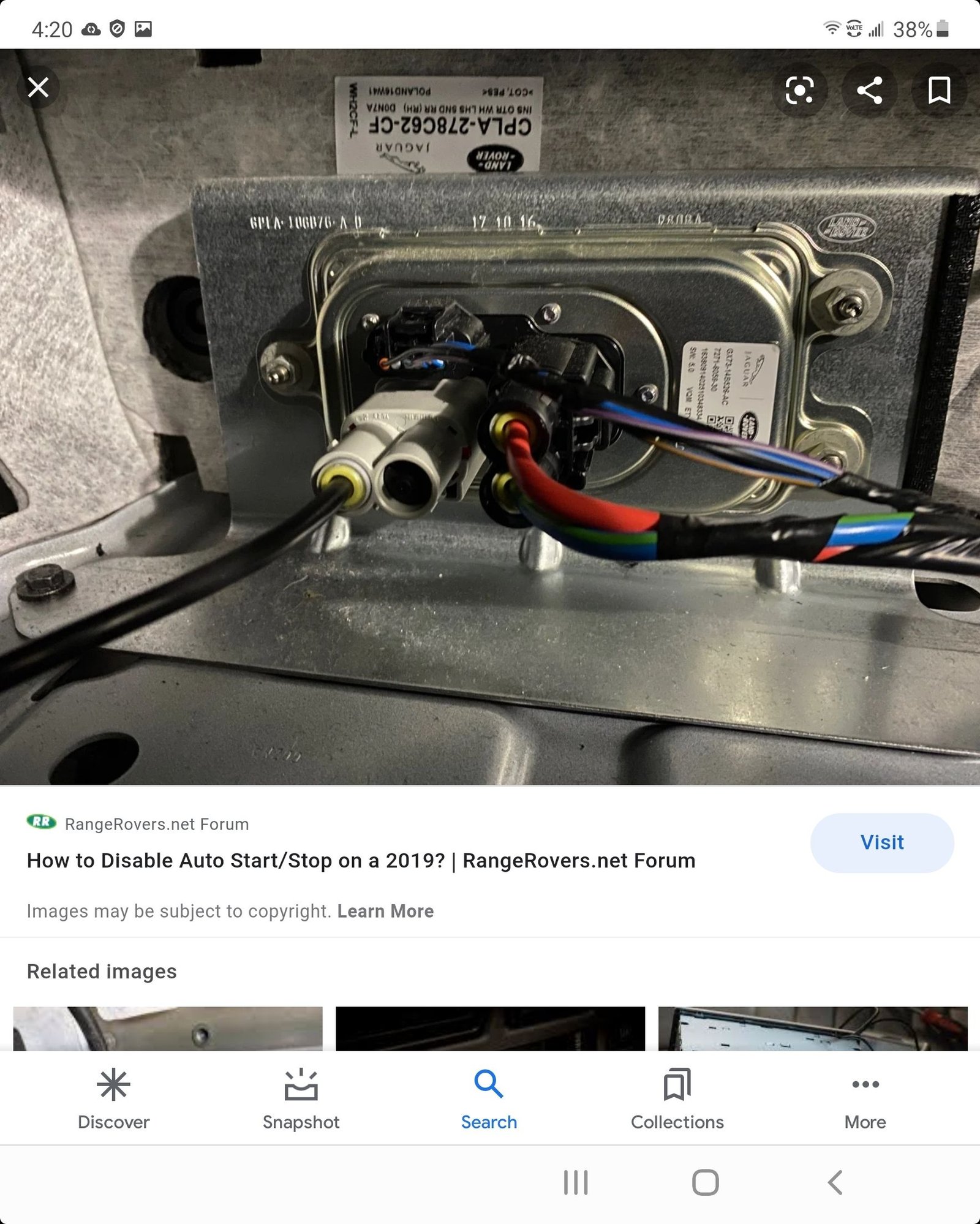

I spent 5 hours last weekend tearing out my jump seats, spare tool kit. Every single back panel except the driver side D rear pillar and I think it's in there. I cant find the capacitor anywhere. T
opinion shows around the drivers side trunk but I couldn't find it.

I know that the LR4 and Discovery had a separate stop-start battery you could disconnect or just not replace once it died. However, I read somewhere that the mild hybrid battery on the P400 supports the stop-start system. P300 owners may have a chance of finding a separate battery.
I just hope my stop-start system never wakes up. I was concerned a recent software update could change that but it continues to not work at all. Glad I waited to order a 2021 to get this non-functioning feature.

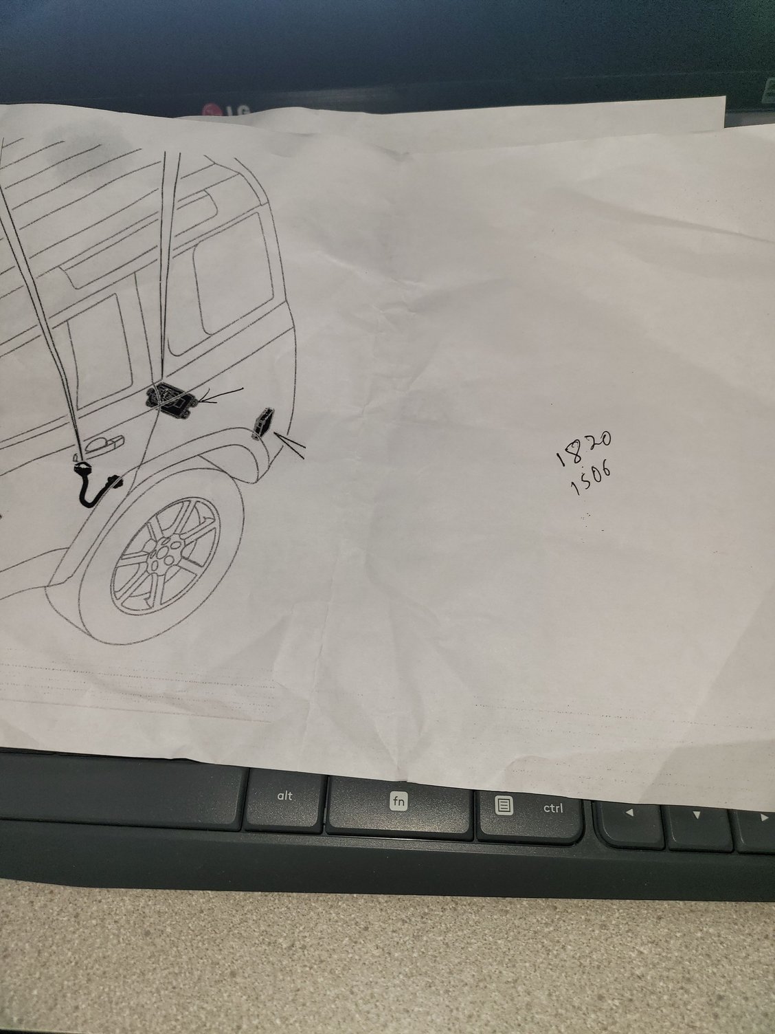

Here’s the diagram. I think it’s behind the drivers side tail light....
