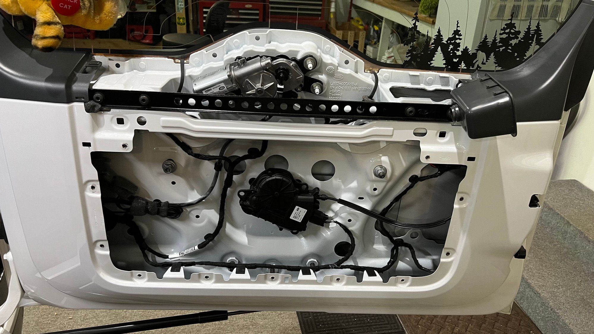

... Simon hammers out 2 screw studs in the tailgate. Has anyone else successfully done this?
I've tried a 2.5lb hammer, a 2x4 with a metal plate screwed into it, and a heat gun. Nothing seems to loosen it.

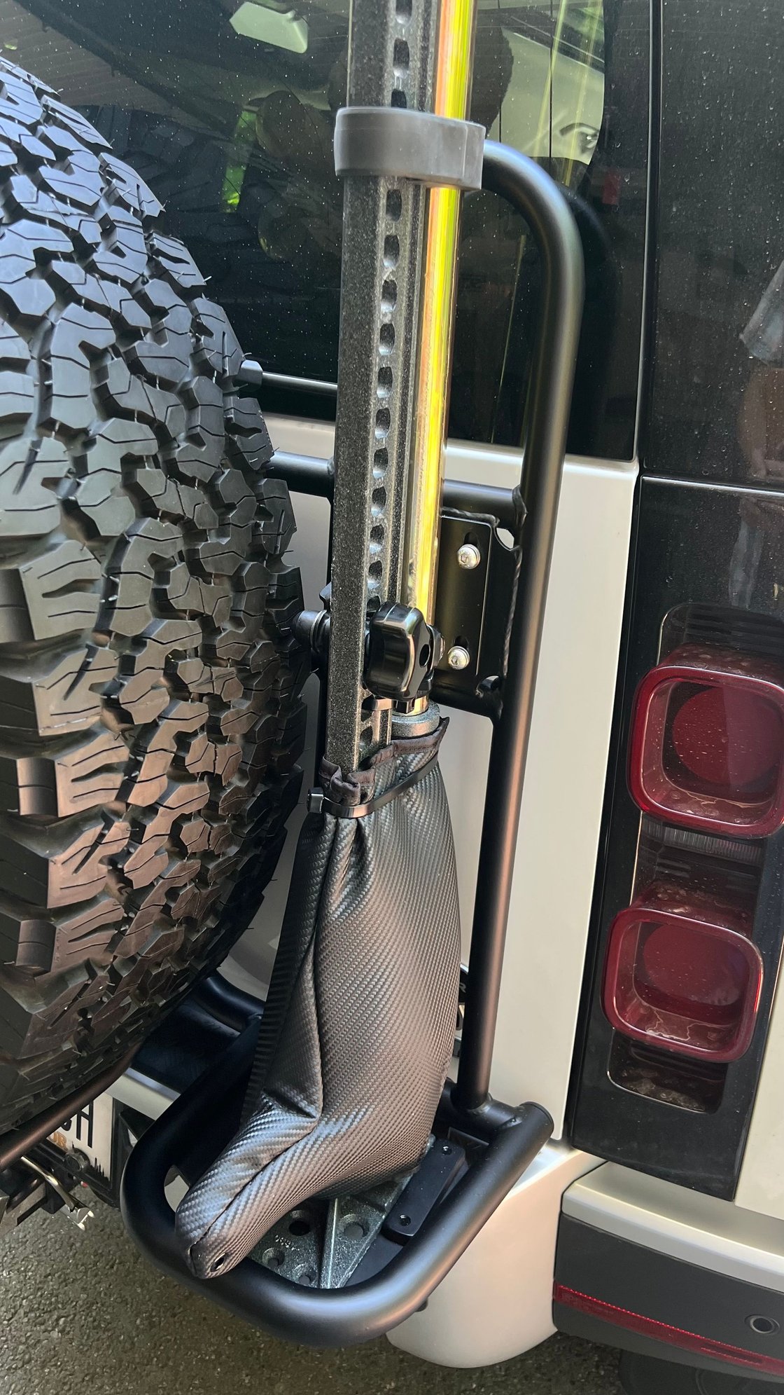

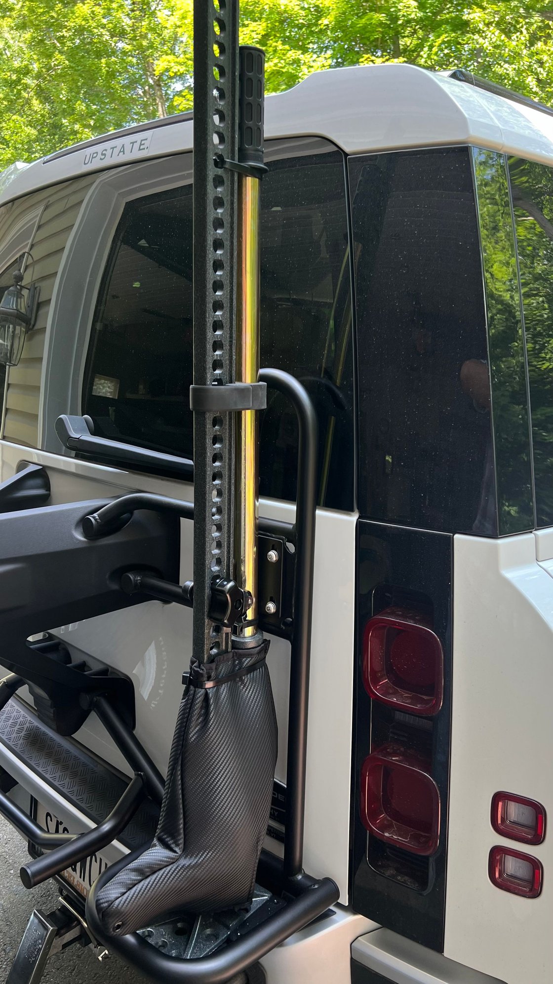

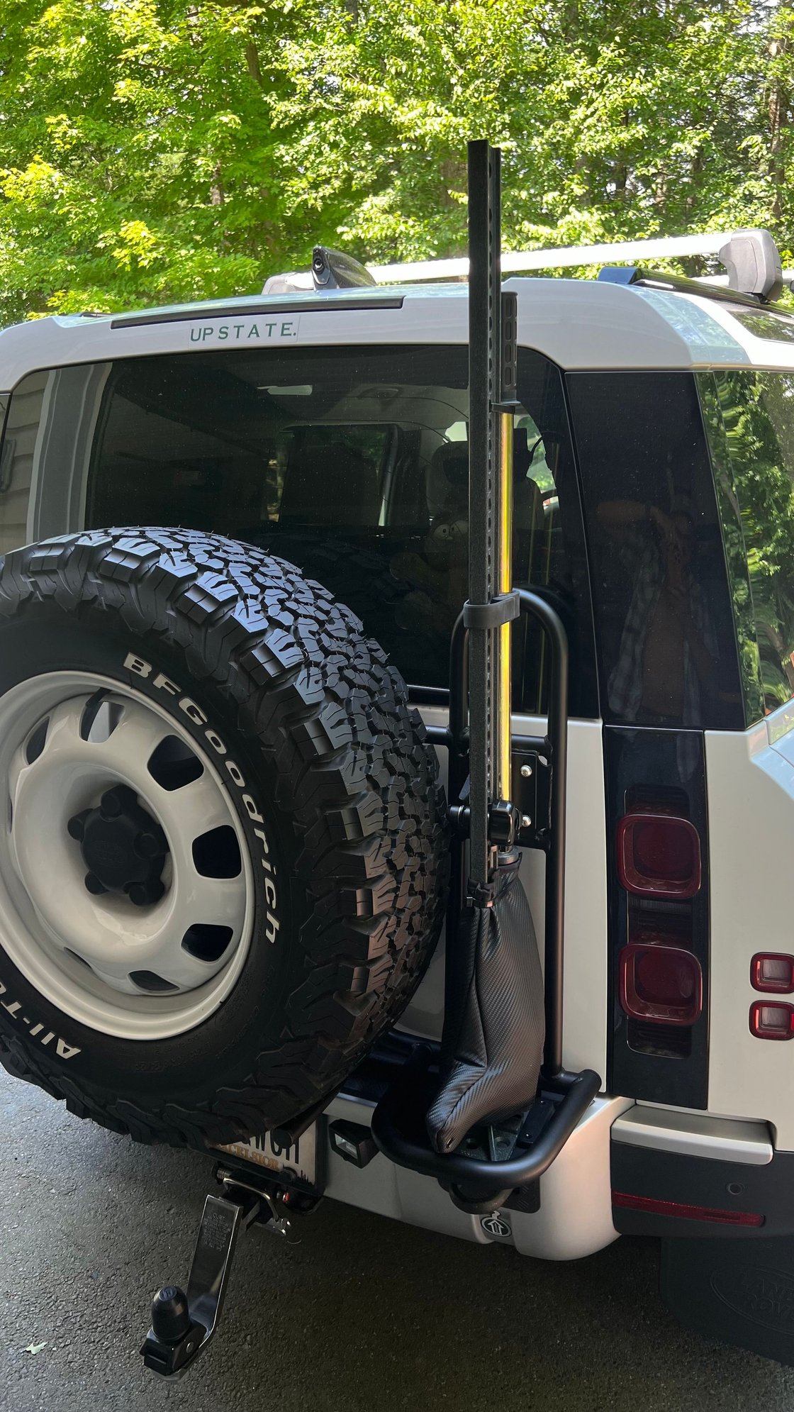

I recently installed the hi-lift jack carrier. I used a dead blow hammer and a 2x4 (like you) and had to pound the living hell out of it to get the stud out...but it did come out. I think using the dead blow hammer made the difference...I started with a 3lb sledge hammer with the 2x4 with no luck. I was a little timid on hitting it at first but after a while I really started waling on it with the dead blow. I did loosen the nut and made it flush with the stud to have more surface area to strike and protect the threads just incase I put it back to factory.

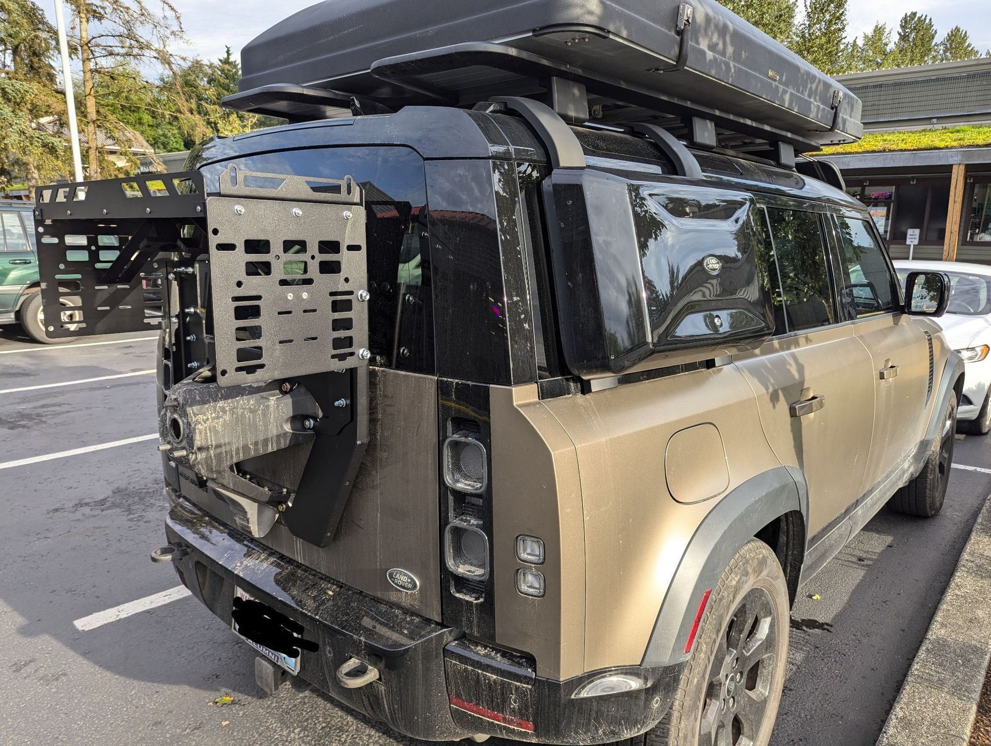

Love the hi-lift jack carrier. I ended up going with @Saltek Motorsports's tailgate molle rack instead.
I finally was able to knock the studs out:
  1. Screw the nuts to the end of the studs so they're flush with stud tip
  2. Use a 2-4lb hammer
  3. Wear ear protection (seriously)
  4. tap slightly hard for probably about 10 minutes straight each
Interestingly, the constant tapping at ~half strength worked WAY better than trying to smash the hell out of the studs.

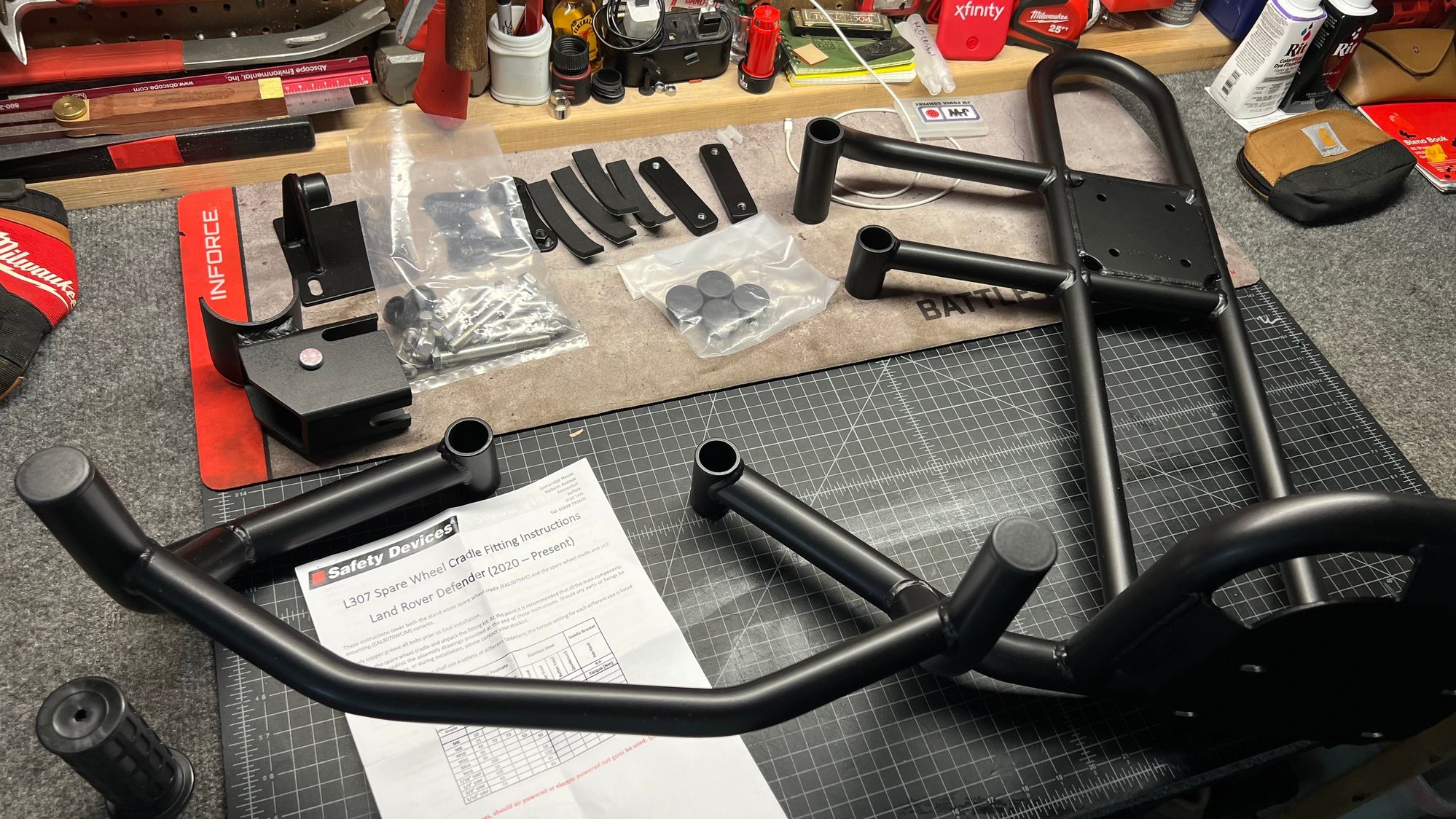

Well, I almost fell in love with it. In fact, I'll probably be a customer anyway because I love the wheel cradle. As a guy who's removed that rear tire WAY too many times alone, I could definitely go with it as an "aid". But at about 26:50 he had the great idea of turning it into a ladder. Then I had the thought: why don't I just find a way to put a base on the bottom of my Lucky8 Rhino ladder?? I think I'll explore that option first. And, it seems the Hi-lift bracket for a Yakima basket would fit the Lucky8/Rhino ladder just right! Bueno, now to order the cradle.

There are extra mounting points on the base of the Saltek Tailgate Rack that @Saltek Motorsports has mentioned will be a hosting point for future accessories. I'm hoping one option will include a wheel cradle. Because you're right... when you're changing the wheel by yourself, holy smokes do you want that additional support!
