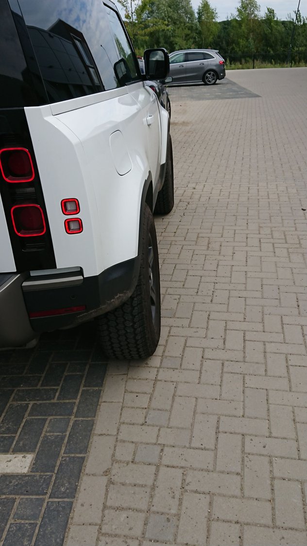

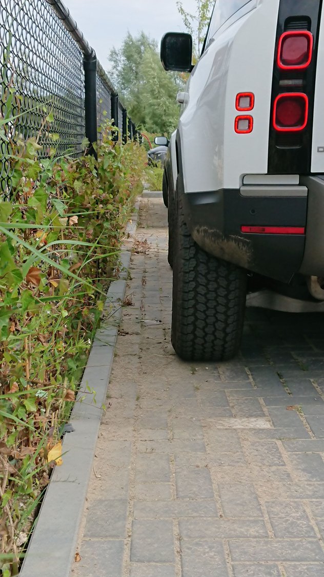

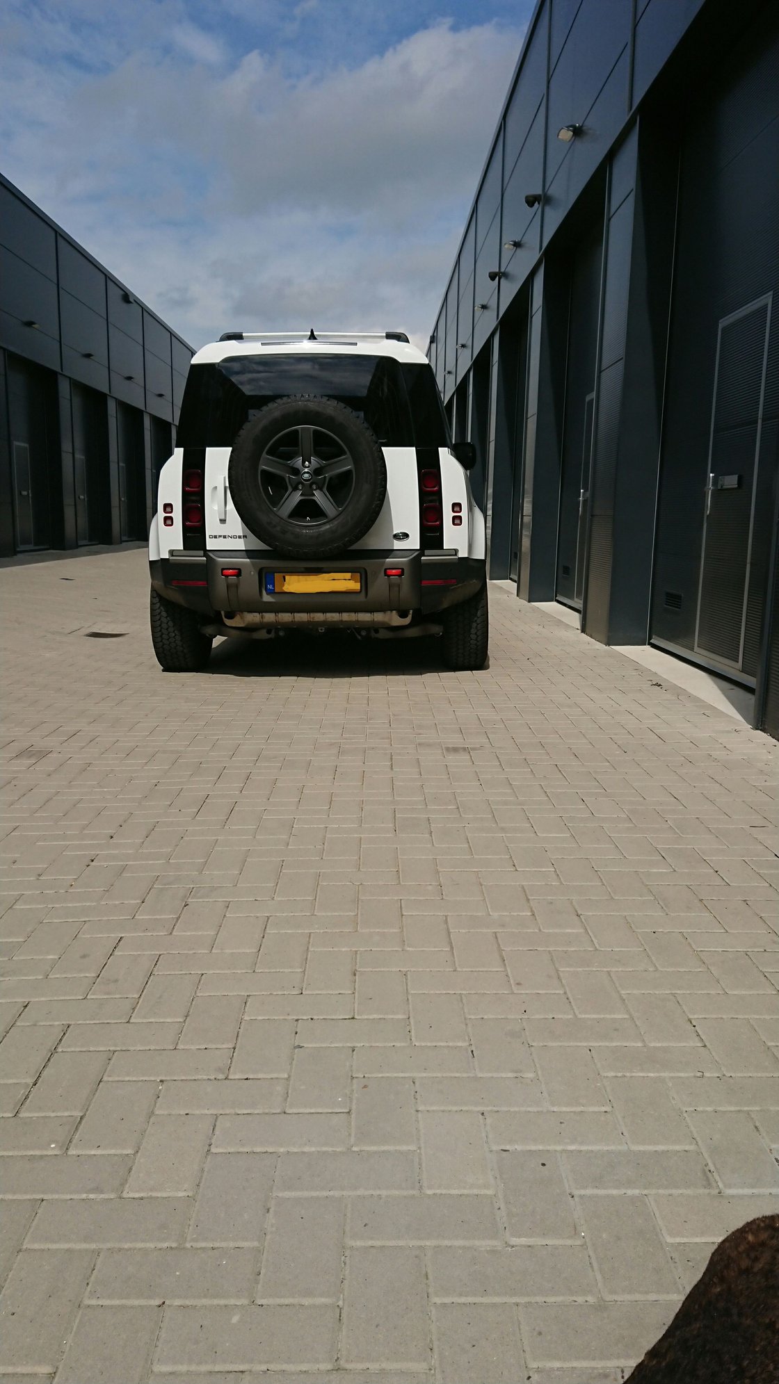

Put on the spacers 22.mm front, 25mm rear.
Stance clearly improved, handling & cornering also improved.
Looks factory ( as it should have been from the factory)
looks great.. anymore pics??
