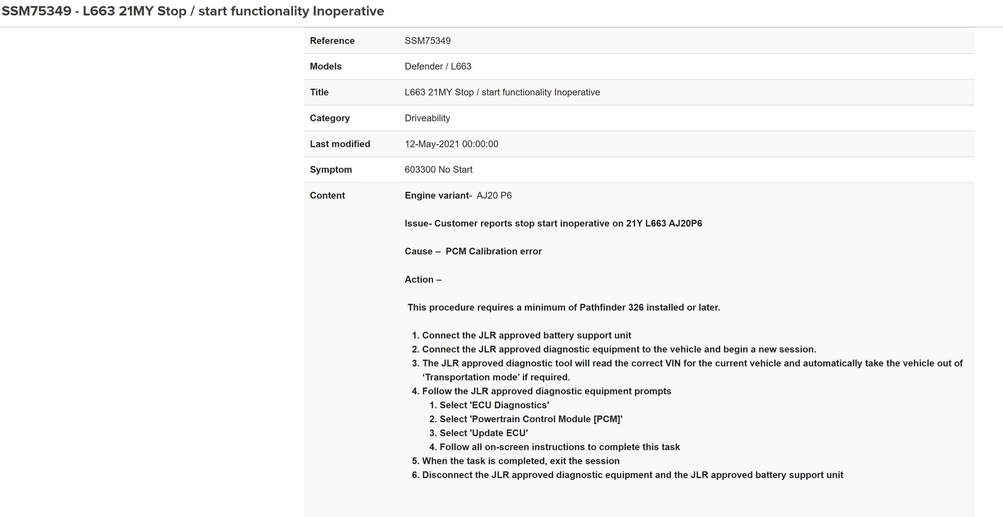

It's definitely NOT a battery problem. Their ServiceTech is just checking off their gut feel rather than running thru the Workshop Manual's protocols. If they would have run thru their service bulletin it would have clearly outlined what others have had to go thru:
(CAVEAT: Just for clarification - you have Auto Stop/Start but it won't restart when you press the gas. This is normal for it to turn off and then you just press the gas to go. If pressing the gas does nothing, then this is the Service Bulletin for you)

Yes, to clarify, when this has happened, pressing the gas does nothing. We have to restart the engine, it just seems to have died all of a sudden, and angry drivers toot behind as we often end up missing the green light in the process . Usually the stop/start function works fine but then when we least suspect engine has just died and nothing moves.
