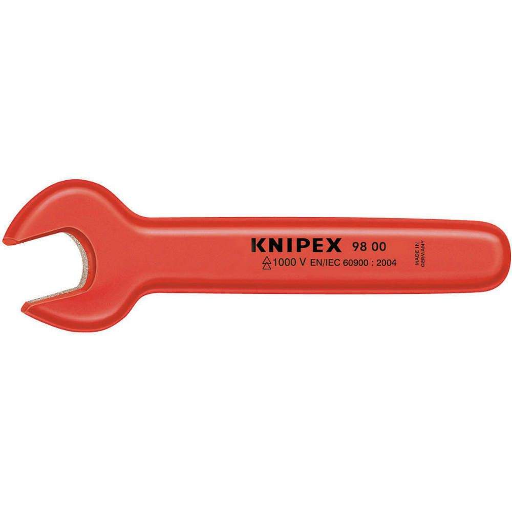

Yep, great advice from @PaulLR . I keep a 10mm knipex duck taped in my battery well. Haven't needed it for that problem (yet), but it is handy to kill the battery power. Any 10mm will do, but I grabbed a version of this on ebay.

It finally happened again to me this morning. I actually drove it 3 miles to my office being very careful. I now have 2200 miles on it since it happened first time at 600. Thank God it didn’t happen in the mountains over the weekend skiing with a bunch of kids as we got back late last night. Now I’m trying the 10mm wrench battery disconnect idea as the locking and walking away option didn’t work this time.
Hopefully I have metric tools, I normally only work on a 66 Mustang. Ugh…

Sure enough the 10mm wrench and disconnection of the battery for 10 seconds worked.
Note that the battery in the new Defenders is in the same place as the old ones; under the front passenger seat there is an access panel. Move the seat all the way forward and from the back seat foot pan area lift up the clipped access panel. This allows access to the battery terminal to simply unscrew lightly and disconnect and reconnect.
Next move is the dealership to see if there’s further data to help prevent this, but note-to-self to keep the metric tools in the truck for future conundrums!
